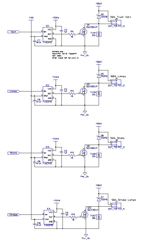

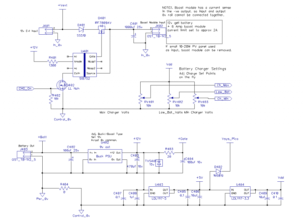

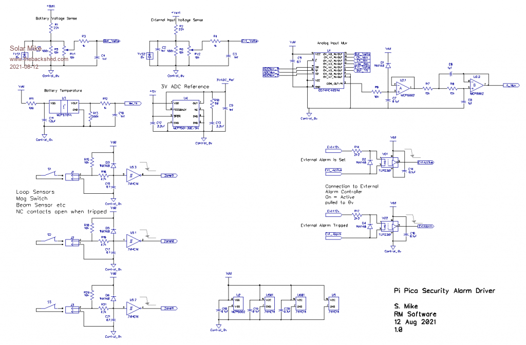

I'm extending our security system to include a remote alarm driver that can be linked to the existing system or used as a stand alone alarm unit.
Some of the noise makers used to wake the dead are sirens and large truck horns; these draw upwards of 30 odd amps off a localized 12v battery, the existing system wont really handle this unless I used heavy duty relays; so I thought an upgrade is in order.
The truck horns driver will melt if run too long, so have to be switched on\off to limit heat build up. Some of the LED lamps will be flashed at a suitable confusing 10 - 13 Hz rate; thus requiring high power mosfet switches.
Included is a simple PWM battery charger to keep the 12 volt LA. battery topped up.
Will use a Pi Pico cpu module (u-Python) to run the system. Here is progress to date:

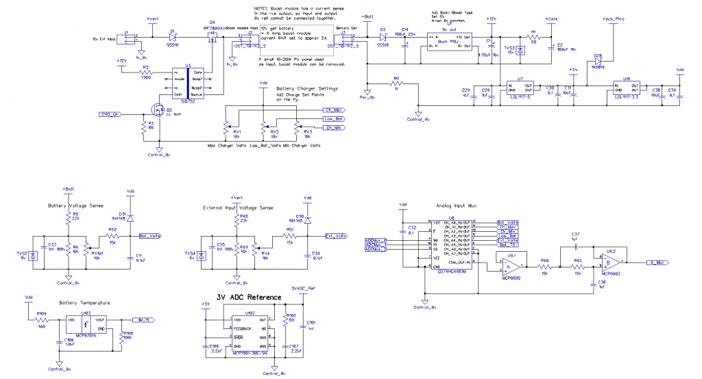

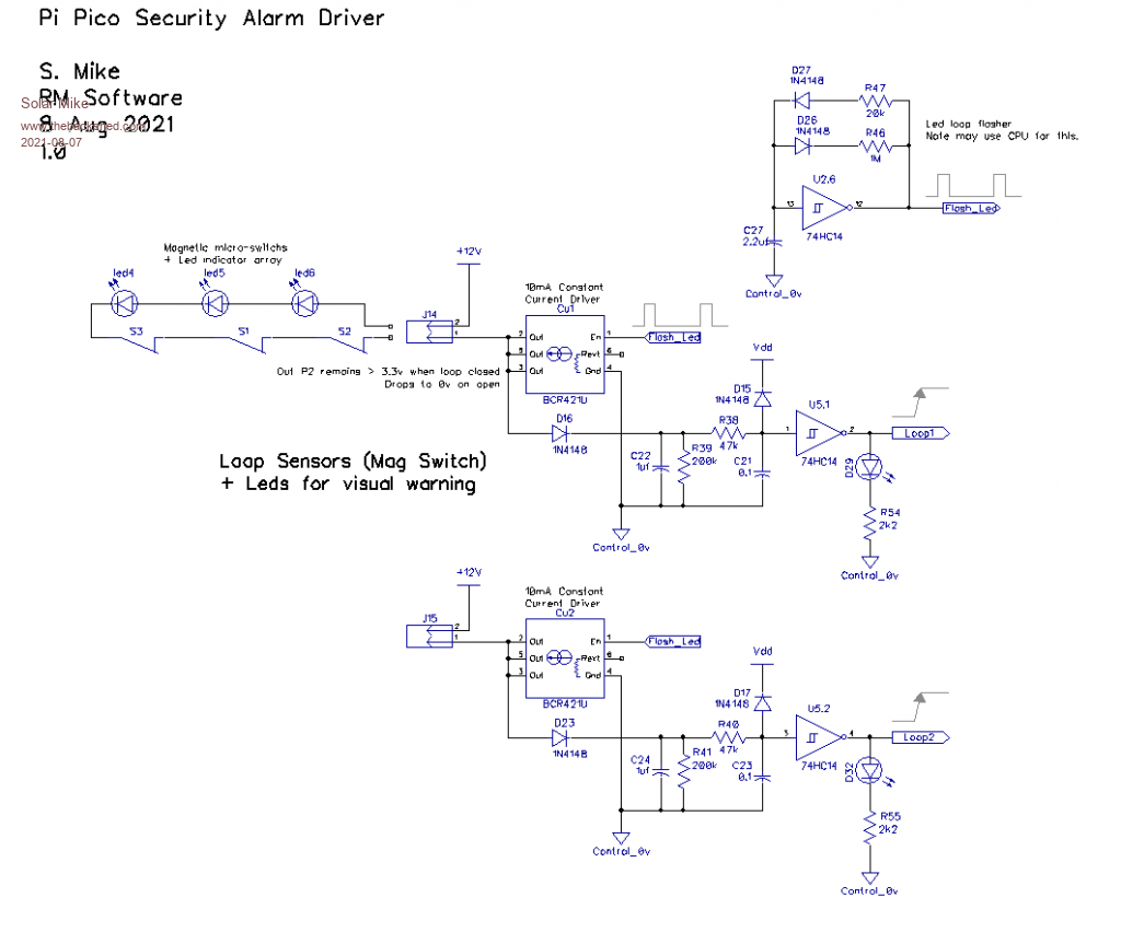

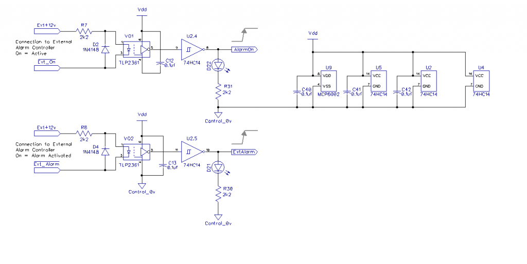

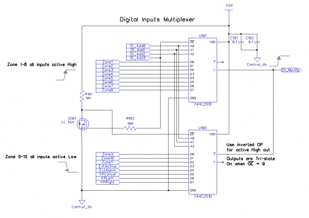

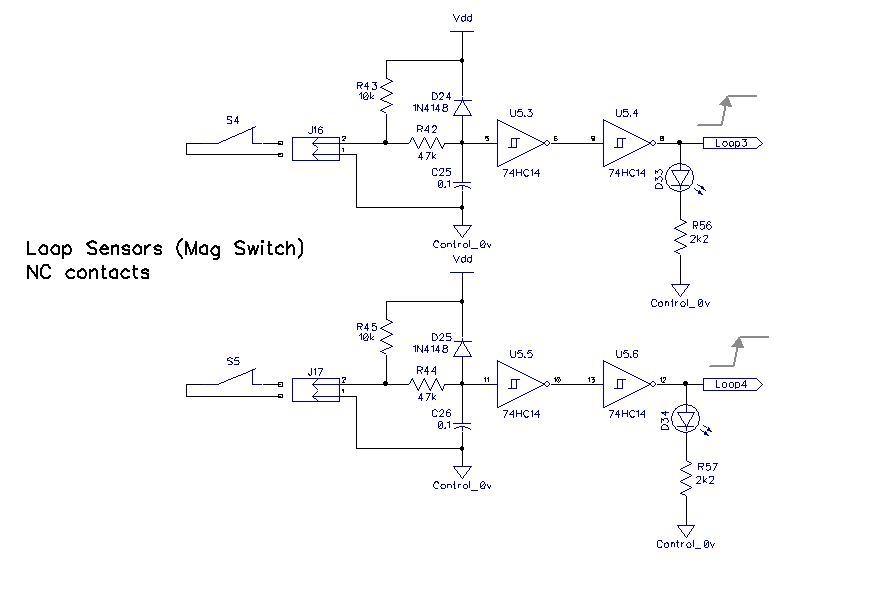

Have made some changes in the design, decided to use both digital (74HC251D) and analog multiplexers (CD74HC4051) to connect the cpu to various zone sensors and alarm outputs.
Semi static relay and Led outputs are connected via High power serial shift registers, type NPIC6C596A-Q100.
Schematic below:
I will also use some of design ideas in the Pico H-Bridge driver module, then get on and do both PCB's; I do like the PI Pico, its an interesting cpu to play with, I just hope they bring out a revision to fix the broken interrupts and threading.
Mike

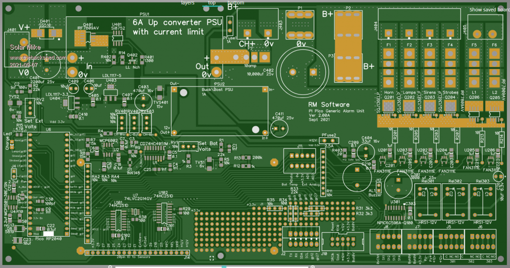

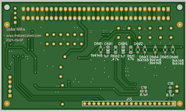

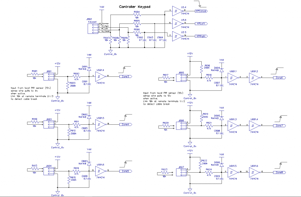

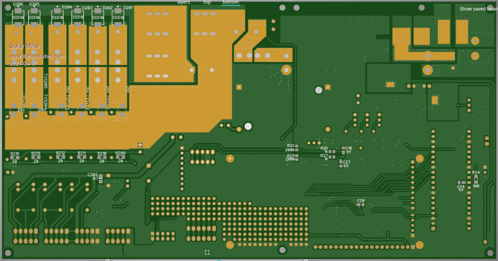

Posted: 04:09am 07 Sep 2021
Sticking with the PICO 2040 module, good excuse to update my very rusty C coding to use the second CPU if I want to use threading.

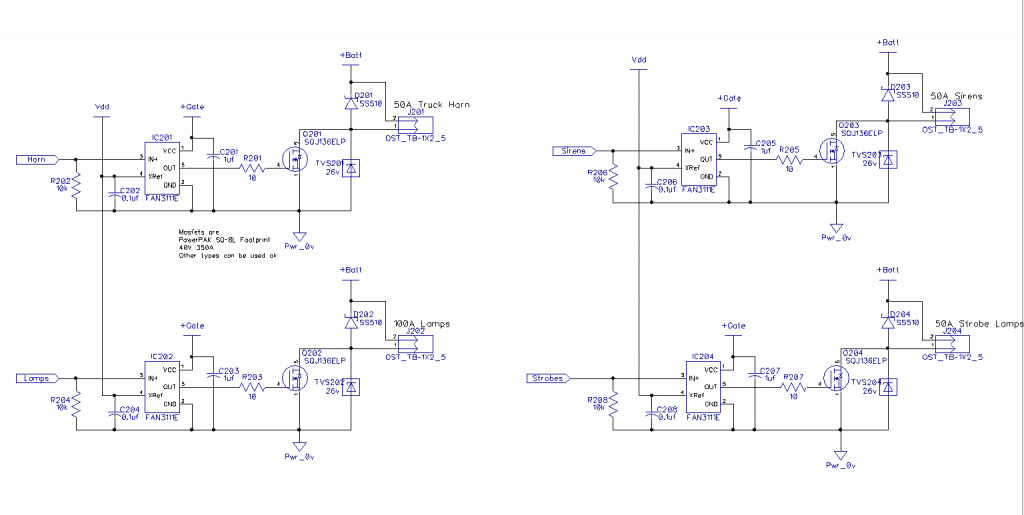

Have made a few alterations to the final schematic, added more high power mosfet output switches for Horns, Strobes, Sirens and Lamps; these are coupled directly to the CPU with tiny mosfet drivers.
All analog inputs are multiplexed by an analog mux chip, 74HC4051 with a common Low Pass active filter.

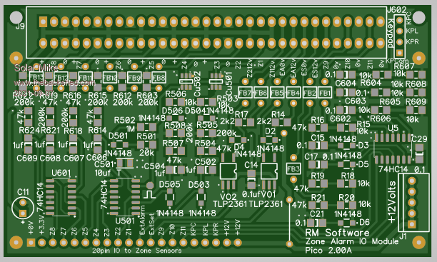

Digital IO from the various types of zone sensors, 16 in all are connected via 74HC251D digital multiplexers. The IO stuff takes up a lot of space so have placed that on a separate plugin pcb and sits over the main pcb.
The slower LED status display leds and output relays are accessed by power serial to parallel output chips NPIC6C596A, these can drive 100ma on each IO pin; the leds will be on a small pcb connected by ribbon cable so can bolt to the front panel of the case. Haven't started this board yet, next on the list.
Main PCB 245 x 128mm:
IO Zone Inputs 100 x 60mm:

Schematic:

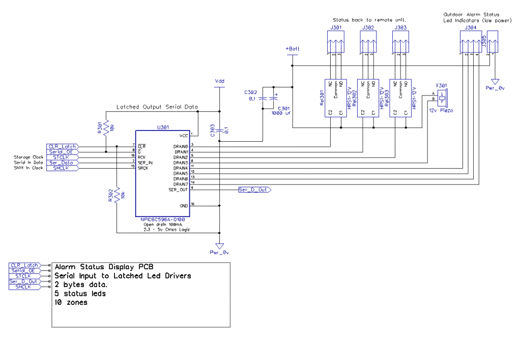

Posted: 02:07am 10 Sep 2021

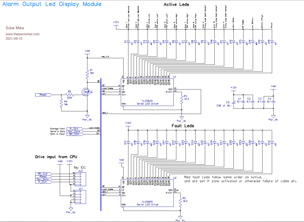

Schematic for the Led status display board, decided to use the serial input TLC5925 constant current Led drivers, so Led resistors are not required. Each zone will have 2 status Leds.
Mike

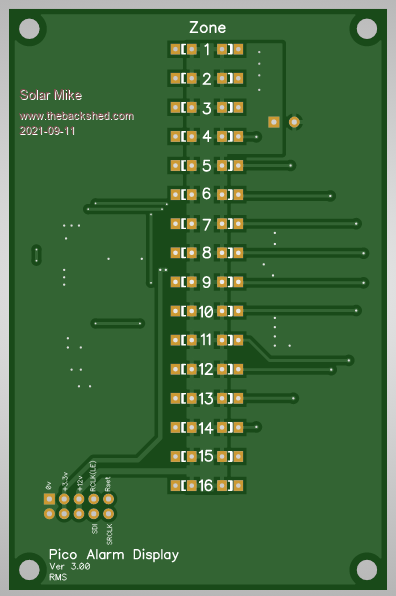

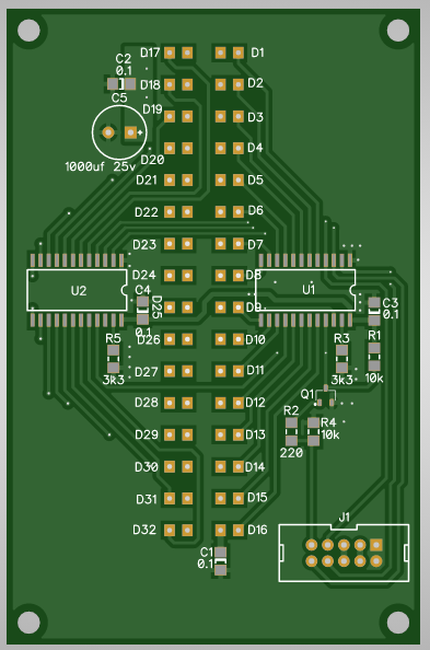

SPI serial Led display PCB, 100 x 65mm, smd or 3mm leds mount on the top half of the pcb, so they can show through holes or a slot cut in the front panel.
Mike

Posts: 6254
Posted: 08:03pm 11 Sep 2021
Impressive job Solar Mike. The boards all look absolutely good. Please also post some pictures when they are assembled.
About the power outputs. 50A - 100A are impressive currents, especially in the common path (all outputs loaded). Did you take special precaustions to prevent the PCB from overheating ? Is it 2 ounce copper ? or even thicker ?
Solar Mike
Joined: 08/02/2015
Posts: 1255
Posted: 03:45am 12 Sep 2021
  Volhout said  Impressive job Solar Mike. The boards all look absolutely good. Please also post some pictures when they are assembled.
The underside of the pcb (1oz) current tracks has a tinned solder mask, so additional heavy gauge wire can be soldered on to augment the current capacity.
Alarms are not running continuously and of limited duration, so not too worried about some short term heating. The mosfets have well in excess of 100 amp rating, so can switch very high peak currents, ie the truck horn requires > 40 amps on start.
Will post the zipped up gerbers to anyone here who wants them, no doubt the pcb could be used for other generic purposes.
