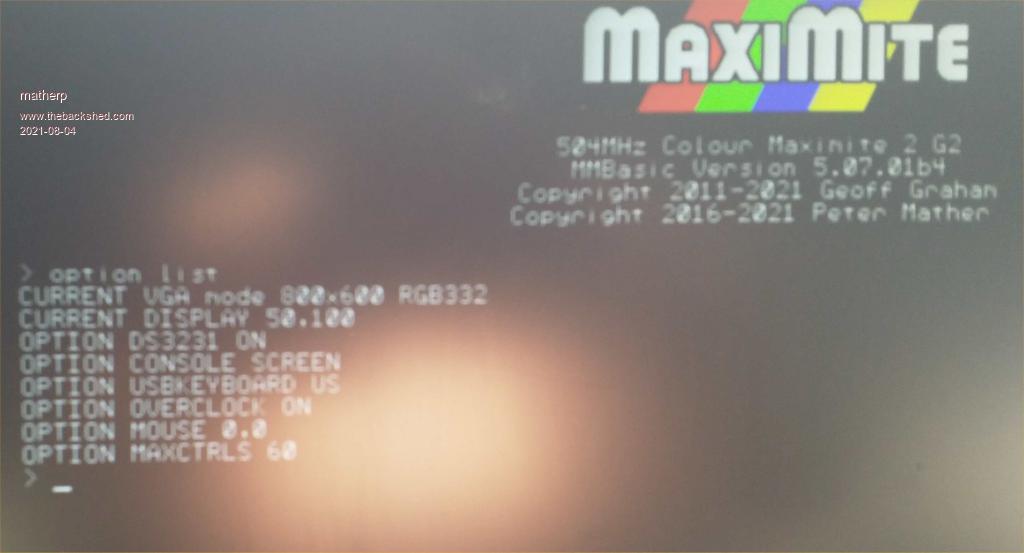

Here is my setup:
OS: 05.07.01b4
VGA mode 800x600
Display 50,100
OPTION DS3231 ON    <-----------This might be the problem
OPTION CONSOLE SCREEN
OPTION USBKEYBOARD US
OPTION OVERCLOCK ON
OPTION MOUSE 0,0
OPTION MAXCTRLS 60
I also did OPTION FLASH but that doesn't appear in the OPTION LIST
If I turn off the DS3231 hi-res timer, everything appears to be OK. If it's on,
the system goes through its initial keyboard, time and date questions every time I turn on the system.
NOTE: I just tried the same thing on another Gen 2 I have with the same result. This seems to rule out a hardware problem.
