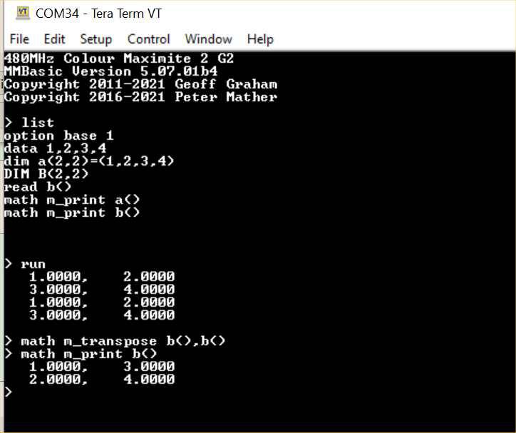

Posted: 02:44pm 31 Jul 2021
As I've explained in all matrix operations in MMBasic the fastest moving dimension is the first.  Everything is self consistent. For your program just reverse the indices in your for loops. This isn't going to change.
From the manual
  Quote  Note:
2 dimensional maths matrices are always specified DIM matrix(n_columns,
n_rows) and of course the dimensions respect OPTION BASE.
Edited 2021-08-01 01:38 by matherp
