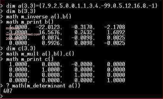

New math command
MATH INVERSE array!(), inversearray!()
This returns the inverse of array!() in inversearray!(). The array must be square and you will get an error if the array cannot be inverted (determinant=0)
New math function
MATH(DETERMINANT array!())
returns the determinant of the array. The array must be square

New math command
New math function
Thank you. This is great! For the inverse, do the arrays have to be different? IOW, would

dim a(3,3)=(7,9,2,5,0,0,1,1,3,4,-99,0.5,12,16,8,-1)
dim b(3,3)
math m_inverse a(),b()
math m_print b()
dim c(3,3)
math m_mult a(),b(),c()
math m_print c()
? math(m_determinant a())
