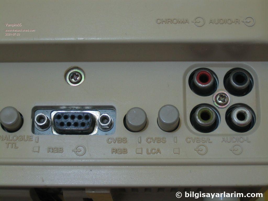

Hi Guys,
is it possible to connect the original CMM and CMM 2 to the old 1084s CRT Monitor?
The oldschool RGB Port has similar pin naming like the VGA Port.

Not that I'm aware of. It's a different system. You may be able to find a converter box but I don't think they are too common.

Huh, how did you end up with a 9-pin job instead of a SCART version of the monitor?
I have a 1084S-D2 and it is quite similar to yours. And I have some Extron boxes in the garage that I use on my Sony PVM. They work fine with my Amiga, and they probably should work here as well. Something like the Extron VSC 500 might work.

@SimpleSafeName: i bought this Monitor last week for 70 Euro in my Neighborhood for my C64. I thought its a good idea to have an oldschool RGB Interface :-)
I do not have such expensive Extron boxes...
@TassyJim: But the Monitor only have RGB and S-Video. How can i connect a composite signal?

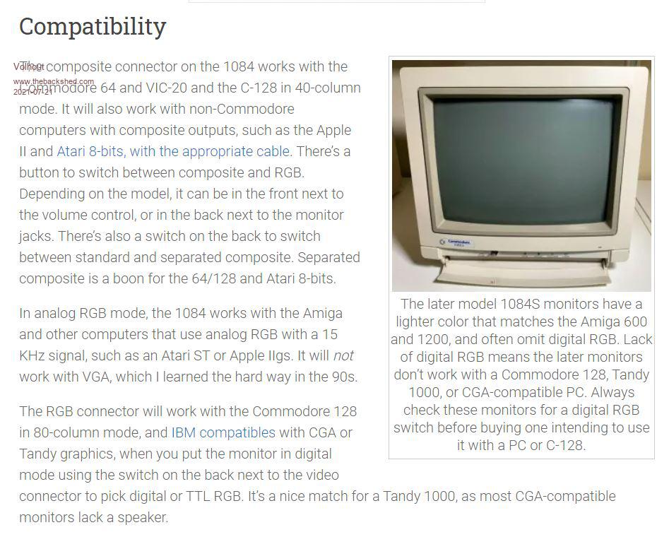

Hi Vampire05,
First of all, the 1084 monitor has RGB input that is more or less compatible with the old SCART RGB standard. It is analog, suitable for a 15.625kHz line rate. It has either composite sync in red, or composite sync on a separate connector.
The composite sync has 0V level for both HSYNC and VSYNC combined.
VGA is different. It has 31kHz or higher line rate, and has separate HSYNC and VSYNC signals. Depending on the VGA resolution, the HSYNC and VSYNC signals are inverted.
Technically it is possible to combine HSYNC and VSYNC with some logic to a composite sync signal, but it is not possible to drop the VGA framerate from 31kHz to 15.6kHz, unless you buy a frame rate converter (b.t.w. these are available from China, I used one to play PC movies on my old CTR TV).
If you apply 31kHz to an analog monitor or TV it is possible to destroy the monitor since some (non-multisync) monitor run the high voltage generator at the frequency of the line rate to avoid visible noise in the picture. Doubling the frequency (15.6 -> 31kHz) may destroy the high voltage generator.
And... as proven before ...Google is your best friend....
You will destroy the 1084S when you connect it to a VGA signal...
Edit: the CMM (CMM1) has an analog video mode (composite video) in black and white.
That will work with the 1084. But does not provide color.

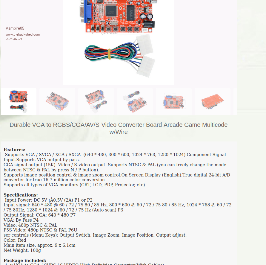

Has anyone had any experience with such boards:
will these boards work with all graphics modes of the cmm?

I have no experience with this part, but I'm doing some retro computing with C64, C128, Apple IIC... and I'm usually trying to solve to opposite way (S-video/Composite -> VGA/HDMI) and my 2 cents are:
1. with buffered convertor you can (and probably will) have some sync problems with fast animation coming from CMM2 - it will be synced on VGA side and not on the 15kHz side
2. colors will be washed out (you in Germany will have this better with PAL than NTSC, but anyway)
3. this destroying of "VGA quality" will cost you the same money, that you can put into small LCD monitor with VGA input (some 17" or 19")
4. higher resolutions will probably not work
Jiri

  jirsoft said  I have no experience with this part, but I'm doing some retro computing with C64, C128, Apple IIC... and I'm usually trying to solve to opposite way (S-video/Composite -> VGA/HDMI) and my 2 cents are:
All good points. I bought the Extron for use with my A4000 on a Sony PVM monitor. It cleaned up the signal quite nicely, and made for a pretty easy connection.
Prior to the Extron I was getting a crappy picture, if any at all. Pretty ugly...
A "down scalar", if those exist, might be necessary for this application.
And +1 on your recommendation for going with a more modern monitor. That's the sane approach. I have one that can handle 15khz as well as the "normal" frequencies, so I get the best of both worlds.
