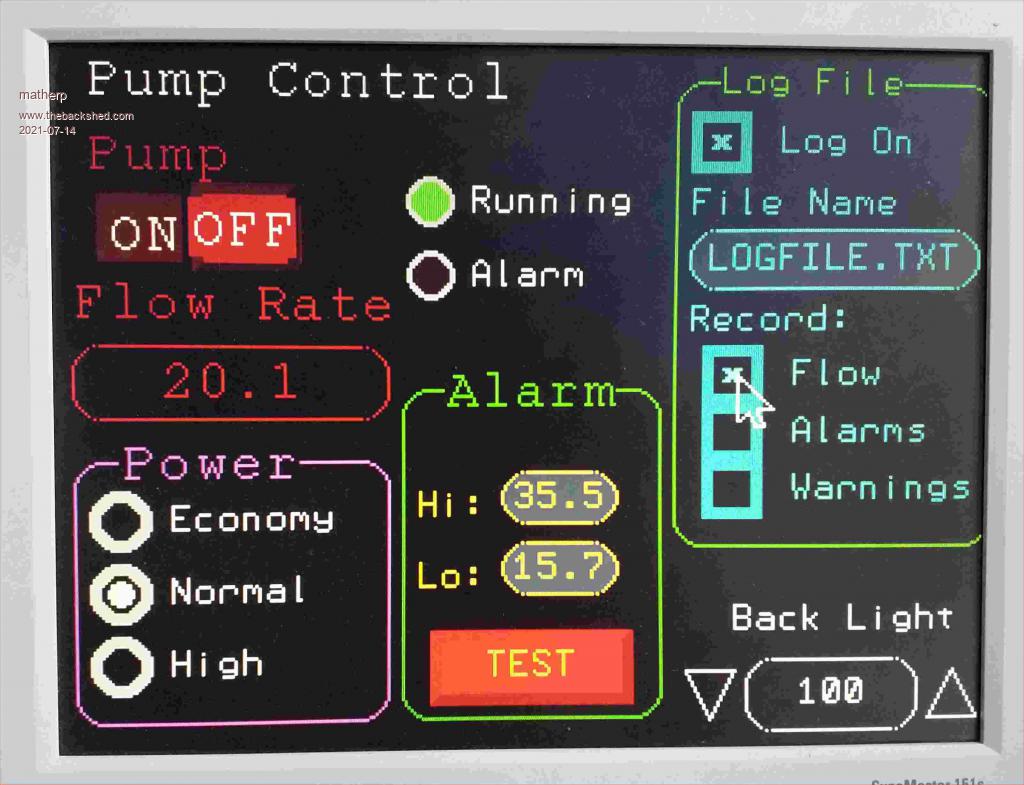

Posted: 05:37pm 13 Jul 2021
Here is an experimental version of the CMM2 firmware with a full GUI implementation.
CMM2V5.07.01exp1.zip
This is exactly like the MM+ with the exception that the PAGE command on the MM+ is now the GUI PAGE command on the CMM2. I've kept the TOUCH function exactly like the MM+ but of course "touch" refers to a left mouse button press. Beep is not implmented but is trivial to do in Basic using the PLAY TONE command in the touchdown interrupt.
To use the GUI commands you must have set up a mouse using the OPTION MOUSE command. In addition you must allocate memory to the GUI controls using the command OPTION MAXCTRLS n. By default this is 0 in which case the GUI implementation will have no impact on the CMM2 performance or operation. This is a permanent option.
Assuming this is all set-up and a mouse is connected the first use of a GUI command will automatically initialise the mouse and cursor. Then use the mouse to move the cursor round the screen and left click to activate the controls.
As before there is no guarantee that this functionality will make the cut for the next release however as the mouse support is now properly integrated it makes more sense and appears to work very nicely (limited testing)
' Demonstration program for the Micromite+
' It does not do anything useful except demo the various controls
' Modified for ILI9341 by Phil23
' Geoff Graham, October 2015
mode 7
Option Explicit
Dim ledsY
Colour RGB(white), RGB(black)
' reference numbers for the controls are defined as constants
Const c_head = 1, c_pmp = 2, sw_pmp = 3, c_flow = 4, tb_flow = 5
Const led_run = 6, led_alarm = 7
Const frm_alarm = 20, nbr_hi = 21, nbr_lo = 22, pb_test =23
Const c_hi = 24, c_lo = 25
Const frm_pump = 30, r_econ = 31, r_norm = 32, r_hi = 33
Const frm_log = 40, cb_enabled = 41, c_fname = 42, tb_fname = 43
Const c_log = 44, cb_flow = 45, cb_pwr = 46, cb_warn = 47
Const cb_alarm = 48, c_bright = 49, sb_bright = 50
' now draw the "Pump Control" display
CLS
'setpin 18,dout
'pin(18)=1
GUI Interrupt TouchDown, TouchUp
' display the heading
Font 2 : GUI Caption c_head, "Pump Control", 10, 0
Font 2 : GUI Caption c_pmp, "Pump", 10, 25, , RGB(brown)
' now, define and display the controls
' first display the switch
Font 2
GUI Switch sw_pmp, "ON|OFF", 10, 45, 70, 30, RGB(white),RGB(brown)
CtrlVal(sw_pmp) = 1
' the flow rate display box
Font 2 : GUI Caption c_flow, "Flow Rate", 5, 75,, RGB(brown),0
Font 2 : GUI Displaybox tb_flow, 5, 100, 105, 25
CtrlVal(tb_flow) = "20.1"
' the radio buttons and their frame
Font 2 : GUI Frame frm_pump, "Power", 5, 140, 105, 90,RGB(200,20,255)
Font 1
GUI Radio r_econ, "Economy", 20, 160, 10, RGB(230, 230, 255)
GUI Radio r_norm, "Normal", 20, 185
GUI Radio r_hi, "High", 20, 210
CtrlVal(r_norm) = 1 ' start with the "normal" button selected
' the alarm frame with two number boxes and a push button switch
Font 2 : GUI Frame frm_alarm, "Alarm", 115, 115, 90, 115,RGB(green)
Font 1
GUI Caption c_hi, "Hi:", 120, 150, LT, RGB(yellow)
GUI Numberbox nbr_hi, 150,MM.VPos-6,40,MM.FontHeight+6,RGB(yellow),RGB(64,64,64)
GUI Caption c_lo, "Lo:", 120, 175, LT, RGB(yellow),0
GUI Numberbox nbr_lo, 150,MM.VPos-6,40,MM.FontHeight+6,RGB(yellow),RGB(64,64,64)
GUI Button pb_test, "TEST", 125, 200, 70, 25,RGB(yellow), RGB(red)
CtrlVal(nbr_lo) = 15.7 : CtrlVal(nbr_hi) = 35.5
' draw the two LEDs
Const ledsX = 125, coff = 50 ' define their position
ledsY = 50 : GUI LED led_run, "Running", ledsX, ledsY, 8, RGB(green)
ledsY = ledsY+25 : GUI LED led_alarm, "Alarm", ledsX, ledsY, 8, RGB(red)
CtrlVal(led_run) = 1 ' the switch defaults to on so set the LED on
' the logging frame with check boxes and a text box
Colour RGB(cyan), 0
GUI Frame frm_log, "Log File", 210, 10, 110, 160, RGB(green)
GUI Checkbox cb_enabled, "Log On", 215, 20, 20, RGB(cyan)
GUI Caption c_fname, "File Name", 215, 45
GUI Textbox tb_fname, 215, 60, 100, 20, RGB(cyan), RGB(64,64,64)
GUI Caption c_log, "Record:", 215, 85, , RGB(cyan), 0
GUI Checkbox cb_flow, "Flow", 220, 100, 20
GUI Checkbox cb_alarm, "Alarms", 220, 120, 20
GUI Checkbox cb_warn, "Warnings", 220, 140, 20
CtrlVal(cb_enabled) = 1
CtrlVal(tb_fname) = "LOGFILE.TXT"
' define and display the spinbox for controlling the backlight
GUI Caption c_bright, "Back Light", 230, 190,,RGB(200,200,255),0
GUI Spinbox sb_bright, 210, 210, 110, 25,,,10, 10, 100
CtrlVal(sb_bright) = 100
' All the controls have been defined and displayed. At this point
' the program could do some real work but because this is just a
' demo there is nothing to do. So it just sits in a loop.
Do :Loop
' the interrupt routine for touch down
' using a select case command it has a different process for each
' control
Sub TouchDown
Select Case Touch(REF) ' find out the control touched
Case cb_enabled ' the enable check box
If CtrlVal(cb_enabled) Then
GUI Restore c_fname, tb_fname, c_log, cb_flow, cb_alarm, cb_warn
Else
GUI Disable c_fname, tb_fname, c_log, cb_flow, cb_alarm, cb_warn
EndIf
Case sb_bright ' the brightness spin box
'BackLight CtrlVal(sb_bright)
Case sw_pmp ' the pump on/off switch
CtrlVal(led_run) = CtrlVal(sw_pmp)
CtrlVal(tb_flow) = Str$(CtrlVal(sw_pmp) * 20.1)
CtrlVal(r_norm) = 1
Case pb_test ' the alarm test button
CtrlVal(led_alarm) = 1
'GUI beep 250
Case r_econ ' the economy radio button
CtrlVal(tb_flow) = Str$(CtrlVal(sw_pmp) * 18.3)
Case r_norm ' the normal radio button
Case r_hi ' the high radio button
CtrlVal(tb_flow) = Str$(CtrlVal(sw_pmp) * 23.7)
End Select
End Sub
' interrupt routine when the touch is removed
Sub TouchUp
Select Case Touch(LASTREF) ' use the last reference
Case pb_test ' was it the test button
CtrlVal(led_alarm) = 0 ' turn off the LED
End Select
End Sub

Posted: 06:42pm 13 Jul 2021
GUIDEMO.BAS works perfectly for me, thanks.
Hope it stays, though I don't know what I would actually use it for.
