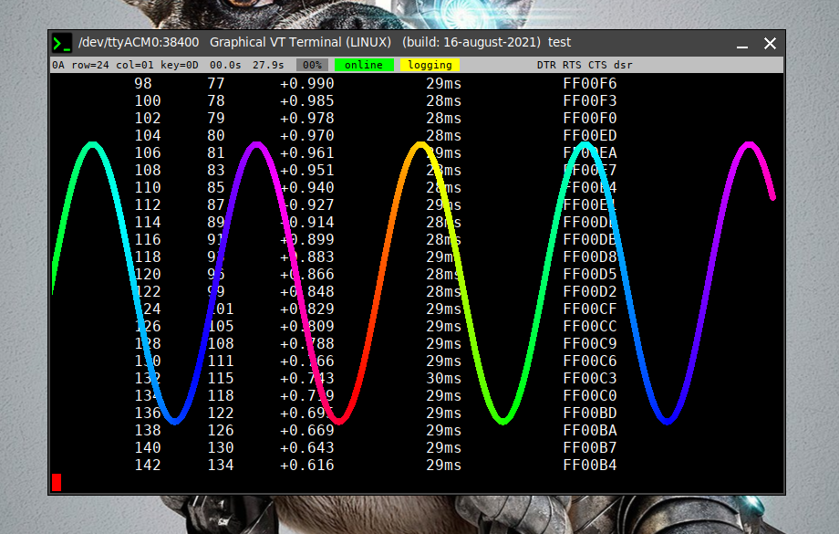

attached below, an update to GFXterm64 for 64-bit Linux:
GFXterm64 (16-aug-2021).zip
this fixes several small issues:
1. under Linux Mint 20.1 and 20.2 the screen could end up being 2 pixels per character cell too short, ie 48 pixels in total. this was an unfortunate interaction between Mint 20 and a bug in Lazarus, with the result of characters overlapping in the vertical direction. visible clipping would occur on lower-case characters with descenders: g, j, p, q, y, and some symbols. the fix was to obtain the dimensions of the cursor (on which all other screen measurements are based) in a different way.
2. under Linux Mint 20.1 and 20.2 the status bar was corrupted. this seems to have been caused by Mint 20 not supporting older type-1 fonts, and hence "Courier 10 Pitch" (included as part of X11) being no longer accessible to Lazarus (and likely other applications too). The fix was to switch to using the font "Monospace" instead.
3. the window 'fade-in' effect at startup has been fixed to remove a visible flicker on some systems.
4. the serial system has been completely reworked to become threaded. the most visible change here is that when a pi nano goes toes up, it no longer freezes up GFXterm for 30 seconds or so. instead the main loop of GFXterm keeps spinning, but no connection will be allowed until the serial threads (Rx and Tx) unblock.

Hi Robert,
Works fine on Gallium OS (ubuntu amd64 bionic (18.04)) on my chromebook.
My other linux PC's are still 32 bits (older stuff doesn't run 64 bits).
Tried several of my gfx compatible programs (i.e. fft) and they all worked fine.
Also the editor in colorcode mode works fine. Haven't seen artifacts.
Thanks for the <alt>-6 combi key. Used it already few times.
