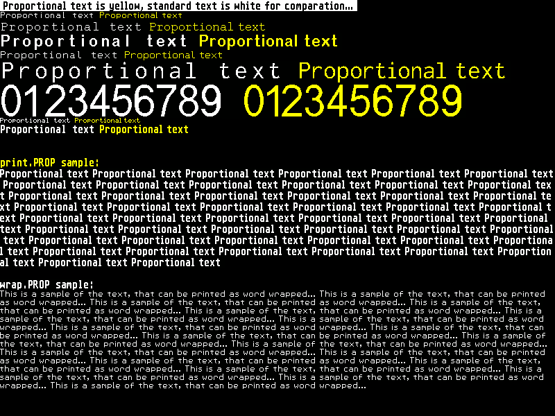

I have put on my GitHub very simple library for outputting of proportional text. It can be used with either built-in or user fonts on CMM2, simply call text.PROP instead of TEXT command...
The best use case can be text adventures (Hi Tom  ), because of better readability of the texts in proportional font.
PropText

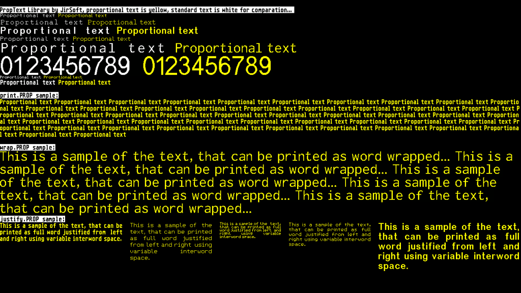

  vegipete said  For your next trick, could you force the printed line of (wrapped) text to be a specific number of pixels wide? Then a column of text would be left AND right justified.
Added justify.PROP(txt$, txtWidth%, dx%)...full jutified left and right word wrapped proportional text with size txtWidth% written to offset dx%
Also added one parameter to print.Prop and printLn.Prop:
print.PROP(txt$, addSpace$)...prints proportional txt$ on current position, wraps character to next line, without line feed
If the string addSpace$ is not empty, then to N-th SPACE (" ") in txt$ is added PX pixels, where PX=ASC(MID$(addSpace$, N, 1))print.PROP(txt$, addSpace$)
Usually when the text will be full justified, should be also possibly hyphenated - this wii bring massive amount of work, which I don't think make sense. So if the word not fit into set space, then is simply printed out (and will be wider), in the code is prepared ERROR for this situation when needed.
I'm also not adjust inter-letter space, as I don't like it and inter-word space could be just expanded not compressed (again, when used not so nice and code is much simpler)...
Enjoy!

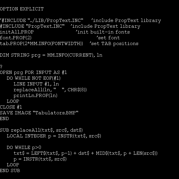

PropText library was updated to v0.04. Main news are support for TAB and LF charecters in print.PROP command, because of it printLn.PROP is simpler now and it was added command tab.PROP(t%), where with t% are set TAB positions to every t% pixels.
I have added Test2.BAS for test...
Enjoy!
