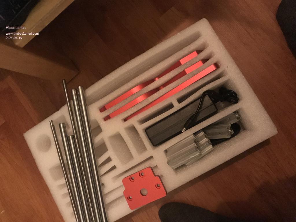

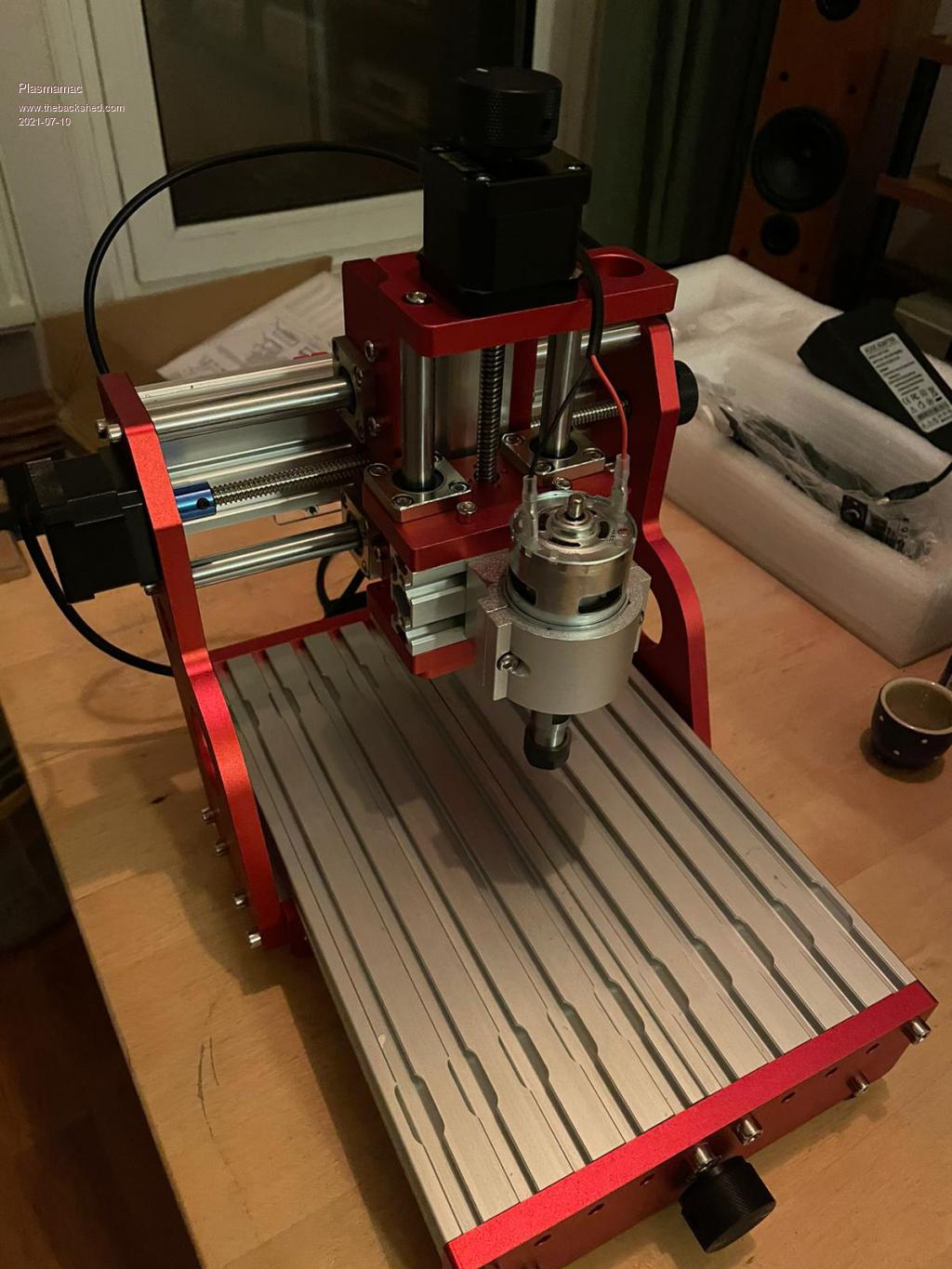

I bought a CNC 1310 for creating Pcb.
Plasma
Posted: 04:19pm 09 Jul 2021
  Plasmamac said  I bought a CNC 1310 for creating Pcb.
How has it worked? Do you have pics of output--and of the machine?

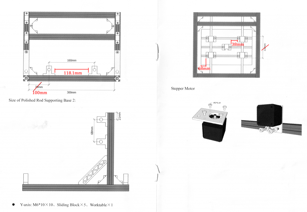

OK what you get.
A lousy instruction manual with incorrect measurements (i believe it was for a smaller model that they upsized but forgot to update, I will post that information later as well)
The instructions show what I believe is a one piece table but it is in fact a two pice that has to be joined by two strips of aluminium (seems quite effective but are not mentioned in the manual) but once again the measurements for the bearing mounts are out (no doubt due to a different table to the drawing) you have to improvise I will try to add pictures.
The mounting plates have holes drilled for the M3 screws but these are SUPER tight the screws have to be forcibly screwed into the plates and then screwed into the motors, they are tight but can be screwed in with some effort
A proper collet chuck is supplied instead of the joiner shown in the photos (a real bonus IMHO)

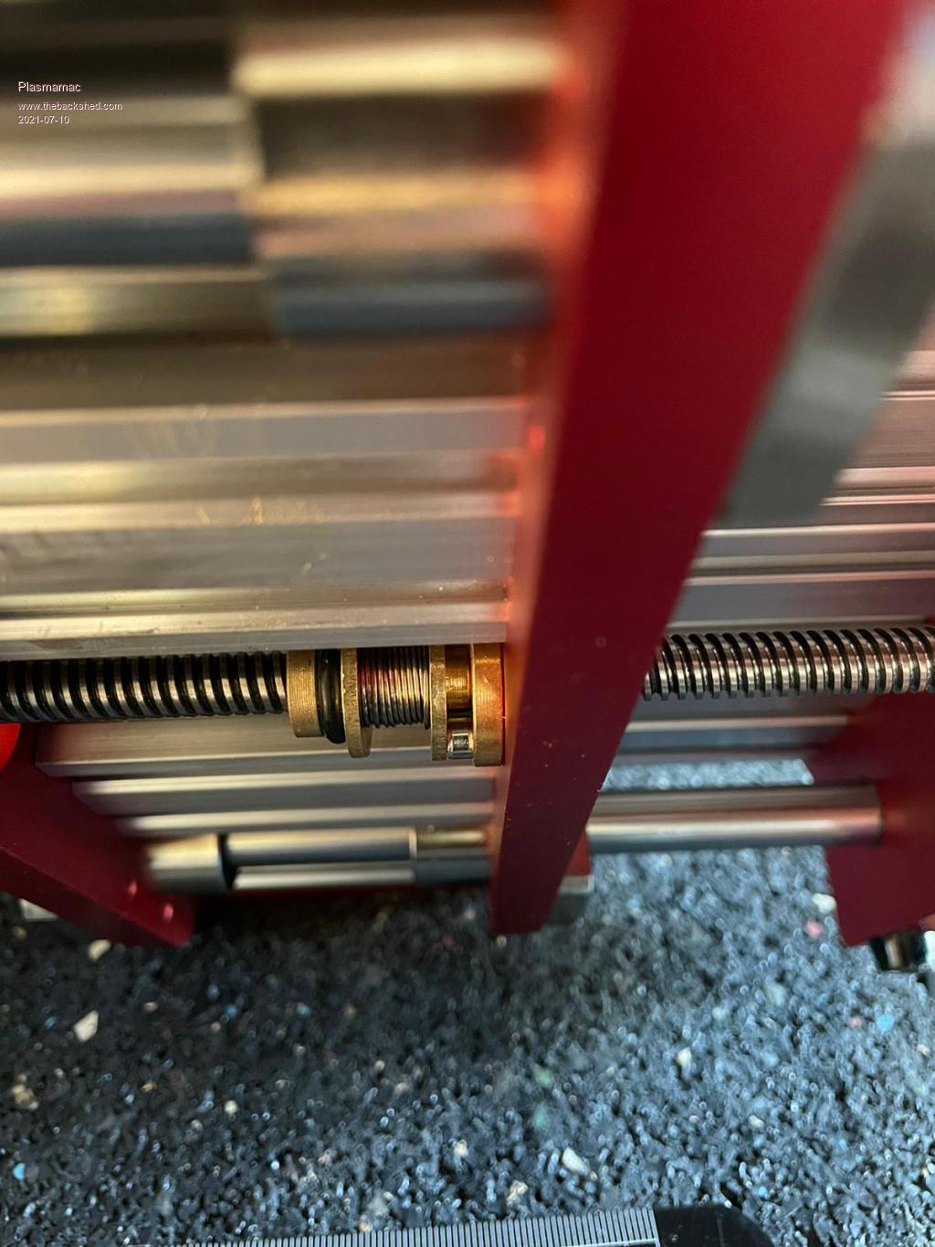

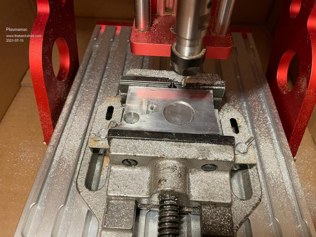

Plasmamac
Joined: 31/01/2019
Posts: 620

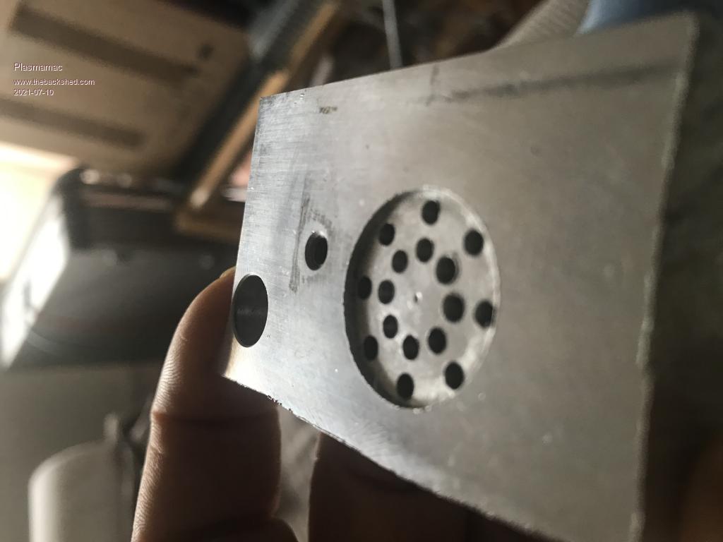

Posted: 03:01am 10 Jul 2021
Plasma
Posted: 10:45am 10 Jul 2021
Thanks for the pics. Looks sweet.

Plasmamac
Joined: 31/01/2019
Posts: 620
Posted: 07:54pm 10 Jul 2021
@lizby : beware you cnc is full of cheap plastic. The red one is full alu!

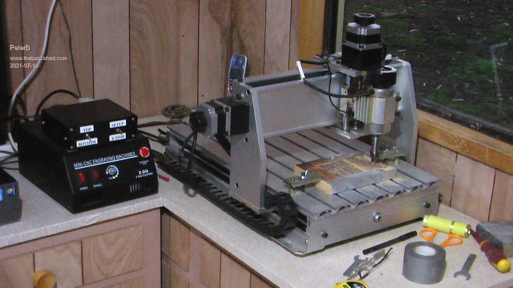

Just my two cents worth. I purchased a 3018 router (300mmX180mm capacity) around three years ago and IIRC is cost around AU$350 at the time.
My prime aim was to have a router for prototype boards and this unit did provide useful education with CNC & PCB prototyping.
The controller was the first component to fail as one of the cpu io pins going to the servo driver died. I chose a replacement controller with a probe sense pin as the original did not have one and I had to direct solder a wire to the CPU to get
access to the pin and the probe function is necessary for PCB etching. The second failure was that the unit developed too much backlash on the worm screws and movement of the plastic Z axis mechanism with flexing of the two horizontal guide bars.
I purchased a 1610 size unit hoping that there would be less flex in the shorter guide and screw lengths but this unit like the previous was limited with the motor power and lack of rotation speed. I both cases I felt that these units are
not substantial enough to be reliable at metal routing.
My next resort was to build my own unit with more strength, larger capacity and more power. I started using a Dremel style router at 150W 240V with heavy duty guide rails and ball/screw drives from the servos to eliminate backlash error.
I have recently upgraded the motor to a 500w 110V type and find I have more flexibility and power for metal routing.

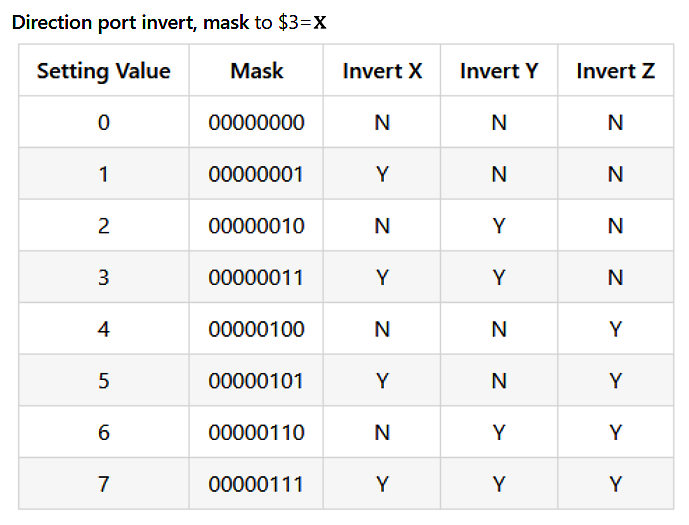

Posts: 2984
Posted: 05:30am 11 Jul 2021
At Plasmamac,
That is a very decent looking CNC you have there.
The 3018 is no where near that one.
Here are some `corrections' I did to the so called manual.
I suspect the document was originally for a smaller unit.
When I finished my unit one of the Axis (Y I think, I can't remember) were inverted direction. but here is a table to show the commands to adjust direction.
It is fairly self explanatory. just enter at the prompt  $3=x where x is the value from the table. This is a one off change but I think it adjusts the software NOT the cnc.
I cocked it up when I first did it so I did a $3=0 followed by the command I needed.
