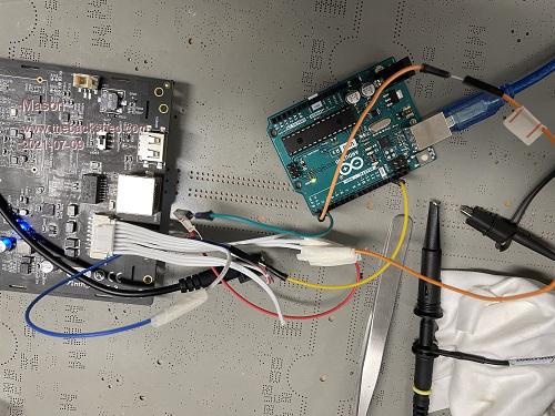

1. Display the power generation voltage of the solar charging panel through the STONE display module
2. Display lithium battery voltage through the STONE display module
3. The charging efficiency is shown by the STONE display module
In practical application, there may be more parameters to pay attention to, but since I am not from this major, I only pay attention to the above three parameters.
The hardware modules that I have:
1. Solar charging panel
2. STONE serial touch screen
3. Arduino UNO
4. Lithium battery charging board

Now I have learned how to connect the Arduino to the display.
Does anyone perhaps have a good suggestion about solar charging or how to put them together?
What all do I need to look for in this process?
