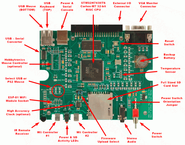

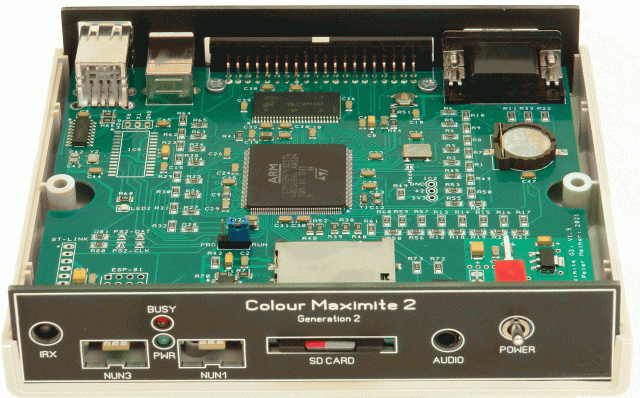

Announcing the Second Generation of the Colour Maximite 2 from Peter Mather.
The Generation 2 design is fully compatible with the first generation and is primarily designed to be easier to manufacture.  This version is not intended to supersede the first generation; it is more of an evolution with a number extra features:
- An additional 1920 x 1080 pixel VGA mode.
- 24-bit colour output (in addition to the standard 8, 12 and 16-bit modes).
- Extra RAM for BASIC programs (24MB vs 8MB).
- Support for a USB mouse (with an optional Hobbytronics chip) or a dual USB/PS2 wired mouse (no extra components required).
- Two Wii controller ports on the front panel.
- Support for an optional high accuracy real time clock (RTC) replacing the standard RTC and an optional ESP-01 WiFi module.
Because this design mostly uses surface mount components it is not recommended for home constructors and vendors will be supplying it as either partially or fully assembled.   If you are really keen you can build it yourself - the construction pack on my website has the details but you need to be VERY good at surface mount soldering.  You can also get a PCB fabricator like JLCPCB to supply and solder the parts for you, the required info is in the construction pack.
My website has been updated with the latest firmware and manuals: http://geoffg.net/maximite.html
The usual suppliers will be offering the 2nd Generation design (in no particular order):
- Rictech in New Zealand: https://www.rictech.nz/micromite-products
- Micromite Org in the UK: https://micromite.org
- CircuitGizmos in the USA: https://circuitgizmos.com/RetroMax-CGs-Color-Maximite-2-p241231864
- PS Labs in Poland: https://sklep.pslabs.pl/Maximite-c91/s_lang/en
Give them a little time to update their websites.  As most of you know there is a worldwide shortage of semiconductors and we have seen this with the ARM Cortex-M7 and RAM chips used in this design, so please be kind to your supplier if you experience extended delivery times.
Expect to see a two part series in Silicon Chip magazine describing the Generation 2 with the first article to hit the streets towards the end of this month.  We are releasing this early so that members of this forum can try out the firmware and report any issues (hopefully there will be none).
Congratulations to Peter for another huge effort.

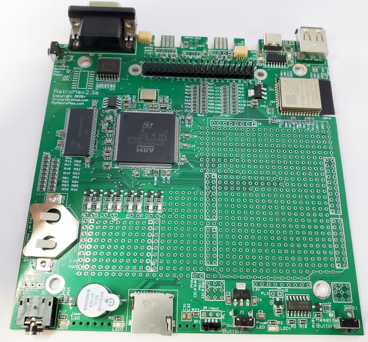

Circuit Gizmos has the RetroMax version 2.3a available. Slightly different design from the CMM2 Gen 2 that Peter has made, but compatible with the firmware/software.
The RetroMax 2.3a (this is the generation 2 compatible design) is in stock at CircuitGizmos and will be shipping out around the 8th. This can be ordered with or without the "slim" case and other optional items.
The RetroMax Generation 2 design is fully compatible with the first generation (RetroMax 1.4a), however, it has a few extra features:
CMM2 Gen2:
- 24-bit color output (in addition to the standard 8, 12, and 16-bit modes).
- Connections that support a wired PS2 mouse or a combo USB/PS2 wired mouse.
- Support for an optional high accuracy real time clock (RTC) on the PCB replacing the standard RTC.
RetroMax specific:
- Inclusion of an ESP32 WiFi module on the PCB.
- A USB "C" Console/Power connection to use better and more stable USB supplies.
- Two QWIIC connectors for convenient I2C connections.
- Self shutoff feature for the RetroMax.
The 1.4a (gen 1) version is also still available.
Edited 2021-07-02 12:49 by CircuitGizmos

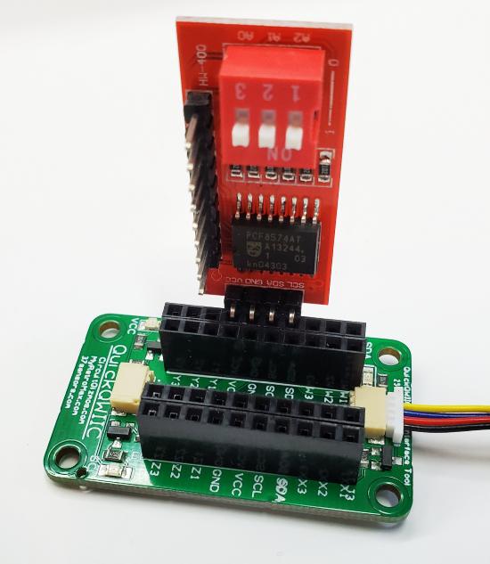

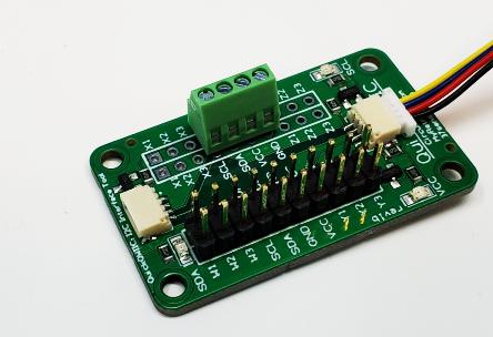

To take advantage of the QWIIC interface connectors on the RetroMax 2.3a, the QuickQWIIC is also available:
This is a prototype/interface board to make it easy to interface various I2C modules to use the QWIIC connectors on the RetroMax 2.3a.
QuickQWIIC Interface Board
There are a lot of QWIIC modules available with the QWIIC connector already on them from SparkFun, Adafruit (called STEMMA QT), and others.
I2C device modules are often available in the "37 sensor" kits and also from Amazon, eBay, AliExpress, etc.
The CircuitGizmos QuickQWIIC interface board lets you interface various modules to the QWIIC bus. It is a great way to make any I2C module/board into a Qwiic-enabled board. The QWIIC interface can be found on various development boards.
The QuickQWIIC has dual QWIIC headers on the board to facilitate a daisy-chain from the controlling QWIIC device to other QWIIC devices. Several boards can be chained together to put more than one I2C device on a bus. In the center of the QuickQWIIC are rows of plated-through holes with the four connections of QWIIC (power, ground, data, clock) arranged in different order to make connecting to I2C modules with their own arrangement of these signals easier.
If you have an I2C module with a 4 pin header that has power, ground, data, and clock in that order it is easy to find those pins on the QuickQWIIC in that same order. If power and ground are swapped, there is a row on the QuickQWIIC that will support that.
You can order a QuickQWIIC bare board or a board with the surface-mount parts populated. A third option includes a selection of .1" header sockets.
The red board in the images is an I2C module attached to the QuickQWIIC in the appropriate place for the order of the power, ground, data, and clock signals. By being plugged into the QuickQWIIC board this PCF8574A Remote 8-Bit I/O Expander becomes a QWIIC bus peripheral.
The blue board in the images is an RTC module (DS1307) with an EEPROM (24C32). The QuickQWIIC board makes this module a QWIIC bus peripheral. The BAT connection of the board lands in the Z1 position on the QuickQWIIC board. A jumper wire inserted into the other Z1 position can be used to connect to an external battery for this module. There are 12 pairs of these utility connections on the QuickQWIIC module.

My old monitor has no trouble with 1920 x 1080 and I expect that most widescreen monitors in use today will be the same.

Is the 3.5mm audio jack compatible with headsets (32ohm / 600ohm) ? Since it is in the front, you expect it to be.
AFAIK the 2 main confusions with gen 1 where
- keyboards
- audio (DC bias and high impedance)
Posted: 08:11am 02 Jul 2021
The audio has 4.7k resistors in series with the output so it is safe to connect low impedance speakers without the distortion.
There aren't any DC blocking capacitors so the output is available for DC level outputs if desired.
The main reason for problems with the Gen 1 audio was due to over-driving, not DC offset so the added resistors should be compatible with most systems.
Posts: 6254
Posted: 08:28am 02 Jul 2021
Hi Jim,
After I posted I checked the schematics on Geoff's site. And noticed the same.
To bad they did not fix this. When the audio was on the rear panel, you could argue that the 3.5mm jack was chosen since there was not enough space on the rear panel to accomodate the high impedance RCA (red/white) audio pair.
But now audio is on the front panel, with a connector type that is common for headphones, it is an invitation to connect headphones.
A missed opportunity....
Maybe for Gen 3 .. ?

This is fixed on the RetroMax 2.3a design (Generation 2 compatible) as it can drive headphones directly. You can plug headphones into the jack.

Can I ask what decided the value of 4k7 for the audio output resistors? That's a pretty high impedance output and probably wouldn't drive any commonly available headphones, although it's fine for active speakers or an amplifier input.
390R would give a maximum current of 8.5mA into a short circuit, so the output would probably be protected. It might also allow the connection of headphones as the audio output would be higher. Ok, it would put DC through the phones, but it probably wouldn't exceed 3mA or so which would be ok for most. It wouldn't give much output, but at least it might be usable and could handle down to 8R headphones safely.

  Mixtel90 said  Can I ask what decided the value of 4k7 for the audio output resistors? That's a pretty high impedance output and probably wouldn't drive any commonly available headphones, although it's fine for active speakers or an amplifier input.
The original design was for line level output and that hasn't changed.
4.7k is the usual impedance for line level.
I did do some tests to see what minimum resistance was needed to prevent distortion at the processor end but can't readily find the info. It's somewhere here on TBS.
To date, the vast majority of users have used PC powered speakers and 4.7k gives a good match to their typical 100 ohm to 2k input impedance while keeping the line level specs satisfied.
There is nothing to stop you bypassing the 4.7k with whatever value you desire but to drive low impedance speakers, a voltage follower or similar would be required.
