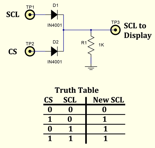

Hi Mick, All,
I had a little think about this,
I think this might work for you (haven't tested it)
Use a couple of schottky diodes and a pull down resistor.
You may have to fiddle with the pull down value a bit but it logically looks ok to my feeble brain.
You wont get an SCL signal to your display unless BOTH the SCL is low and the CS is low
The other Mick

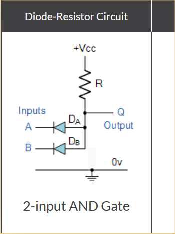

The normal discrete and gate has a pullup on the output and the diodes the opposite way round.
Posts: 3430
Posted: 07:38am 02 Jul 2021
Which circuit to use depends on whether a 1 is high or low. I think active low is required here so BigMick's version is the one to use.

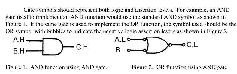

Hi All,
As Promised earlier.
Here is a snippet from >>> This PDF <<< on Negative Vs Positive logic (Page 3 of 8)
This is showing the Reverse of mine as an AND in positive logic and how it should look in as an OR in negative logic. Note the shape changes and the inputs/outputs all toggle the bubbles.

I tried your circuit, Mick. Partial success. At least the screen lights, but gui test, text and cls(colour) do nothing. 10k was too high to work, 1k gave these results. I went for 1n4148 diodes as they were handy - and are probably more suited to this job anyway.
Not sure what they did on the module, but on the chip CS is active low and data seems to be read on the rising edge of SCL. It might be a timing issue, I suppose.

Re my circuit, sorry it didn't work as expected, I was worried about timing hence why I selected Schottky diodes.. plus they should give a higher HI as they only drop .2-.3v compared to your IN914 of .6-.7v which would drop the high to say 2.6v you should get about 3v using schottky.
It is a tricky one, I wonder why they didnt bring the CS out to at least solder jumper option pads.
You could try dropping the resistor to 470R or even trying a 100nf in parallel to the resistor to slightly extend/delay the SCL to the display.. it may or may not work..

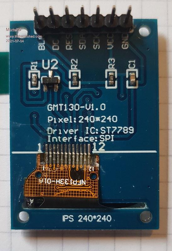

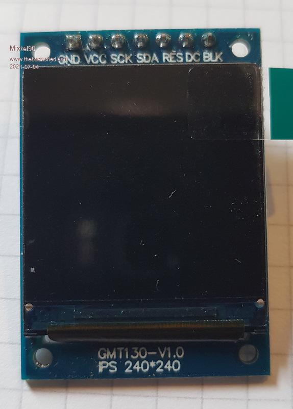

This is the display I ordered.
Having finally had a proper look at the back it's not quite the same:
https://www.ebay.co.uk/itm/393093456134?ssPageName=STRK%3AMEBIDX%3AIT&_trksid=p2060353.m2749.l2649
Although connections are the same, the pcb on the one I received isn't laid out the same as either the one used for the mod or the picture on ebay! All the ebay pics for the 1.3" model seem to show the same version, but goodness knows what you'll actually get if you order one.
