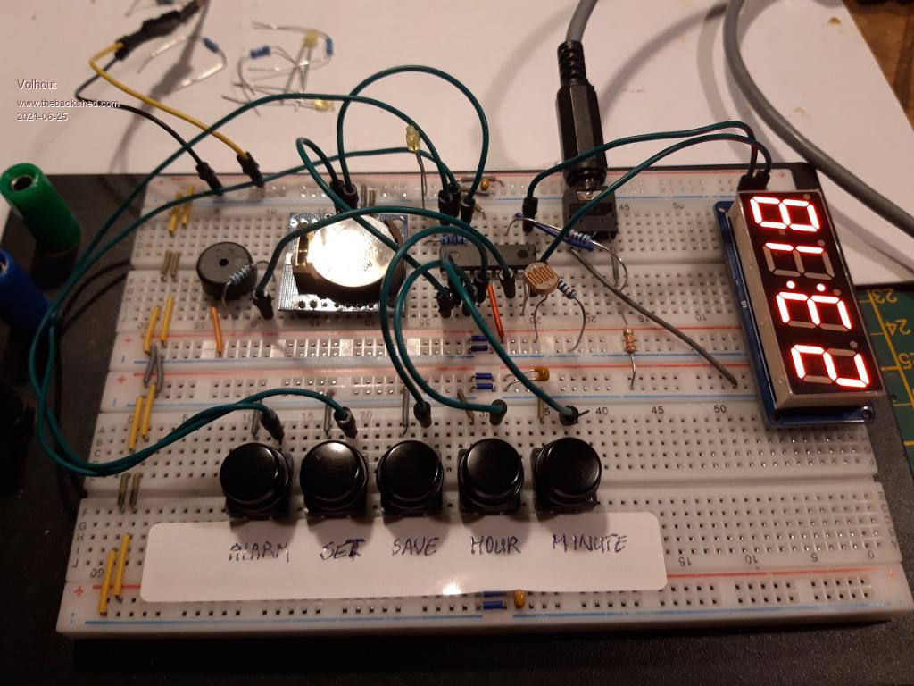

Wednesday mornign I realized my wake-up clock died (result: getting to work late....). Repair was out of the question (LED display, black goop blob on a single sided PCB).
OK. I'll build one myself. After 2 evenings of hacking around, this morning I woke up to the sound of my own...
Now I still have to put it on stripboard and put it in a box....

Photo resistor for display dimming?

Nice. PIC16F??? with 2x I2C channels?

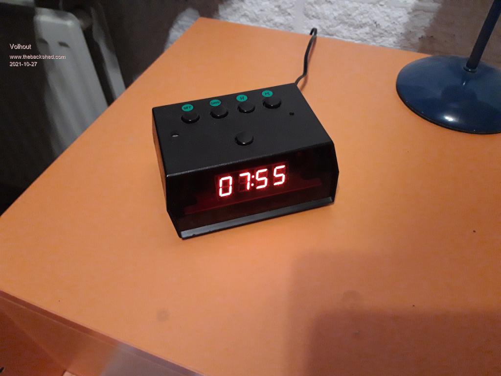

A short update after 6 month of use. The clock works fine. The core is a PICAXE 18M2 running 4 tasks. The only problems with it where the real time clock module.
The real time clock module is based on a DS1307 chip. This chip is old as coputers are. I remember my first XT computer had one in it, and it ran absolutely flawless. More accurate than my watch (Casio at that time).
The DS1307 module I had had the wrong components in the battery charging circuit, (I posted about this before).
And I discovered this after few month of use, also had a non-matching crystal soldered onto it. The DS1307 needs a crystal that is tuned for 12.5pF to be accurate. Well, the time on my wake up clock was off by 1-2 minutes per month. After investigation I needed to add around 10pF from each of the crystals pins to ground to tune it. One capacitor is a trimmer, so I could trim the clock within 0.1Hz (at 32.768kHz). It is absolutely accurate now.
I know it is stupid to design a wake up clock you can buy for 2 dollar online, but it was satisfying....
The circuit is simple: a PICAXE 18M2, 5 buttons, a LED, a beeper, a RTC module, a TM1637 display module, and LDR (it adapst brightness depending on room lighting). All running from a phone charger. If you want to build it, the connections are in the code (pinning of the PICAXE).

'let day     = $03 ; 03 Note all BCD format
'let year    = $19 ; 03 Note all BCD format
'let month   = $01 ; 12 Note all BCD format
'let date    = $26 ; 25 Note all BCD format
'let hour    = $17 ; 11 Note all BCD format
'let mins    = $50 ; 59 Note all BCD format
'let seconds = $00 ; 00 Note all BCD format
'let control = %00010000  ; Enable output at 1Hz
'writei2c 0,(seconds,mins,hour,day,date,month,year,control)
do
' Read the clock time
readi2c 0,(seconds,mins,hour,day,date,month,year) 'actual RTC values
readi2c 8,(ahour,amins)  'previously programmed alarm time
' check if different, so we can update display
if oldmins<>mins then
        oldmins=mins
        D3=hour/16
        D2=hour&$0f
        D1=mins/16
        D0=mins&$0f
        change=1 ' update display now in other task
endif
pause 500
loop
' this task does all background tasks ==========================================
start3:
do
' dummy task to blink colon
change=2 ' update display now in other task
pause 500       ' this is the ON time o the blinking column
' check for alarms and execute, if alarm set colon blnks
if wake=1 then
pause 500       ' this is the OFF time of the blinking column
        ' only when alarm is on, hour is correct, minute is correct ring bell
        ' thus the alarm goes for 60 seconds
if ahour=hour then
if amins=mins then
        inc bell
else
        bell=0
end if
end if
else
bell=0
end if
' here the actual ringing takes place, either beeper or led drives the bell coil
' the display flashes or extra visual alarm
if bell>=1 then
high led
' make the display max brightness
light = $8f
change = 1
' sound the alarm
        sound beeper,(120,10)
        pause 100
        pause 100
        ' make display dim
        light = $89
        change = 1
        low led
else
low led
' measure ambient light and adapt brightness
' LDR varies between $A0(light) and $0C (darkness)
' convert to $8F (bright) and $88 (dim) display
readadc anain,LDR
'debug
'clip the ADC value for easy conversion
if ldr>$7F then
ldr=$7F
end if
' conversion math (rough approximation)
ldr=ldr/16
light=ldr+$88
' to save battery current while debugging, overrule ADC value
'light = $89
end if
loop

Posts: 6122
Posted: 06:36am 27 Oct 2021
The code was nicely indented, but the copy and paste made a mess out of it.
Posts: 9136
Posted: 06:54am 27 Oct 2021
That's really nice, Volhout. :) It has a really cool retro look - glad you stuck with a red 7-seg display. :)
One of my digital clocks is one with a proper mains transformer (you can feel the weight). I suspect it's using mains frequency division as the frequency source as it never appears to drift at all when I compare it to a RF time signal clock. I know the RTC chips can be pretty accurate but I've rarely had one that didn't drift. Some of the little modules are pretty bad but you need a good frequency counter to set them up correctly.
Edited 2021-10-27 16:56 by Mixtel90
