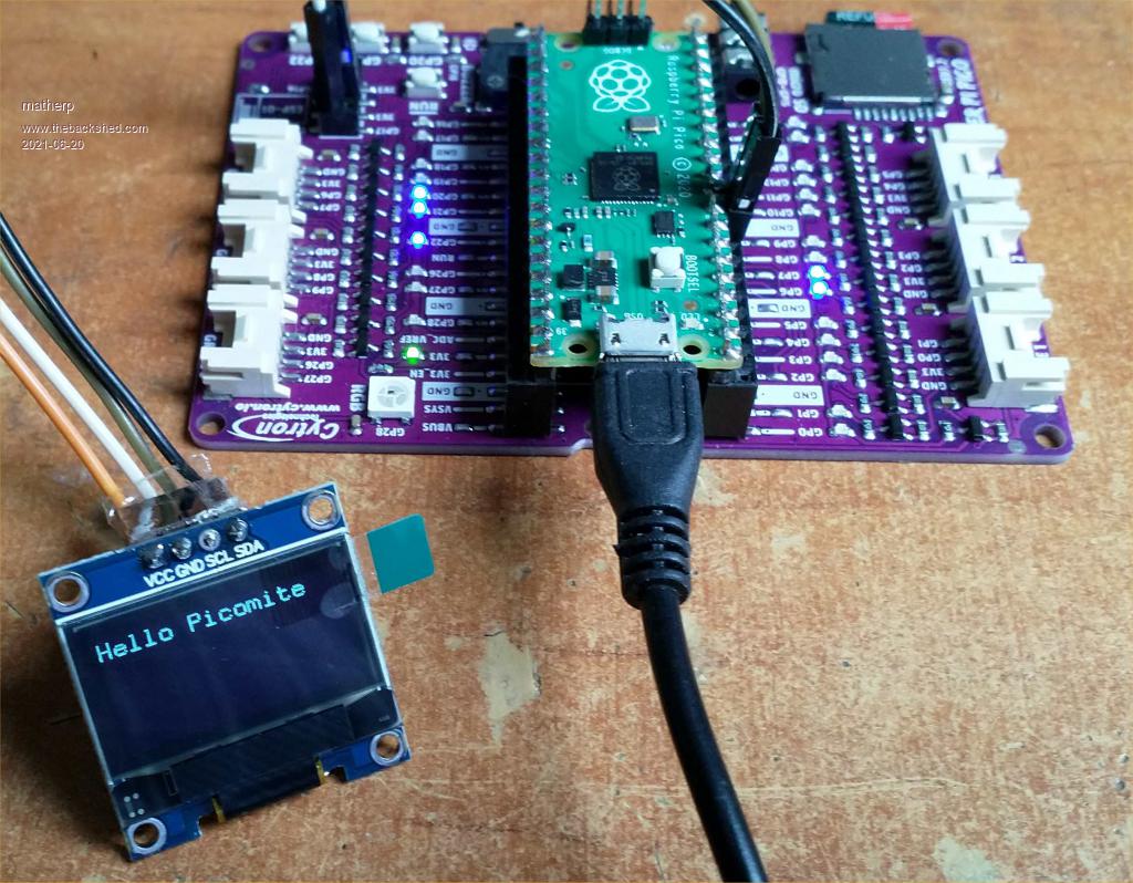

This version starts the process of implementing display support. This is based in the ArmmiteL4 but with a PicoMite twist.
The first display implemented is an I2C SSD1306. This should be set to the default address (0x78/0x3C)
In order to use the display we need to allocate the I2C pins. This works the same as the pins for the SDcard
OPTION SYSTEM I2C sdapin, sclpin
These pins must be valid I2C0 or I2C1 pins and will be configured to run at 400KHz. In future the SYSTEM I2C will also support a DS3231 RTC. Other devices can be connected to the I2C bus and accessed as usual with I2C READ and I2C WRITE. The I2C port does not need to be opened in this case.
The display is then enabled with
OPTION LCDPANEL SSD1306I2C, orientation
or
OPTION LCDPANEL SSD1306I2C32, orienation
for the 128x32 version of the display
If you can find a 1.3" version that works in I2C mode you can add a parameter offset to locate the image correctly
Typically this would be:
OPTION LCDPANEL SSD1306I2C, l, 2
All the usual graphics command should be there but testing is limited
