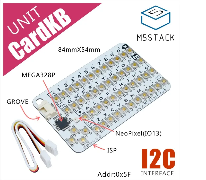

Hey folks,
This kept going by in my Facebook feed so I figured what the hell and bought a couple:
https://docs.m5stack.com/en/unit/cardkb
I then adopted a "monkey don't have a clue, monkey guess" approach (my first use of I2C) and it was easy to get working on the PicoMite:
Option Base 0
Dim addr%, byte%
SetPin GP0, I2C0SDA
SetPin GP1, I2C0SCL
I2C Open 100, 1000
addr% = &h5F
 I2C Read addr%, 0, 1, byte%
 If byte% = 0 Then
   ' nothing
 ElseIf byte% > 31 And byte% < 128 Then
   Print Chr$(byte%);
 Else
   Print "[" Hex$(byte%, 2) "]";
 EndIf
 Pause 100
Loop
... though I wouldn't like to type on those naked tactile buttons for long.

Interesting. Made me wonder why there isn't any ordinary keyboard with an I2C interface. I searched, and couldn't find one.
I assume the 4 lower left buttons are arrow keys--how are they translated?

  lizby said  I assume the 4 lower left buttons are arrow keys--how are they translated?
If you follow the URL there is a table showing the byte values for each key / sym / shift / fn combination.
As far as I can tell:
- it has no auto-repeat, i.e. if you want multiple A's you have to keep pressing [A]
- it doesn't detect simultaneous key presses. Pressing a modifier key [Sym/Shift/Fn] puts the keyboard into that mode (indicated by a coloured LED) so that the next key press produces the modified byte. If you press a modifier key twice quickly then it locks that mode in place for all subsequent key presses until a modifier key is pressed again.
