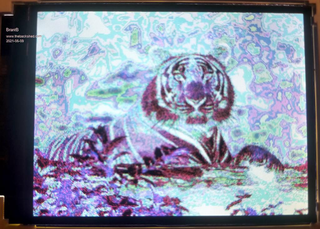

I have a number of ILI9341-based IPS LCD screens, and it seems that they operate (natively) in an 'inverted' colour mode - where black is displayed as white, and white is displayed as black, and all of the other colours in the spectrum in between are like looking at a negative film strip.
Oh boy - I just dated myself.  I do recall the days why you actually had to put FILM in your camera, and then develop it with horrible smelling chemicals.  But enough about memory lane.  A picture is worth 1,000 words ... so, here is a picture of what the tiger BMP looks like on my IPS screen:

Firstly, your problem with the LCD TFT display has already been covered in V5,05.03.  From the change log:
  Quote  Added support for some TFT ILI9341 type displays that require the colour signals to be inverted to display the correct colours.  To do this you need to specify the display type as ILI9341_I in the OPTION LCDPANEL command.  Other than this the inverted LCD panel will work the same as the standard panels.

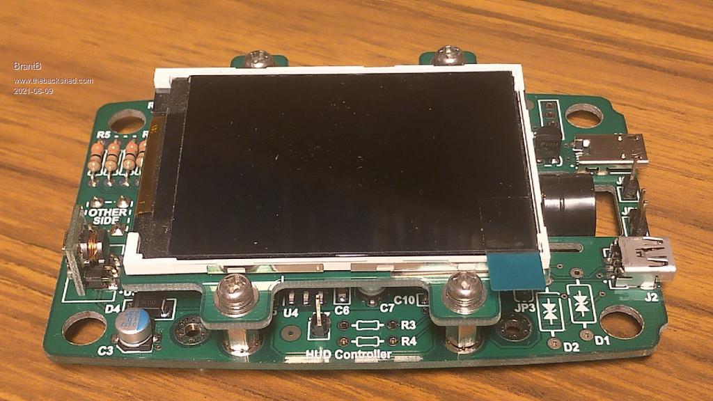

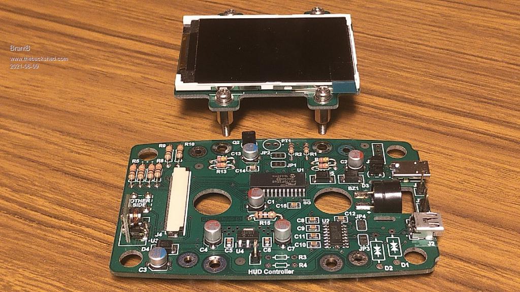

These are just the LCD panels themselves with the FPC ribbon "cable" - they do not have any integrated "backer" PCBs.  This was driven by space constraints and certain mounting requirements in a small enclosure, in our initial project.  So, we ended up having to design our own "carrier" PCB (passive - no active circuitry) for the display, and the FPC cable connects directly onto our custom application PCB.
Here are a couple of pics of the project that started it all ...
