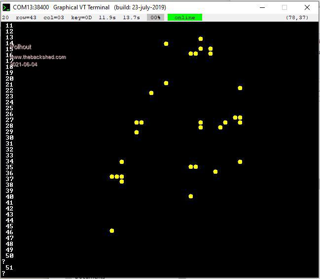

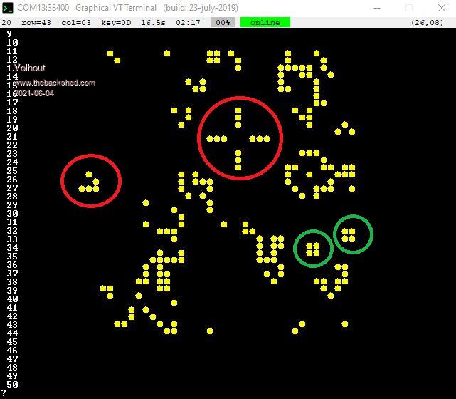

Posts: 6125
Posted: 10:54am 04 Jun 2021
Hi Vegipete,
Please look at following behaviour. Running your game on a pi pico. I printed the generation number left on screen, so you can see why it is strange. This is generation 50 from a random seeded field.
The red circles are oscillators, they only die when they get corrupted. These are quite isolated, so it will take a few generations before they should get corrupted.
The green circles are statics, these will no change shape, but may die if something gets near to them.
Now look at generation 51. This is a total different world.
Needless to say that generation 52 is a empty field. But what is happening between generation 50 and 51. And apparently this does not happen on a CMM2 ?
I fear there is something strange in the math on the pi pico.

When I change the array from float to integer, the game continues.
Must have something to do with bit shifting a float variable.
