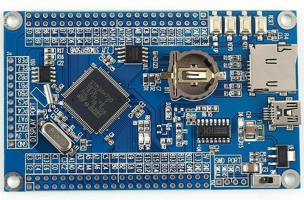

I came across this board while searching Ebay:
"STM32H750VBT6 Development Board ARM STM32H7"
I'm not sure if it is compatible but it has Battery, MicroSD, CH340, and a few keys, plus nice pin labels on PCB:
Not quite as cheap as F4 boards though. Might not have enough flash for MMBasic?
Edited 2021-06-03 02:59 by flasherror

It will need EXACTLY the same CPU and even then you MUST check EVERY pin is used in the same (or a compatible) way.
Or just get the board known to work.
Did I mention EXACTLY... oh yes.
Edited 2021-06-04 21:19 by JohnS

and sort that bleedin' crystal out! dreadful

  CaptainBoing said  and sort that bleedin' crystal out! dreadful
Photo from ebay, not my board.
Posts: 4337
Posted: 04:01pm 04 Jun 2021
Bearing in mind what I posted, that board is not suitable at all, crystal or not.
