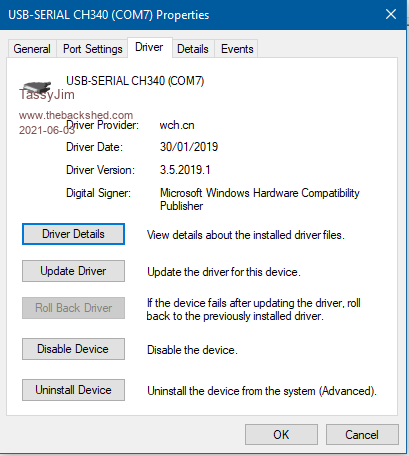

Posted: 10:35pm 02 Jun 2021
  OA47 said
  Quote  No trouble here latest W10 update and CH340 in daily use
Jim which Windows 10 build do you have 20H2 or 21H1?
OA47
Edition Windows 10 Home
Version 21H1
Installed on 10/06/2020
OS build 19043.985
Experience Windows Feature Experience Pack 120.2212.2020.0
