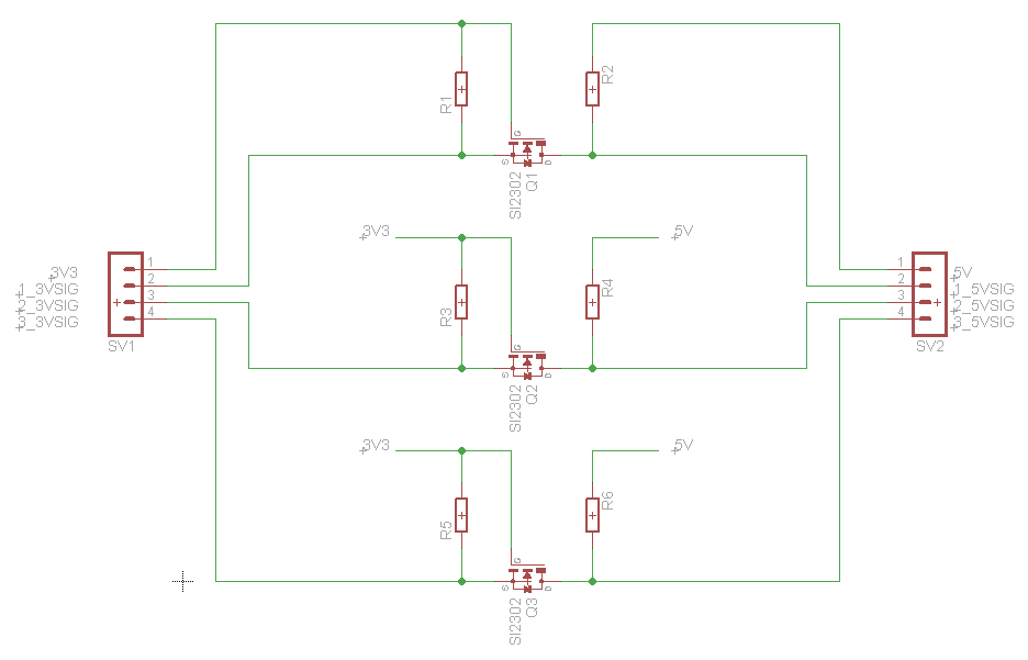

I made my own from a common circuit on google. Works nicely and you can simply pick bits of it up and reproduce to do level-shifting on any width. Resistors are matched to whatever pull-up you want, 10K, 4K7 whatever...
That said, rtg boards are very cheap so if you can match the size I would go that way - I just wanted a very small 3-way shifter hence this board
