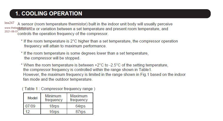

I've found this

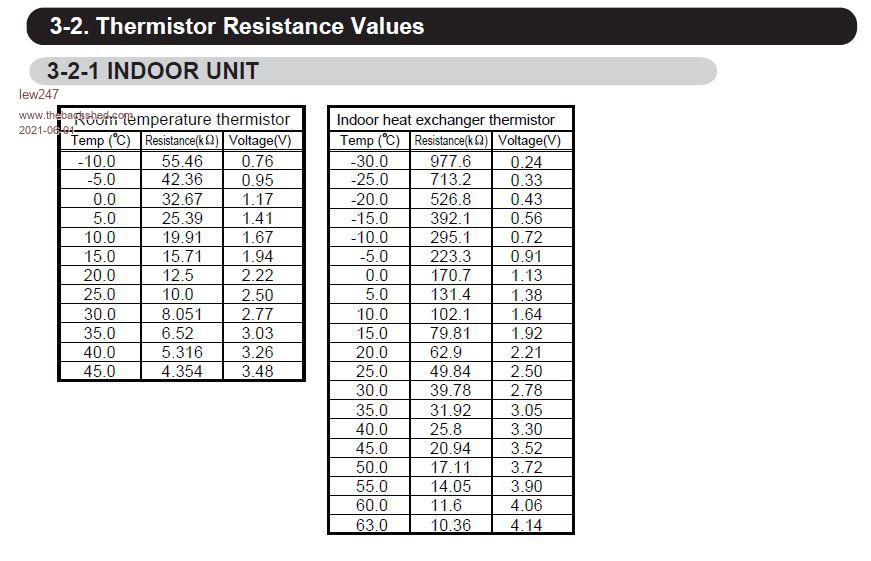

and here are the resistance values and voltages for both thermistors at various temperatures

Although we used to install some small aircon systems we tended to treat them as "black boxes" most of the time. There wasn't usually a lot you could tweak.
Normally, if you aren't getting a low enough room temp then the system is undersized for the temperature difference that you are trying to get. Have you considered that the gas pressure might be low and it's running inefficiently? I doubt if you'll get much more out of it than it was designed for.
I wouldn't mess with the heat exchanger temp sensor unless you are *certain* that it's not part of a anti-icing and/or over-temp safety system too. The room temp stat is probably fair game for fiddling. :)  I'd be tempted, initially, to simply lengthen its wire and try it in a different location temporarily. If that works then move it.

A trick I have used is to fool the system into thinking the temp. is a little higher than the actual temp by adding some resistance in series with the thermistor.
Measure the resistance of the thermistor at both the lowest setpoint and at the temp. you want, then add a resistor equal to the difference. You will have to remember the temp. offset when changing the setpoint.

Oops! I got it backwards. You need a parallel resistor to reduce the setpoint.

I think the best idea so far is to measure the resistance of the thermistor, and if it is working properly, try and move it outside the wall unit by extending the cable
not certain this would work but worth a try.
