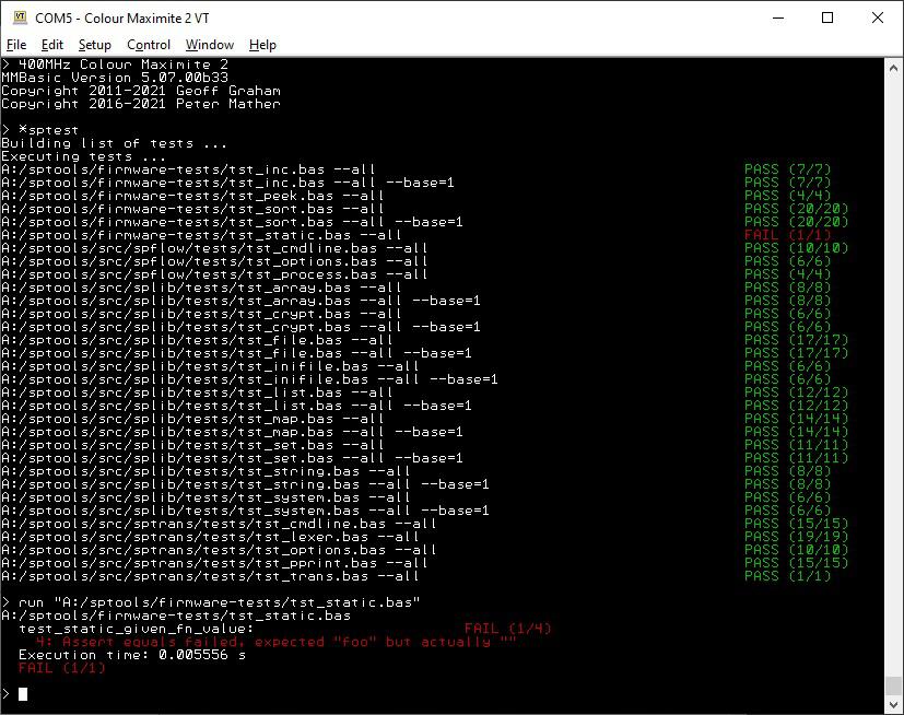

  matherp said
  Quote  I wonder if it would save you time (and questions from uC ignoramus', i.e. me) if you could briefly summarise what your expectation is that the Picromite will not be able to do that the CMM2 can do,
The PicoMite is designed as an embedded processor like the normal Micromite not a computer
To the limitations of my understanding of micro-controllers I "understand", but those limitations are considerable and the differences between micro-controllers and micro-computers seem to be ever-decreasing ... isn't the CMM2 just a micro-controller with attitude ? However, nevermind, I'm sure someone will fill me in or I'll pick it up as we go along.
Given that the PicoMite has a file-system (or so I assume since it has SD support) could I request that you include * commands, OPTION SEARCH PATH, EXECUTE, and RUN with command line options as per the CMM2. This will allow my MMBasic unit-test suite to execute on it which is presumably advantageous to all ... except perhaps yourself given fixing any bugs it finds will ultimately fall to you.

Posts: 4410
Posted: 01:55pm 31 May 2021
  matherp said  Absolutely not and never - sorry
That's a shame, one command executed at the top-level runs every automated test I've written. Once you start unit-testing you never look back:
The FAIL is the known issue with STATIC variables that I've recently reported.
Anyway, thankyou for the PicoMite, it looks like a great piece of kit to release the magic smoke from whilst flashing LEDs, certainly cheaper than wrecking my CMM1 or 2.
