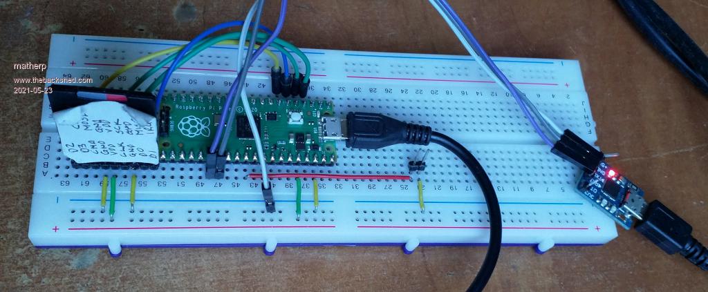

Posted: 05:11pm 22 May 2021
FTDI to communicate and USB for power ?

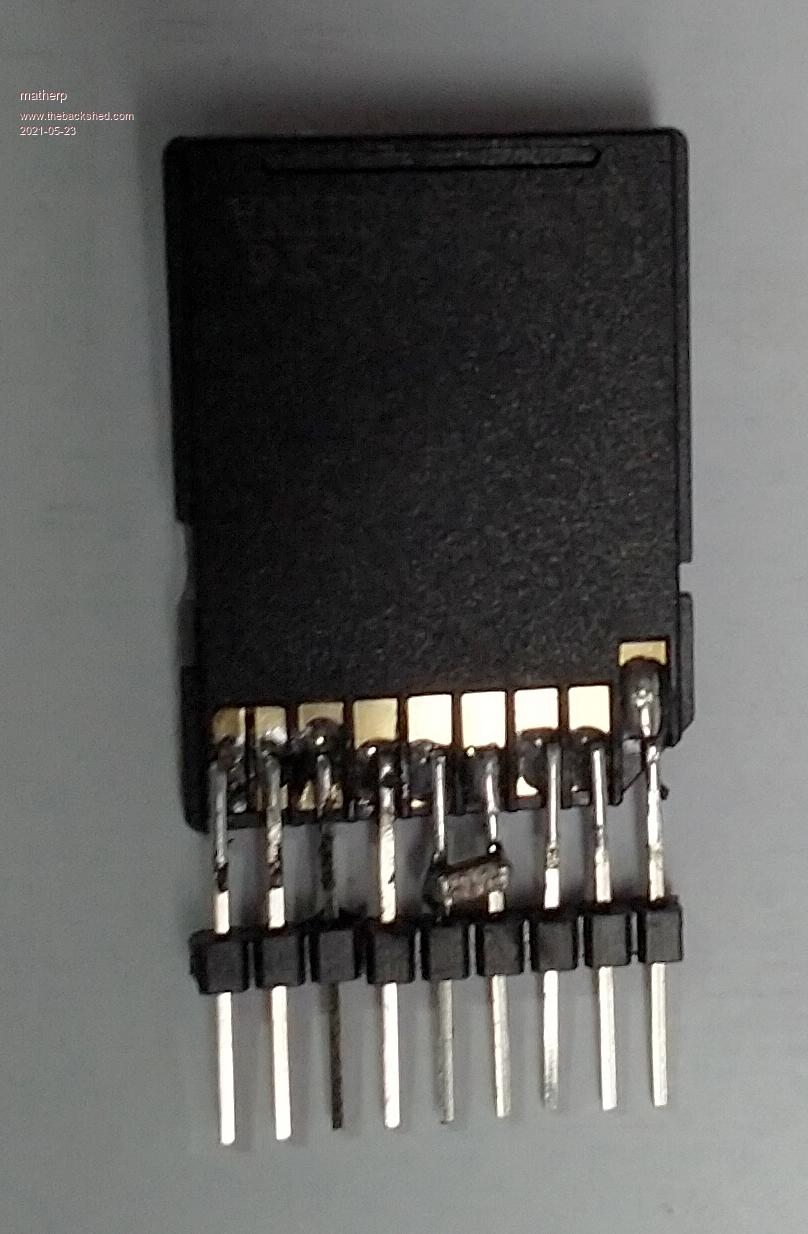

What is that holding the SD ?
NIFTY ... Whatever You have going .
Those ( Arduino and/or Micro-Circuit Python )
boards are plentifull and WAY cost effective .
If You could come up with a terminal program that
would hook up with those ( USB both power and communicate )
and allow the PC keyboard to interact with the program ....
It would be The Cat's Meow !

Posted: 05:28pm 22 May 2021
  Quote  What is that holding the SD ?
  Quote  FTDI to communicate and USB for power ?
Yes, but CDC USB is easy but the implementation looks like it may be blocking

Posted: 07:34pm 22 May 2021
Groovy .... My befuddled brain was
thinking of it (SD) having to
mechanically spin inside

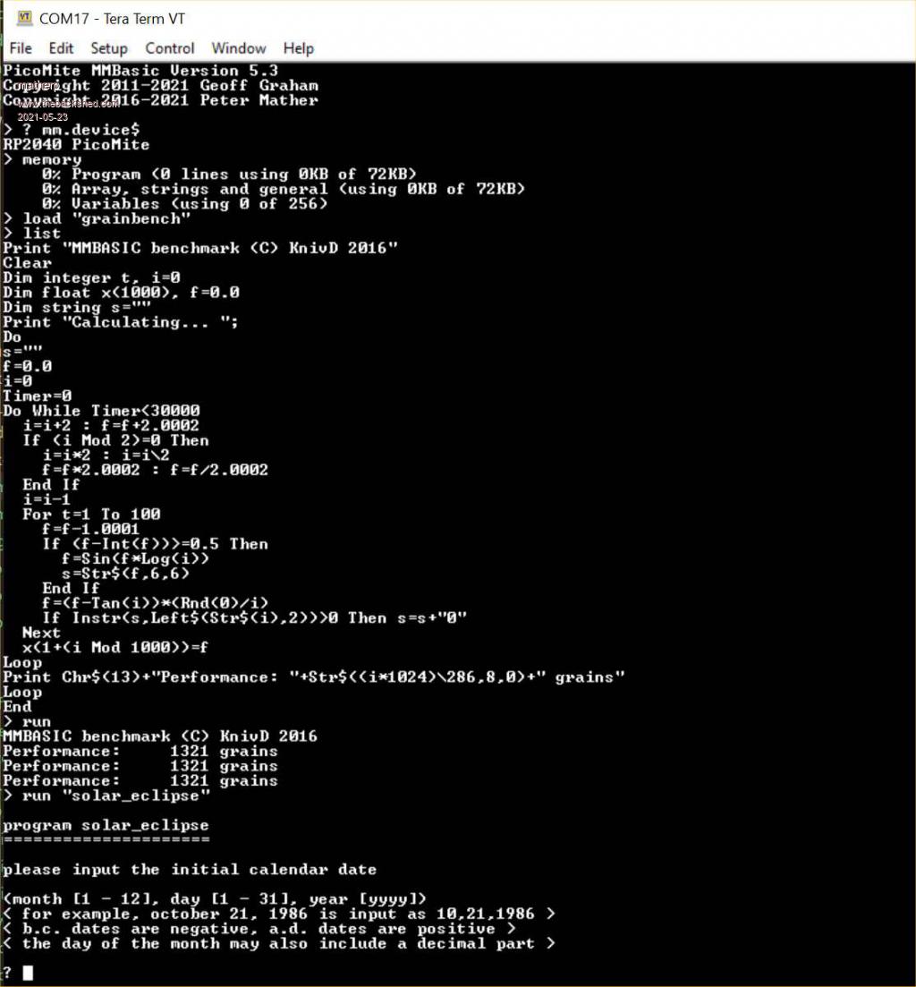

Posted: 07:54pm 22 May 2021
Good thing I just accidentally discovered my Pico today--who knows how much time I would have spent looking for it.
So many questions. MEMORY? CG's benchmark run on just about every mite so far?
I don't remember how grainbench compares with MM2, F4, CMM2.

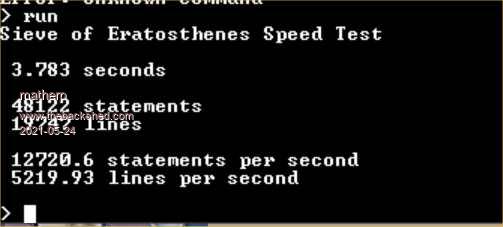

hi Peter,
   very impressive! and at a cost of around us$4 the pi-pico represents a very cheap entry point.
regarding the USB, down the track one option could be to use the second core to handle USB, while the other runs mmbasic. indeed, perhaps other I/O functions could also be handed off to the second core.
if you have a chance, would you be able to run the below speed test?
rob   :-)
Print "Sieve of Eratosthenes Speed Test"
Print
Start = Timer
10 W=500:Dim F(W):P=1:A=3
20 F(P)=A:P=P+1:If P>W Then GoTo DONE
30 A=A+2:X=1
40 S=A/F(X):If S=Int(S) Then 30
50 X=X+1:If X<P And F(X)*F(X)<=A Then 40
60 GoTo 20
DONE:
Elapsed = (Timer-Start)/1000
Print Elapsed " seconds"
Print
I = 0 ' statement counter
J = 0 ' line counter
Erase F
110 I=I+4: J=J+1: W=500:Dim F(W):P=1:A=3
120 I=I+3: J=J+1: F(P)=A:P=P+1:If P>W Then GoTo FINI
130 I=I+2: J=J+1: A=A+2:X=1
Print ,P Chr$(13);
140 I=I+2: J=J+1: S=A/F(X):If S=Int(S) Then I=I+1: GoTo 130
150 I=I+2: J=J+1: X=X+1:If X<P And F(X)*F(X)<=A Then I=I+1: GoTo 140
160 I=I+1: J=J+1: GoTo 120
FINI:
Print I " statements"
Print J " lines"
Print
Print I / Elapsed " statements per second"
Print J / Elapsed " lines per second"
Print
Posted: 06:58am 24 May 2021
In general - seems about 30% slower than a 100MHz MM+. This is with the Basic program in RAM. Would likely be slower again if stored in the flash chip so not very impressive

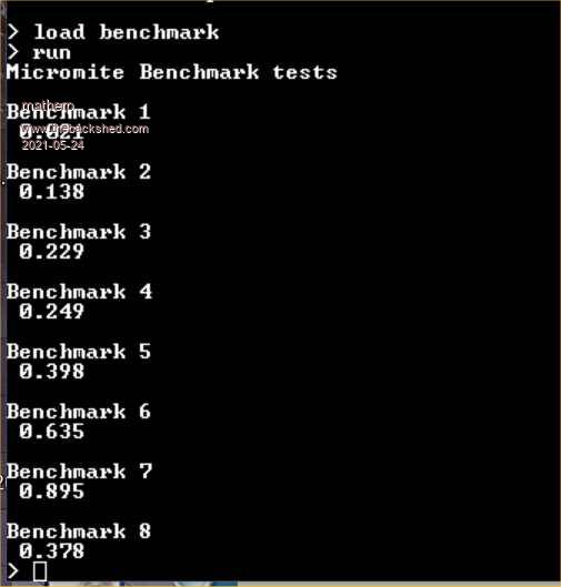

Posted: 11:54am 24 May 2021
ABC 800 single precision 0.9 1.8 6.0 5.9 6.3 11.6 19.6 2.9
ABC 800 double precision 1.2 2.2 10.0 10.6 11.0 17.8 26.4 14.4
IBM PC 1.5 5.2 12.1 12.6 13.6 23.5 37.4 3.5
Apple III 1.7 7.2 13.5 14.5 16.0 27.0 42.5 7.5
VIC-20 1.4 8.3 15.5 17.1 18.3 27.2 42.7 9.9
ZX81 in "fast mode" 4.5 6.9 16.4 15.8 18.6 49.7 68.5 22.9
Maximite 0.016 0.144 0.196 0.205 0.354 0.512 0.721 0.310
Maximite with line Nos 0.016 0.131 0.193 0.194 0.245 0.393 0.582 0.241
Maximite without line Nos 0.016 0.111 0.173 0.173 0.192 0.336 0.525 0.220
MicroMite 40MHz 0.028 0.18 0.285 0.289 0.644 0.892 1.346 0.376
MicroMite 48MHz 0.023 0.15 0.237 0.24 0.536 0.744 1.121 0.313
MX470 120MHz MMBasic 0.013 0.082 0.135 0.135 0.265 0.380 0.597 0.174
Micromite EXTREME 252MHz 0.006 0.042 0.065 0.072 0.125 0.185 0.267 0.12
STM32H7 @ 400MHz 0.002 0.02 0.034 0.037 0.062 0.086 0.129 0.059
CMM2 (400mHz-5.07.00b34) .001728 0.011814 0.019004 0.017212 0.035831 0.075413 0.02746
Pico 0.021 0.138 0.229 0.249 0.398 0.635 0.895 0.378
It looks like the Pico would make a very respectable MMBasic "starter" replacement for the 28-pin Micromite: USB programming, slightly greater speed, more pins, more memory, RTC built-in, presumably full SD card support. I bought 3 of them yesterday from the Pi Hut in the UK for $7USD including shipping to Canada.
More on the MM+ scale of things with regard to ability, and a very good price point.
Edited 2021-05-24 22:04 by lizby
Posted: 12:24pm 24 May 2021
  Quote  seems about 30% slower than a 100MHz MM+. This is with the Basic program in RAM
i'd be inclined to take more of a glass-half-full approach   :-)
                           clock          CPU          time        SPS        LPS
Micromite MX150            40 MHz        mips M4K      6.86 s      7015      2879
Micromite MX170 (Mk II)    40 MHz        mips M4K      5.31 s      9063      3719
PicoMite for RP2040        133 MHz       RP2040        3.78 s      12721     5220
Micromite MX470 (plus)     100 MHz       mips M4K      2.96 s      16257     6671
compared to an E-28 (MX170 + 16F1455) the RP2040/Pico provides:
- a 40% speed increase,
- runtime memory (59k program and 53k variables) increases to 250k (or thereabouts) shared between program and variables,
- I/O pin count increases from 19 on the MX170 to 26 (23 digital, 3 analog) on the Pico,
- available flash for the interpreter is around 192k with the MX170, while with the RPi Pico this is approximately 1.7Mb (2Mb minus a 250k allowance for a saved program),
- marginally higher current consumption - 90mA for the Pico running at full tilt, compared to just 32mA for an E-28 module,
- TCO is us$4 for the RPi Pico, compared to us$25 to us$40 for an E-28, or us$8 for an MX170 + 16F1455 pair of chips.
i would certainly see the Pico as a good candidate for a Mk III version of the MX150/MX170 line of micromites.
rob   :-)

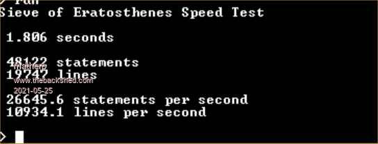

Posted: 03:39pm 24 May 2021
This is better
Now running with a USB console @ 250MHz
Edited 2021-05-25 01:40 by matherp
Posted: 04:26pm 24 May 2021
what is the current consumption (using serial console) at both 130MHz and 250MHz? i couldn't find a definitive answer online, with values between 20mA and 90mA mentioned.
methinks i may need to pop into town tomorrow and pick up a few pico's
rob   :-)
