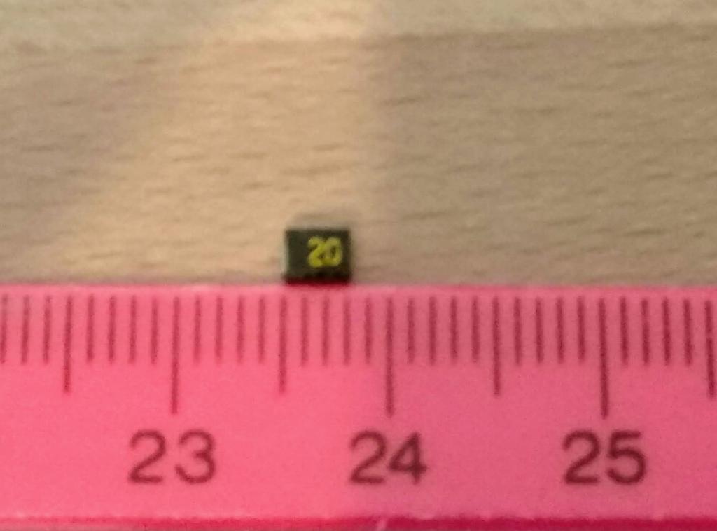

Hi folks,
I'm currently tinkering with (read as "breaking even more like an unskilled chimpanzee") an Amstrad NC 100 notepad about which internal datasheets are somewhat sparse. I need to replace a blown 0.8 amp SMD fuse and I was wondering if anyone could point me in the correct direction of, or make an educated guess as to a suitable replacement - preferably one that I can get without buying in the 100's or paying 10x more in postage than the value of the part:
The fuse I've removed - which may not be the original (scale in cm/mm):

Posted: 10:13am 05 May 2021
https://www.ebay.co.uk/itm/114763447921?hash=item1ab86f3e71:g:so8AAOSwsYpaLrCF
Basically any 1210 fuse of suitable rating or a 1206 fuse would do equally well

Posted: 10:28am 05 May 2021
Thanks Peter, and I now know what the Voltage rating of a fuse is for ;-) - if this thing gets 72V from a 6V supply I think there are other problems.
In the real world does the difference between 0.8 A and 1.0 A not matter ?
Posted: 10:39am 05 May 2021
  Quote  In the real world does the difference between 0.8 A and 1.0 A not matter ?
Not in my world but others may disagree - See https://www.youtube.com/watch?v=WG11rVcMOnY for more info on what fuse ratings really mean (or don't)

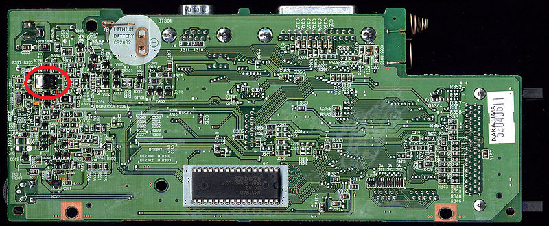

https://www.cpcwiki.eu/index.php/A_surgical_guide_to_the_Amstrad_NC

So the circled device is not a 5V regulator (it has no writing on the visible side) ?
(low-res) images of the board can be found here https://www.cpcwiki.eu/index.php/NC_Series_Mainboard_Versions, I have the NA 999-32141 Board though the arrangement of the bodge on the top-side isn't (cosmetically) identical.
Thanks to anyone taking an interest. Given it isn't just the fuse I don't have any great expectations of fixing this myself (I understand my limitations) but I'm still interested in learning whatever I can from it.

Posts: 9329
Posted: 05:22pm 06 May 2021
It may well be the 5v reg, Tom. If so it's almost certain to be a low drop out device as 1v drop isn't enough for anything like the 78xx series. Try powering it up at 6v with a 2.7R resistor (although I would prefer a 6v 2W or 4W bulb) in series and checking the pins of the reg to see what voltage is on them.
There is a group of four small electrolytics, C319-C322, on the other side. Given the age of the beastie it's worth at least checking those for any bulges. They *might* be a diode pump for the -15v supply but I'm only guessing. (your link to the pics also links to some higher resolution originals, which helps. :) )
Does the NC100 have a "power on" led or is it just the screen? If the latter then losing the -15v might make you think it isn't working.

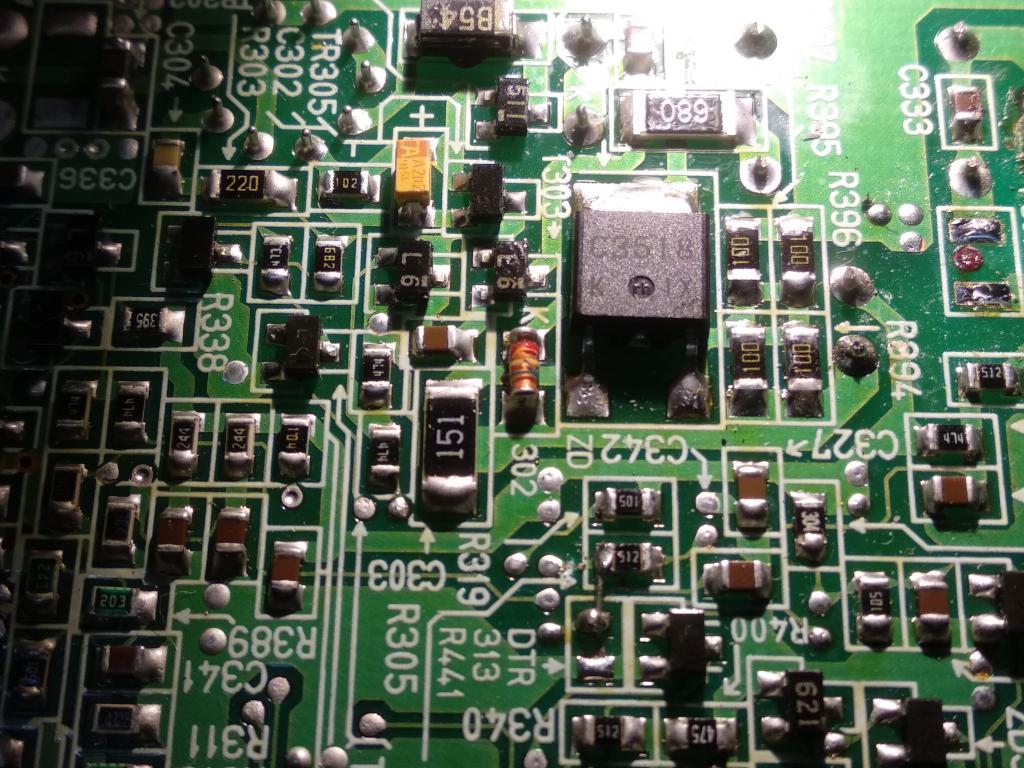

Posts: 4410
Posted: 10:16pm 07 May 2021
  thwill said  There is nothing written on the big 3 legged blob that looks like a regulator.
It turns out it was just filthy and a Q-tip and some IPA reveal it thus:
Posted: 06:52am 08 May 2021
2SC3518
