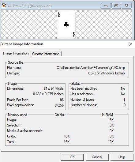

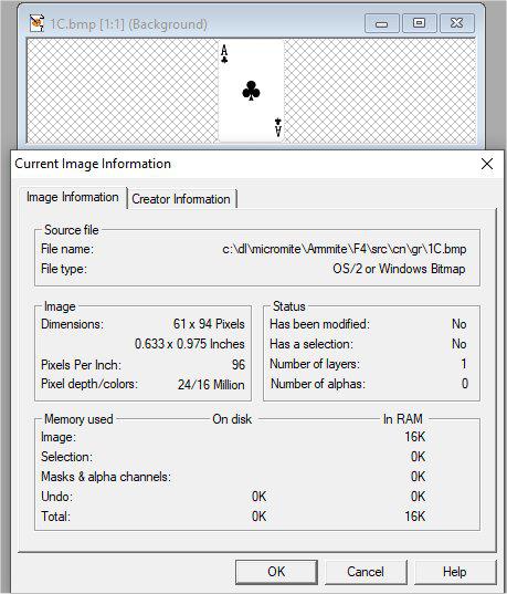

This is what PaintShopPro reports for image information--pixel depth 24:
If in PaintShopPro I reduce the color depth to 256 colors, the image displays as expected.
The manual indicates that a "24-bit true colour BMP file" should work. What is it about my first file which makes it not display? (I'll go through and reduce all 53 bmp files to 256 colors, but just wondering why the other didn't work.)

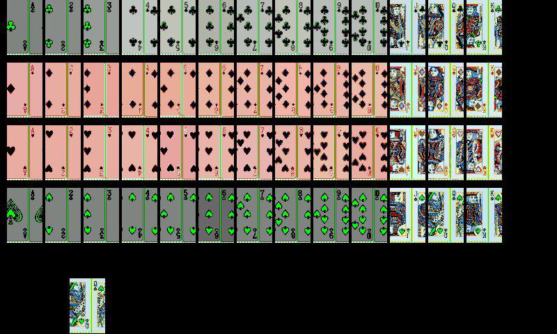

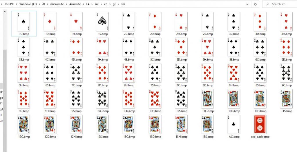

After I reduced the color depth in each file, they displayed fine on the F4, but were larger than I wanted. I resized them with GIMP. This is what they look like in Windows Explorer:
But this is what they look like when I display them on the F4 with the following code:
dim suit$(4)=("","C","D","H","S"), dr$="/cn/gr/", fn$=".bmp"
y=0: for i=1 to 4: x=10: for j=1 to 13: a$=dr$+str$(j)+suit$(i)+fn$: load image a$,x,y: x=x+55: next j: y=y+90: next i
Image files:
cards_gimped.zip
What is happening?
(PixResizer changes back to the non-displaying 24-bit BMP when I try to use that to resize.)

Something odd about the file, some bmp variant that isn't supported. Save it again with PSP as 24-bit and it works. The file is also much bigger than it should be 23K vs 17K (61*94)+ header.
Use something other than PIXRESIZER
Same issue on the CMM2 and therefore all MM variants
Edited 2021-05-02 01:01 by matherp

That's why I tried Gimp--to see if it would do better. The images displayed, but were shifted and included extraneous colors.

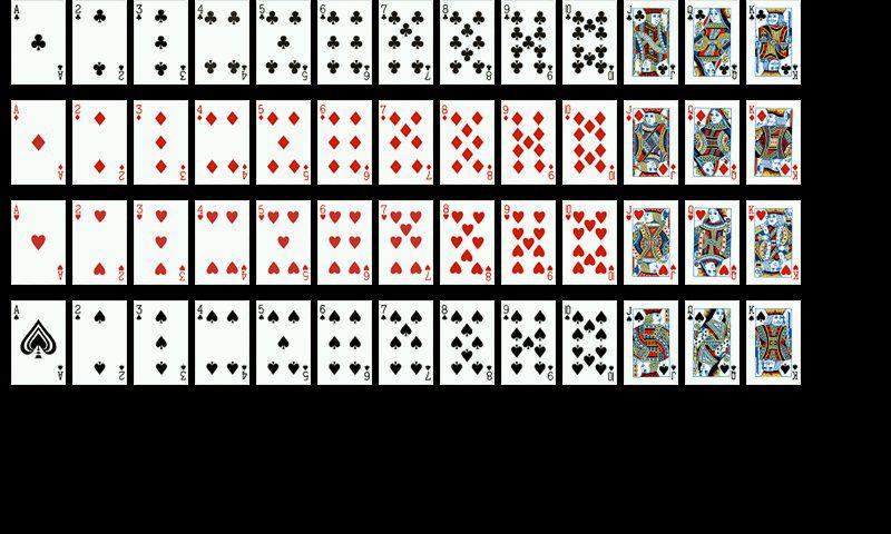

I resized again with PIXRESIZER to the final size I want, and again brought each file into PSP and reduced the color depth to 8 bits.
That worked:
Anyone have experience of another multi-file resizer I could try?

I don't care what PaintShopPro thinks, your original BMP file is 32 bit (24 plus alpha)
Windows file manager knows.
That is a common problem when converting from PNG to other formats.
One simple way to convert would be to use CMM2 to display the PNG then save as BMP.
Repeat for all files in the folder.
I don't have an easy way to bulk remove alpha.
For individual files, I open in Windows Paint and save as BMP. This gets you to 24 bit.
For bulk, I would probably write a program to do it.

I didn't reduce the color depth in GIMP. Maybe if I try again and do that when resizing, it will work with 8-bit color (which is all I need for cards--4 bit color would do).
GIMP uses a newer version of the BMP header "BITMAPV5HEADER"
Most image programs save files with the older V1 header version. It looks like MMBasic doesn't like the V5 header.
