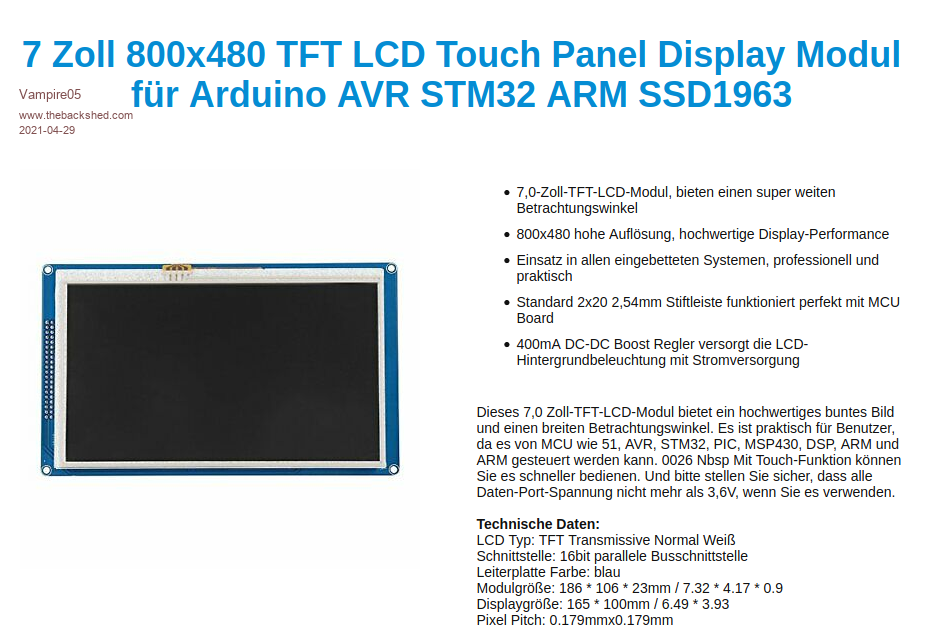

Hello People,
is this 7 inch Display 800x480 compatible with the Armmite F4 (STM32F407VET6):
it would be great to have one list with all Micromite Display Options
Best regards
Posted: 08:10am 29 Apr 2021
Yes
See my post here for details of how to wire and an adapter. Note you need a good 5V supply for the backlight
