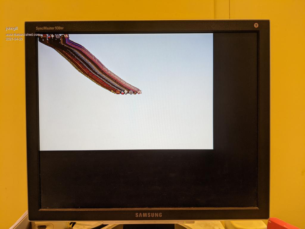

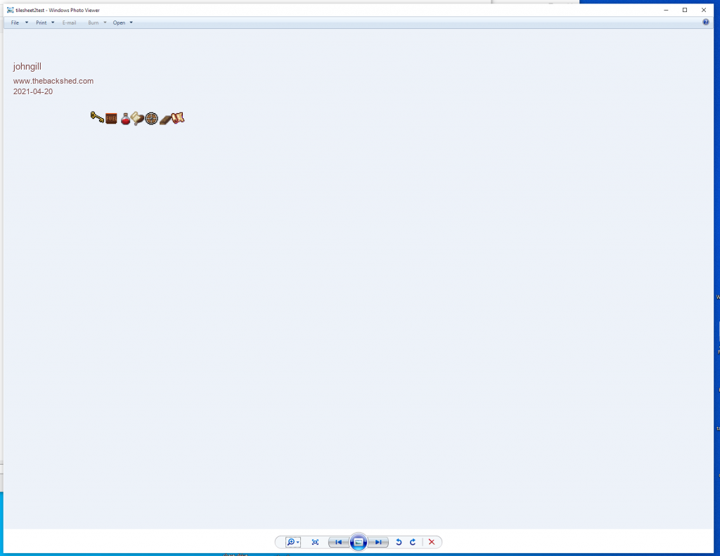

I'm trying to make a 640x400 png tilesheet for my game. I'm using corel Photopaint to export a 24 bit png with a transparent background, and it looks like this on the PC:
I've positioned 7 16x16 graphics in the top left hand corner of the sheet, and that's all it is.
But when I load it up on my CMM2, it goes absolutely bananas:
no kidding - this is exactly the same .png file.
Have I done something dumb? Is photopaint somehow exporting the "transparentness" of the png in a weird way? What can I do to fix it?! Help!

Posted: 05:26pm 19 Apr 2021
If you post the png file (zip it up) then we can have a look

PS... I'm currently running on 5.07.00 beta 19
Posted: 06:56pm 19 Apr 2021
Don't know what the problem is but I've just saved as a png using a different program (Very old copy of PaintShopPro) and now it works. I assume corel is using some feature that isn't supported by the CMM2

Sorry if it's just me being dim, but this doesn't seem to preserve the transparent background of the png - the black areas of the png are solid black rather than showing through to the rgb(80,80,80) background underneath...?
When I try opening the png up in photopaint, it shows the transparent background fine.
Any ideas???
Posted: 08:54am 20 Apr 2021
You need to specify the transparency cut off parameter
Try
load png "tilesheet2test.png",0,0,7
