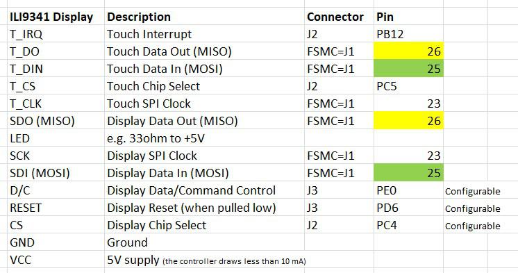

I had some problems to get LCD and touch to work. Tried first using the connections proposed in the manual on pages 39-40. Not before I used the OPTION LIST command I found the ports that worked for me.
The problems were connected to T_IRQ and T_CS, which I had to connect different from what is described in the manual. (Maybe I did something stupid during my numerous attempts to get it to work?)
