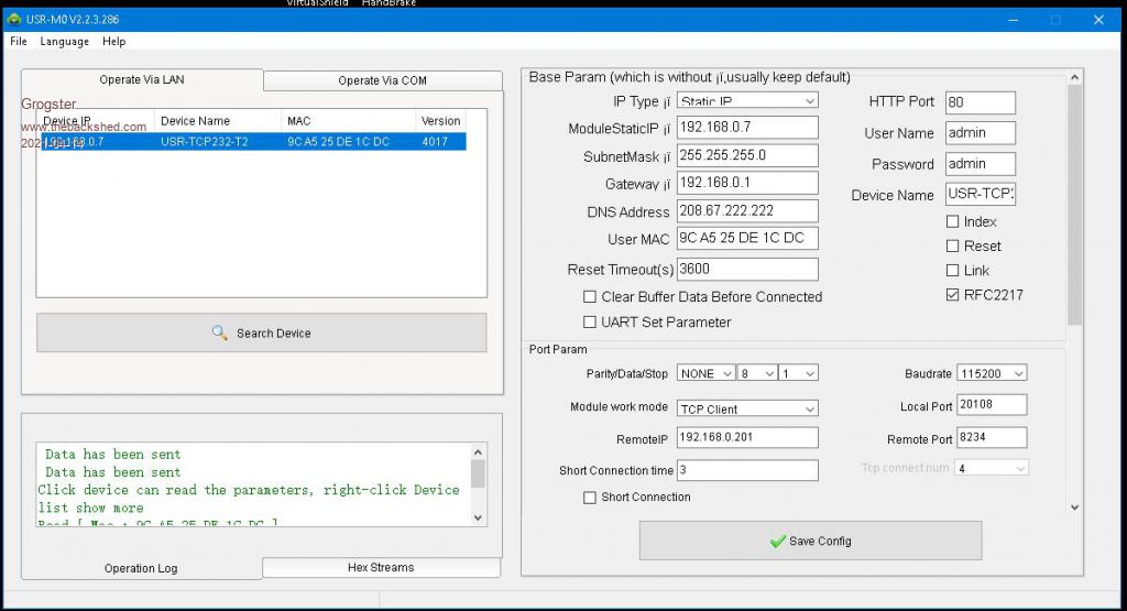

EDIT: It's definitely alive and detectable:
...but I can't PING it, and I can't talk to it via a browser.  The module has a built-in web-server for configuration which is what I am trying to use, but I could just use this for configuration I guess....
I will probably want it in the same LAN anyway, so I might change its IP address now to 192.168.1.X, and then see if I can PING it and/or load up the web-interface.

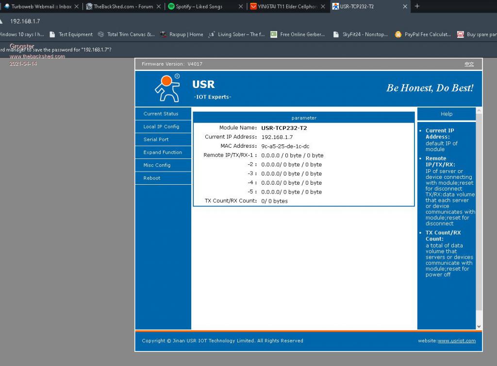

Yep, all up and running now that I put it in the same LAN:
Set the module to 192.168.1.7, and then I can PING it, AND talk to it via the web-interface.
