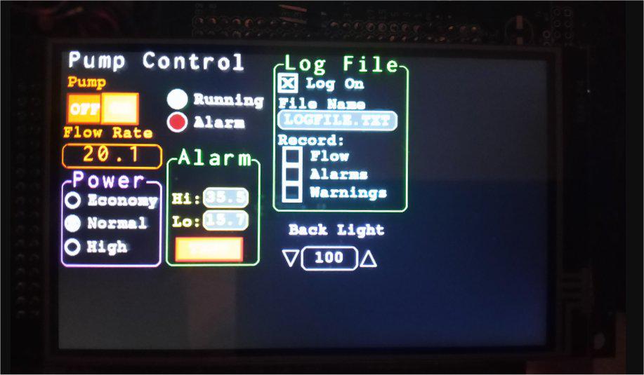

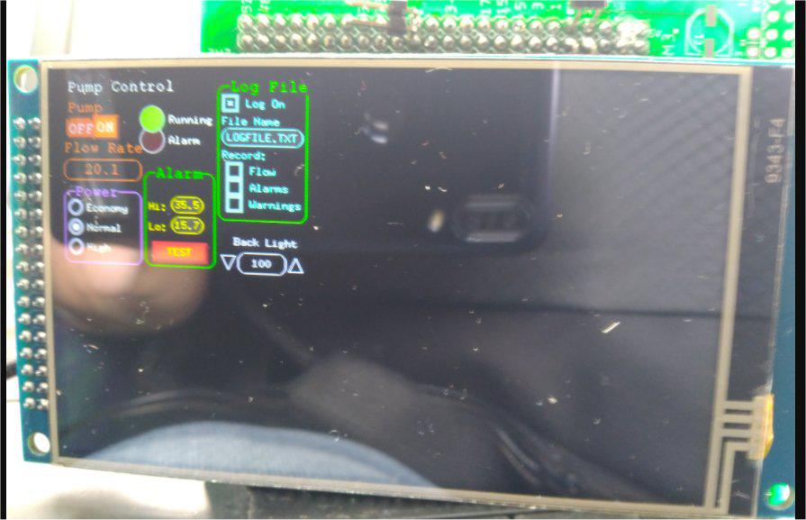

This adaptor enables you to use the 16-bit IPS/OTM8009A LCD with the F4--converting the 32 pins to the 34-pin IPS.
One anomaly I noticed--if I power-cycled after OPTION LCDPANEL IPS_4_16,L without doing OPTION TOUCH, the LCDPANEL setting reverted to the default. After OPTION TOUCH PB12, PC5 all was fine.
The image is very crisp--this photo doesn't do it justice (aside from the fact that the screen is highly reflective and in the camera, catches what is facing it--though not so noticeable when not taking a picture).

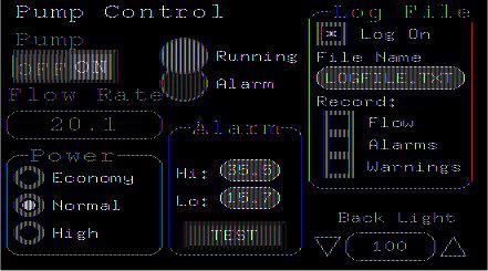

Another anomaly: SAVE IMAGE did a very poor job of rendering the screen, especially compared to the SSD1963 and other displays.

Hi Lizby,
It looks like the colours are not being mapped properly when doing the save image. I will see what it does for me.Its saving enough pixels, just not the correct colours.
Do you have the pump controller demo converted to run 480 * 320. If so can I have a copy to reference for the manual.

Here's the 480x320 version. I basically increased all the X,Ys and the widths and heights by 50%, and changed font 1 to font 4 and font 2 to font 5. And then fiddled to adjust.

Gerry--I need the "REFERENCE.BMP" file to complete the test.
Interestingly, the right-hand flicker I am seeing at times appears in the test only at backlight levels 70 and above.
Attached is zipped  test.bmp from the run.
test.zip
(The 480x320 guidemo program above shows no right-hand shadow flickering when BACKLIGHT 50 is added at the beginning.)
I'm running off of USB on a laptop. I have it plugged into an in-line current monitoring module. That shows 240mA when the backlight wasn't set, 140mA when it is (with my F4 hat PCB also plugged into the F4, but with nothing connected to it..
Edited 2021-04-14 23:18 by lizby

  Testing GETSCANLINE() Range
             TEST RESULTS
LCDPANEL        IPS_4_16
LCDPANELID      0
Size     800    x        480
LCD ID1         51
LCD ID2         B8
LCD ID3         C0
Pixel write/read by gradiant FAILED!!!!!!!!!! 8072 pixels
Pixel blit  by gradiant FAILED!!!!!!!!!!!! 9998 pixels
Pixel write/read for all bit X transition FAILED!!!!!!!!!! 10000 pixels
Pixel blit for all bit X transition FAILED!!!!!!! 10000 pixels
Pixel write/read for all bit Y transition FAILED!!!!!!!!! 20000 pixels
Pixel blit for all bit Y transition FAILED!!!!!!!!!! 10000 pixels
LOAD IMAGE  and test pixels FAILED!!!!!!!!!!! 8072 pixels
SAVE IMAGE then LOAD IMAGE  and test pixels FAILED!!!!!!!!!!! 9999 pixels
TRANSPARENT TEXT tested - Check on display if OK
GETSCANLINE() Range      0      -        771
disco4now
Joined: 18/12/2014
Posts: 1162
Posted: 01:48am 15 Apr 2021
A little correction to test code above.
The counters are not reset before the bit test by Y axis
The red line needs to be added.
? "Bit transistion test"
? "by Y and re read of pixels."
? "writing ",tp," pixels..."
cls
s=0:t=0:i=0
timer=0
F4 H7FotSF4xGT
disco4now
Joined: 18/12/2014
Posts: 1162
Posted: 02:03am 15 Apr 2021
  lizby said
             TEST RESULTS
LCDPANEL        IPS_4_16
LCDPANELID      0
Size     800    x        480
LCD ID1         51
LCD ID2         B8
LCD ID3         C0
Hi Lance,
I think you have a display based on the NT35510 chip. I don't know of a way to see this physically as both displays look the same.
I have tried my NT35510 using the OTM8009A driver and it sort of works with similiar problems you are seeing.
i.e. colour bleeding down the right hand side, incorrect pixels read back. The pump controller displays but with a few glitches.
The scan lines coming back as 0-771 match my NT35510 as well.
           Your IDs.          My IDs
LCD ID1         51               55
LCD ID2         B8               BC
LCD ID3         C0               C0
I test for the 55 to identify the NT35510. Looks like we might need to accept 51 as well. I will see if Peter will do an update that will accept either the 55 or 51 to indicated the NT35510. I can't think of a way to test it without getting a new bin file.
Gerry

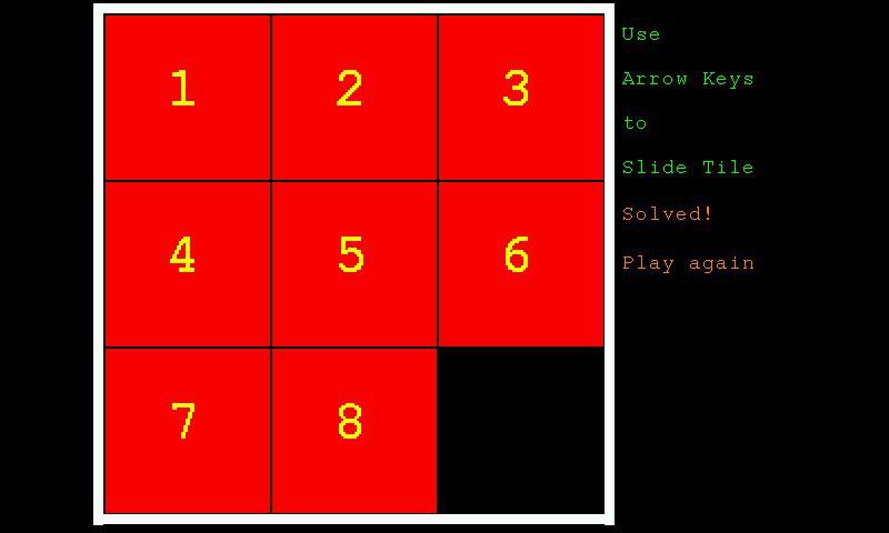

See sliding tile game for an F4 game/puzzle for this LCD.
