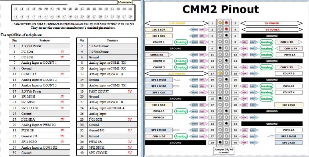

If it's been posted, I didn't note it. I'm looking for a chart or spreadsheet listing the GPIO pin names and/or numbers for the 20x2 40-pin GPIO connector. Something which supplements these:
I'm trying to replicate something like what I'm using for a GPIO PCB for the F4:
I have a vague recollection that something like this has been posted, but I can't find it.

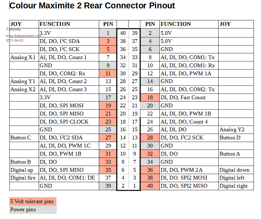

I posted this during the discussion on joysticks. I can upload it as a doc or spreadsheet if it is of any use?

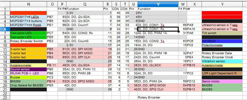

Thanks, Bill and Peter. I'm pretty sure I had something like Bill's posting in spreadsheet format, and that was what I used to produce the provisional F4 layout, but I can't find it. I2C, SPI, COM1 and COM2 are in the same place, but there were fewer ADC available on the F4, and I don't think I was able to get all the PWMs.
I'll use that as a template with Peter's master and will post the spreadsheet doc.

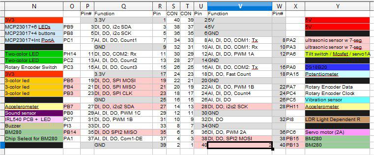

Here's a shot of the spreadsheet with the pin names. Since I've been working with the F4, I had forgotten that the CMM2 pin numbers are the same as the 20x2 connector pin numbers.
