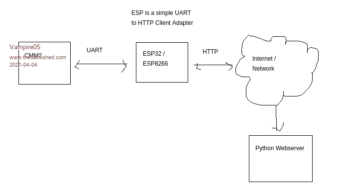

I think I have a smart idea for backup from CMM2, Micromite and other MCUs. I am trying this out at the moment.
My idea is to make a backup over the internet/network:
First the CMM2 needs internet. This is very easy to solve for this case. With an ESP32 / ESP8266 I build a SERIAL TO HTTP adapter:
The ESP listens on the UART and knows the following commands:
- Connect_to_wifi(SSID, PW): -> IP Address       // connect to your wifi
- http_get(URL): -> HTTP Response                // send a http get
- http_post(URL, BASE64_DATA): -> HTTP Response  // send a http post
- b64_encode(data): -> B64 String                // encode data to b64. easy on ESP
- b64_decode(b64_string): -> data                // decode b64 to data. easy on ESP
With this you can already communicate to the internet. An universal HTTP Client for all UART Microcontrollers
On the other hand a very simple Python server can receive the following things :
POST: http://...server-url.../save -> {"filename": "test.bas", "filecontent": "...BASE64 DATA..."}                        //save file on server
GET: http://...server-url.../list           //list all my files
GET: http://...server-url.../load?filename=test.bas      // get the filecontent of test.bas
Now you could create a script in mmbasic, which sends the appropriate UART commands to the ESP!

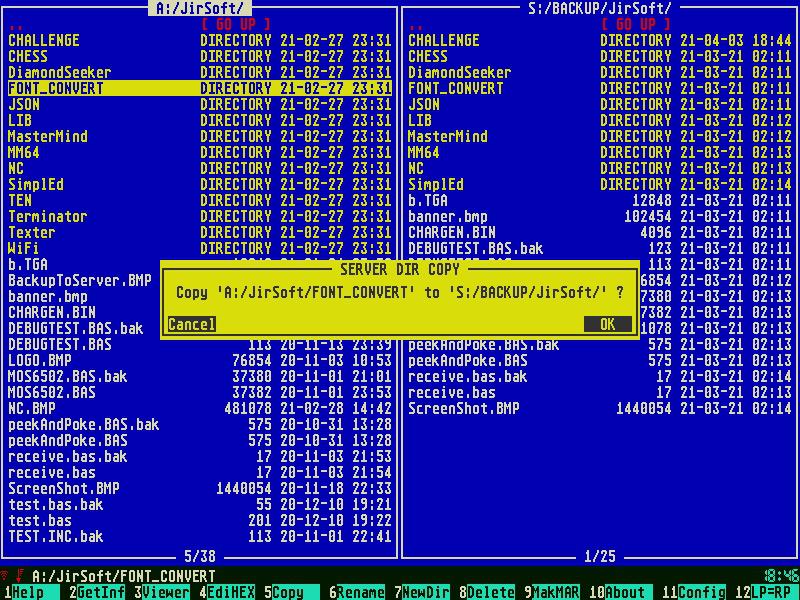

On CMM2 with Napoleon Commander you can copy between local files on SD and remote files on server (Python). Server can run for example also on NAS...
Edited 2021-04-04 02:49 by jirsoft
Jiri

@jirsoft woow, super nice soulution    Backup Problem solved for CMM2

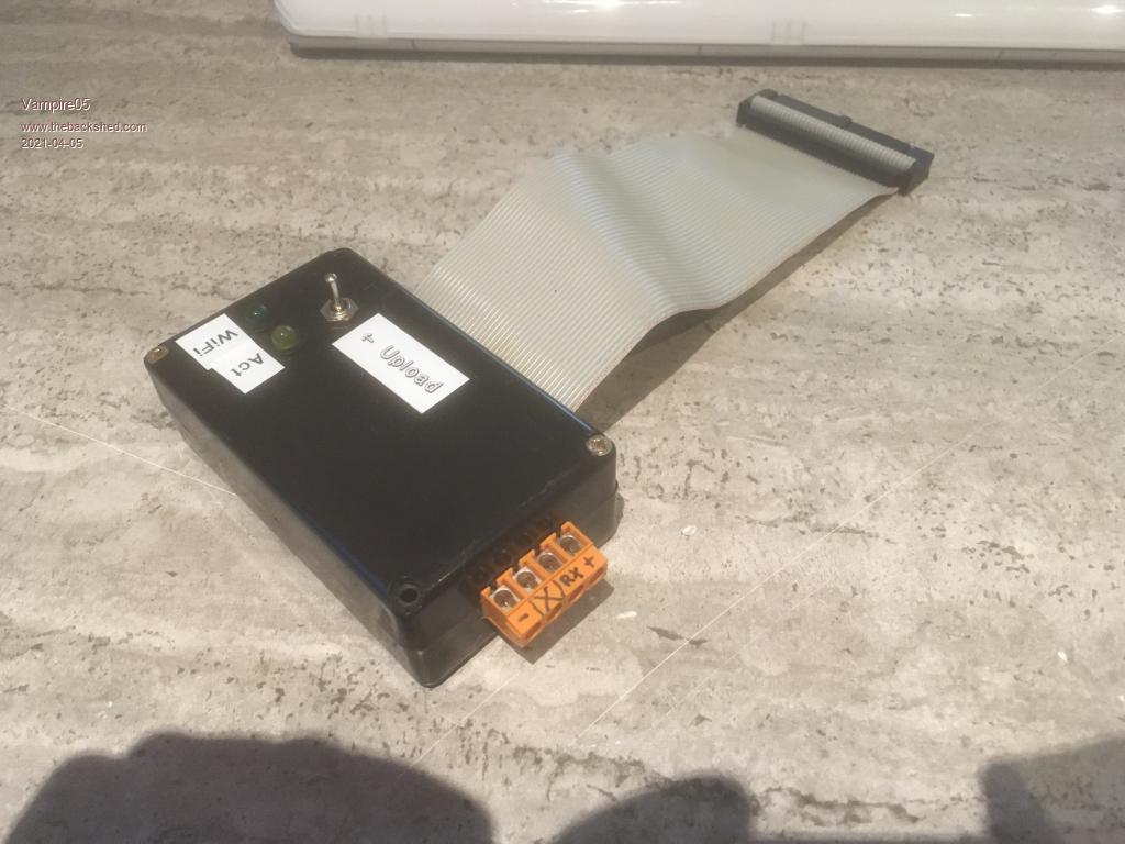

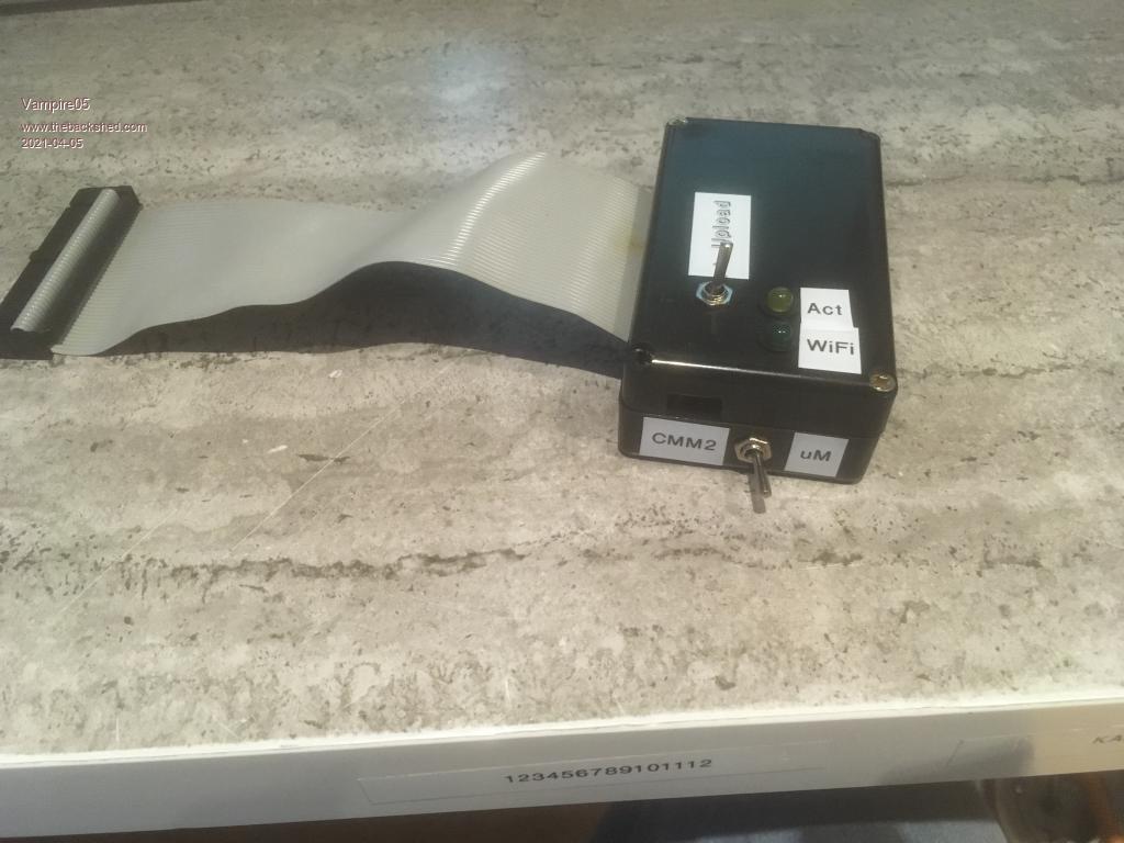

Ok, i have finished the UART to HTTP Adapter (communicates to my own Server). For the Micromite it can only Backup files to Server with "LIST ALL" Command. For the CMM2 it has an interface to LIST, SAVE and LOAD files from my own server. Now i need to implement a driver (.bas file) for CMM2 to interface it. When i am finished, i make a video

Here is a Video of my Micromite and CMM2 Backup Solution:
Micromite Backup
CMM2 Backup
