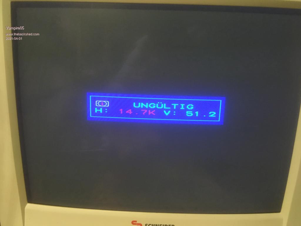

Hi guys, I have a problem with my new original Maximite Color. I soldered everything cleanly, but when I turn it on, my monitor tells me there is a sync error   . I have tried several monitors and power supplies. Always the same. Where could the error be?

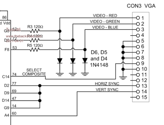

You could also check the soldering around this part of the circuit - to the VGA connector and the chip.

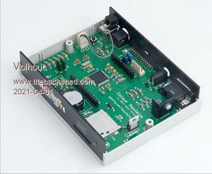

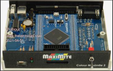

Hi Vampire05,
Did you build a "Color Maximite", or did you build a "Color Maximite 2" in original configuration (with the Waveshare board on top) ?
Color Maximite
Color Maximite 2

Vampire05
Joined: 06/12/2020
Posts: 88
Posted: 09:40am 01 Apr 2021
First of all, thank you for your help!
@Volhout: I have the original Maximite Color (first version).

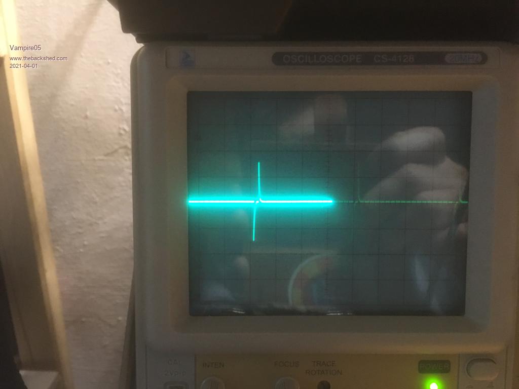

@Geoffg: I checked the Crystal with the oscilloscope: I checked Gnd<->Left crystal pin and also Gnd<->Right crystal pin. One pin has a higher Level than the other one. Thats strange???? I have ordered a new 8MHz Crystal.

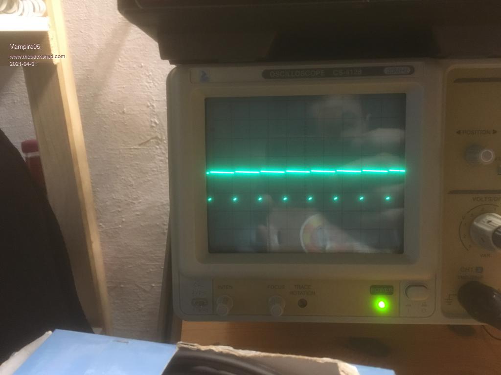

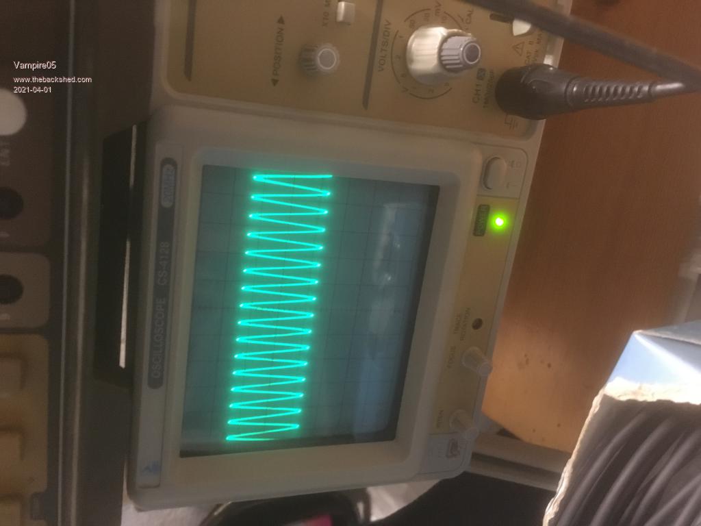

Here some images. The error: Invalid Horizontal: 14.7 K
The Crystal:
Pin13 and 14:

Hi Vampire05,
Good that you can show these pictures.
I cannot see what scale they are but the lower picture definitely looks wrong. It should show logic levels and only the edges are shown on your scope.
Are you sure you are connecting this to a VGA input of a monitor. I have only once in my life seen such behaviour, and that was when I connected a logic signal to a SVHS C input (the color pin, not the luminance pin). There was an internal bandpass filter in the monitor that cause this behaviour.
So I expect somewhere there is a short circuit. Either in the cable, or in the board associated with pin 14 (vertical sync).
Please note with each picture the horizontal and vertical settings. Is the crystal running at 8MHz (125ns period)?
I have a color maximite like yours, and will confirm the horizontal frequency tonight. I am at work now. Maybe your monitor is confused because the corrupted vertical sync.

  Vampire05 said  Here some images. The error: Invalid Horizontal: 14.7 K
There is the clue.  It is outputting PAL composite video.
Your monitor must be grounding Pin 9 of the VGA connector.
This is mentioned in the Frequently Asked Questions (https://geoffg.net/MaximiteFAQ.html ) as follows:
  Quote  The Colour Maximite uses pin 9 on the VGA connector to switch to composite video timing, unfortunately some VGA monitors (predominately HP monitors) ground that pin and so the Maximite is forced into composite video when such a monitor is attached.  The solution is to upgrade to the latest version of MMBasic which, by default, disables composite video.  See the Maximite Hardware Manual for details of how to enable composite video if it is needed.
You can also cut the PCB track to pin 9 but upgrading to the latest version of MMBasic is a better option.

Vampire05
Joined: 06/12/2020
Posts: 88
Posted: 03:12pm 01 Apr 2021
@Frank ich komme aus Guetersloh (naehe Bielefeld) ;-)
@Volhout / Geoffg: unfortunately cutting the track to pin 9 did not help, but the update was the key. Now it works guys
