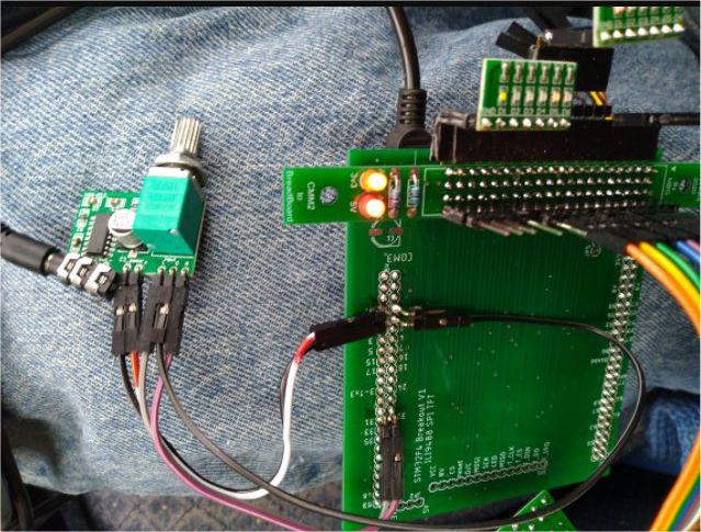

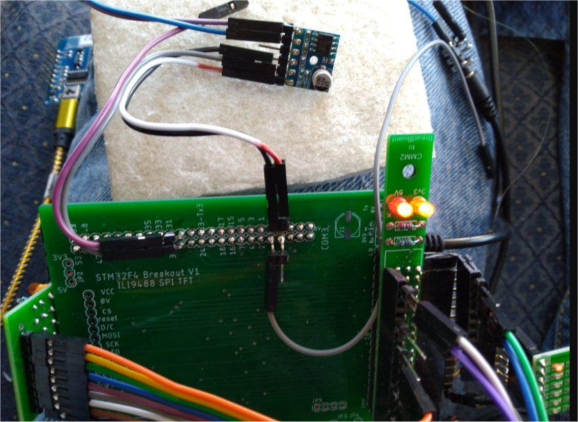

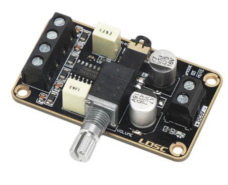

I've tried a number of Aliexpress amplifier modules with differing results. (I understand that PLAY VOLUME L,R works for volume control.)
1) As I noted before, with this 5W amp , powered from F4 5V, it reboots the F4 if powered on, or if the volume is turned up too far, but plays ok if turned on at a low setting and volume control on the module works in a low range. This is two-channel.
2) With this two-channel PAM8406 amp, power on (3V3) and off works, audio is good from just a nudge above on through about a fifth of the nob turn range (about as loud as I'd want it anyway). Above that, it starts to sputter. This is the best fit of the ones I've tried.
3) This is a single-channel amp, and works ok with the pot turned up about 9/10ths of the way clockwise (3V3 power). Within a narrow range, the pot controls volume, but outside that range the sound is either off or very noisy.
Of these, #2 works best, but needs to have a mini-stereo socket added.
I've also ordered some of these, also PAM8406-based--needs mini-stereo socket but perhaps better layout for F4 add-on with F4 volume control.
If anyone has experience with other F4 audio output modules or circuits, please share.
Posted: 08:36pm 28 Mar 2021
I expect that you are over-driving the amp.
From the datasheet for the PAM8406
  Quote  One should not make the input signal too large. Large signal can cause the clipping of output signal when increasing the volume. This will damage the device because of big gain of the PAM8406.
How are you powering the modules or are you taking power from the F4?
Without seeing the circuit for the modules and your interface, it is hard to comment further.
Posted: 11:38pm 28 Mar 2021
  TassyJim said  How are you powering the modules or are you taking power from the F4?

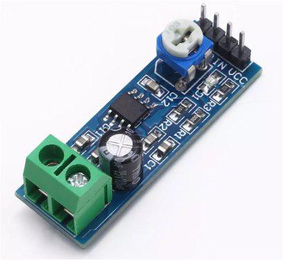

I'm not dissatisfied with the performance of the 2nd PAM8403 (I mislabeled it as a PAM8406). First module was powered with 5V from the F4 (I didn't try it, but after trying the other PAM8403 I'm guessing it would work with 3V3). The other 2 were powered with 3V3 from the F4.
Inputs to all three modules were direct from the F4 DAC pins, 29 & 30 (PA4 & PA5) (or with the LM386 amp, first one DAC output and then the other). With volume control on the F4, there's no need for it on the amp module. I was just noting where in the pot range the sound was OK. I'm sure at the high end it was being overdriven--and the 5W module was way overkill for the headphones and, without a separate power supply, for the F4.
I was somewhat surprised that the pot range was so narrow on the LM386 single-channel module--but I know nothing about amps and the analog circuitry for them in general.
I had wondered what the minimum circuit was to get acceptable headphone music (and my attempt at Volhout's circuit failed, so I don't know about that), but at $.75 plus shipping of $1.29 Canadian for the PAM8403 with pot ($.45 without), it doesn't seem worth it to add components to my PCB.
Edited 2021-03-29 09:43 by lizby
Posted: 05:03am 29 Mar 2021
I will admit I am a long way out of date with my headphone knowledge but I thought they all would have a common ground for left and right channels.
The PAM8406/3 are differential outputs so you can't just tie the -ve outputs together.

Posted: 08:42pm 29 Mar 2021
  Quote   how wrong can I go?
Unless your headphones have separate ground returns, you should NOT use the PAM8403 modules.
You will be shorting the 2 channels together which is OK for true mono but can be a disaster when the right and left are different.
The LM386 module you refer too looks the same as one I have used on a few occasions.
As delivered they have a gain of 200 but that can be reduced to 20 by removing R1, the zero ohm resistor.
For the F4, I would put a ~10k in series with a ~0.47uF capacitor in the input and run it of 9-12V. The minimum for the LM386 is 4V but 9 is much better.
The series resistor in conjunction with the 10k pot will allow you to bring the overall gain to between 1 and 2 which will be about right for ear busting levels.

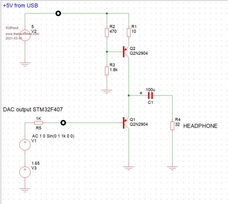

Posted: 08:25am 30 Mar 2021

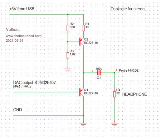

For those who like breadboarding, this is a class A buffer for headphones that should work fine with the F4. 6 discrete components per channel (12 for stereo).
It drives a 32 ohm headphone to max 3Vpp.
A stereo pair of these buffers draws 90mA from 5V.
The transistors can be any generic PNP (i.e. BC558, 2N3906).
Edited 2021-03-30 18:27 by Volhout
Posted: 11:05am 30 Mar 2021
Thank you for that. What does the part of the circuit above the junction to the 100u cap do?
Also, what is the meaning of V1, V2, and V3?
Posts: 6254
Posted: 11:58am 30 Mar 2021
Hi Lizby,
In my profession as hardware engineer I tend to design electronics circuits in computer simulation using component models, and basic building blocks.
The schematics shown above is the simulation model.
This simulator does not know an STM32F407, therefore I replace the F407 analog (DAC) output with voltage sources. These are theoretical models, without practical limitations (so a 5V source (V2 above) can deliver 100000 A without voltage drop).
V1 generates a sine wave 1Vrms (2.8Vpp) around 0. To bring this in line with the actual DAC output, and offset of 1.65V (half of 3.3V) is added by V3. R1 simulates the DAC output resistance inside the F407.
The buffer is a very simple emitter follower (Q1) using a PNP transistor to bring the DC level from 0V...3.3V to 0.7V...4.0V (around the center of 5V, to avoid clipping).
Since there is no feedback path in this amplifier/buffer distortion depends on the linearity of Q1. The upper part of the circuit (Q2, R1,2,3) is a simple (~40mA) current source. By keeping the current through Q1 as constant as possible, linearity is best.
I also designed this amplifier for my own use. I need it for my handheld Tetris game based on an F4. The 40mA is much current for a handheld device, but so is LCD backlight. My Tetris sound is mono, so I only need a single buffer.
Volume control is done using the software volume control in MMBasic.
Edited 2021-03-30 22:05 by Volhout
Posted: 01:20pm 30 Mar 2021
Volhout--thanks very much for the explanation. So much to learn about this stuff.

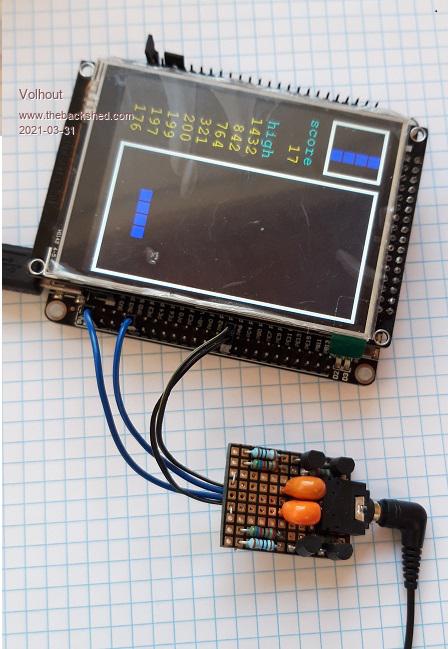

For those who want to breadboard the circuit I provided 5 posts earlier, I have an update. The circuit is build, and tested, resulting in a few minor changes.
1 resistor value is changed, to ensure 40mA current. The transistors are BC327 or 2N4402 parts (have higher gain at 50mA) to improve linearity.
I have made one observation, testing with different computers.
On a 2021 laptop (Lenovo Thinkpad with i9 processor) running W10 there is a lot of noise in the audio. On a 10 year old HP Probook 4510, the audio is clean, almost no noise.
For diagnosis I tried powering the amplifier from the F4 3.3V on the Lenovo (from a linear regulator), but the noise remained. Tonight I will check with a scope if this is from the 5V from USB, or if it is something in the F4 board.
Additionally I will try to find out what the best audio format (quality wise) is what the F4 can produce (matherp ?) and encode some CD music in that format, to test the audio quality.
The build configuration (veroboard):
About volume settings: I can confirm that on VOLUME 100,100 the audio will deafen you on the pair of earplugs I am using. VOLUME 10,10 is better suited for intense listening. If you need background audio, VOLUME 3,3 is better. And that is why the noise on the Lenovo laptop is annoying.
So the saga continues....
Edited 2021-03-31 16:56 by Volhout

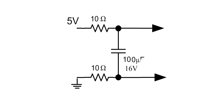

Extra low pass filtering on the input and 5V supply may help with the noise a bit, however much of it could be on the ground return. The usual cure for this is to take your ground wire directly to the analogue ground ref. pin on the processor. I think this is pin 20, though the junction of C23, c24 & R35 would be easier to solder to.
If that is too difficult add a 10 to 33 ohm resistor between supply ground and your decoupling capacitor.
