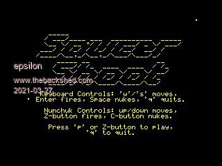

Included in the code base is a little demo game using the game engine. Here's a potato quality video of me lasting a whole 5s in the game:
Video clip: https://youtu.be/3-vFXHYETiM

* SaucerShooter/ A demo mini-game used to demonstrate most of the features of the game engine.
SaucerShooter also serves as my benchmark for performance tuning:
 *ss_game: Starts the game
 *ss_game L: Starts the game and displays the game loop timing in the upper left corner.
 *ss_game F: Starts the game with frame rate limiting disabling and xProfiling enabled (ref. https://github.com/epsilon537/xprof_cmm2  for more info on xProf).
