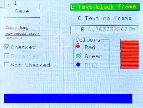

Morning everyone.
Just wanted to share my current "spare time" project.
I have put WindowsCE/95-a-like GUIs in a lot of my projects on the smaller MicroMites that dominate my work. Larger 'mites (MM+, ARMMite etc.) have a GUI built into the firmware but size restriction on the Mk2 mean if you want a nice touch-screen display you have to build it yourself - and I have... from scratch, every time, resulting in rigid un-portable code.
I have had some interest from other users on how I did it and it seems to surprise everyone that MMBasic is quite capable of producing a responsive display on these smaller machines. Not a CSUB in sight - which is my aim because I want portability between the 'mite platforms.
So I have put together a more inclusive pack that you can simply insert in your code, a tiddly bit of config and start plopping your screen elements on the LCD panel and using them. It is about 10K at the moment - you can chop out the code for gadgets you won't be using easy enough, but I often had 6K of monolithic code for a far less capable GUI, so I don't consider it too much of a "waste". YMMV
For now, the main screen service routine is polled and returns the number of the object touched or -1 (nothing). It has proper handling of enablement, visibility, grouping of radio buttons etc. Please remember it is very much a work in progress and there are some bits missing but I think these are the not-used-as-much bits. I just wanted to get it out there for critique.
Note: I always poll for touches in the main loop of my code and the example code shows this. It wouldn't be a big task to do a touch interrupt handler with a wrapper to call the touch processor if that is your thing.
Main article (detailing how to use it with example) and code is here
Comments in the code are a bit thin but I will do a better job as releases occur.
Screen grab is a bit bleached out but you get the idea.
enjoy

Excellent! I have just tested with
1) Standard 44 pin MicroMite (Micromite MkII, firmware 5.0502) using a ILI9488 display.
2) Micromite Plus 64 pin, version 5.0502 using a ILI9341 display.
Plug and play with both of them.
This will enable me to make my hobby projects look more professional and be more functional. Usage of your code will definitively require some training. Looking forward to see more about your spare-time project!

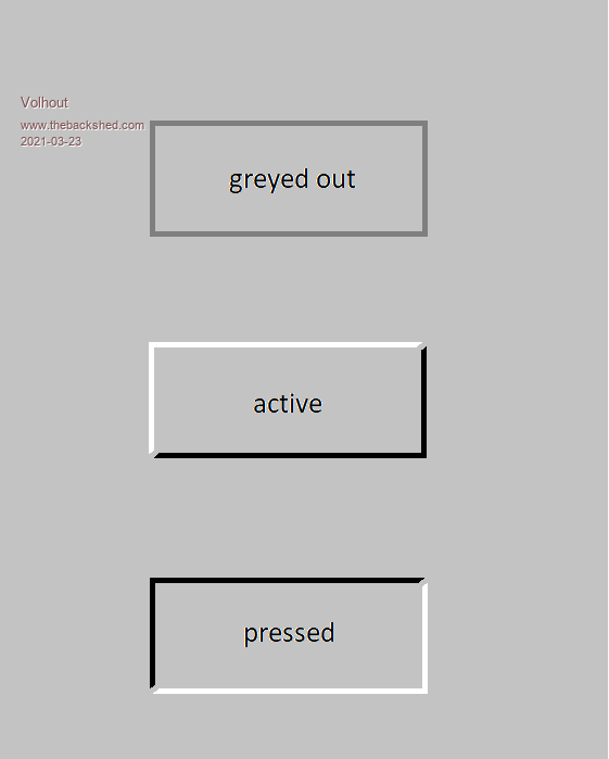

Posted: 12:08pm 23 Mar 2021
Looks promising for the MM2 devices. Could we load this as a library ? So it becomes part of the MM2 until we erase it purposely ?
The "frame" around some of the gadgets is a bit unlike W95. In your description you mention you still have to add it to some gadgets. Maybe you shouldn't...

Posted: 12:18pm 23 Mar 2021
  Volhout said   Could we load this as a library ? So it becomes part of the MM2 until we erase it purposely ?
yes you could load it and LIBRARY SAVE it without issues. if you wanted to get really clever you could them read the hex back out of the MM and save it as a custom build - I have done that with some production MMs I fitted in ceiling roses over snooker tables
It's all flexible - the border and alignment section I just added to the wiki explains it. You could have a button with no border at all if you wanted that.
The Frame (around the radio buttons) isn't part of the radio buttons - it is a distinct object with the radio buttons simply positioned inside it. In the code int he wiki, it is object 39. When drawn it will erase the area inside so if you want anything in it  you must draw the frame first - in the code example other wise it will erase the radio buttons.
I will definitely take on board suggestions like this though. it's got to be useful Someone has already pointed out there may be a problem with the progress bar because of the INTing nature of the scaling, e.g. if the extremity is 5000, 4999 is very close but in jumping at steps of 100, you you see 4999 as 4900. I need to look at that but for now I want to get the gadgets working and the fine tune comes later

Posted: 12:22pm 23 Mar 2021
I always used it and never wondered how they did it, but it is so simple.
W95 buttons....they only redraw the contour. The button text can even be part of the canvas... Never knew that...
Thanks for razing my curiosity.

Posted: 12:26pm 23 Mar 2021
  Volhout said  I always used it and never wondered how they did it, but it is so simple.
ha! yeah. As I explained to another shedder "it doesn't take much to fool the eye"
This is an ultra simple example of what the French call "Trompe-l'oeil"

Running your demo program I get these speed indications:
-Mk2 shows R 0.833167ms
-Plus shows R 0.587412587ms
-In your picture above R 0.2677322677ms (suppose it is F407).
Both Mk2 and Plus has fast response to the touches. (Using your demo program.) Will be interesting to see how it will be in "real" applications with more processing besides the GUI.

  Pluto said  Running your demo program I get these speed indications:
That is good to know. Thanks (those numbers don't actually mean anything). More often it is perception to how the interface works that is important. So long as the user feels their request has been immediately acknowledged, they are seldom bothered too much if it takes a moment to actually do some work.
Yes, the response is directly a function of how often you poll the screen. If your main loop is just zipping round waiting for things to happen dropping in a call to the touch processor will probably be fine. If it gets to be a pain then an interrupt would probably be best - only thing I see there is waiting for the touch to go away (WaitNoTouch) would be operating inside the ISR... not ideal.

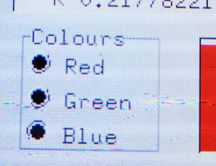

Playing with the test program a little bit on an F4 with SSD1963_4_16, and I like it--very clean-looking.
One thing I notice--perhaps it is because the the radio buttons are themselves red, green, and blue, but it's difficult to tell which one is selected.
Very nice work on the FruitOfTheShed documentation, too.

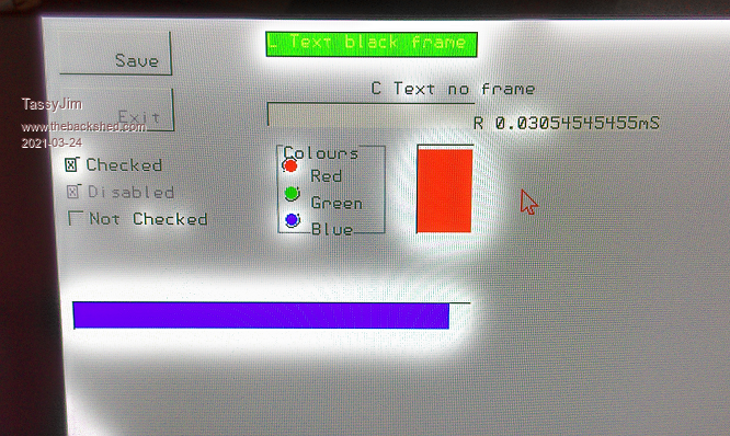

A wet day in Tasmania today so I thought I would have a play.
I am interested in how portable code can be and this is a good example of 'very portable'
To run it on a CMM2, I had to include the MOUSE and CURSOR initialisation and change the TOUCH(X|Y) to a function that reads the mouse
Simple enough.
The only other gotcha I have seen is GUI BITMAP
Not available on the CMM2 so I simply put a tick character in the box.
(Image has it as a cross)
The other obvious thing is the alignment of the text boxes. I haven't chased that one down yet.

  lizby said  Playing with the test program a little bit on an F4 with SSD1963_4_16, and I like it--very clean-looking.
The "dot" inside the button can be any colour you like.
Looking at the demo code, see the lines:
res=GUIObjDef(40,2,170,100,,,"Red",1,&hff0000)
res=GUIObjDef(41,2,170,120,,,"Green",1,&hff00)
res=GUIObjDef(42,2,170,140,,,"Blue",1,&hff)
last property is the hex for RRGGBB so if you want a black dot, use 0, if you want white use &hffffff or any combination for any colour you like.
Selected buttons are "depressed". perhaps could make the line a bit wider. I will play

Posted: 07:15am 24 Mar 2021
  CaptainBoing said
Actually, I think you have a good point. with a black dot, it is even less obvious.
will do some work on them... have a close look at what W95 did with them - I don't remember any confusion there so obvs they had the mix right
Edited 2021-03-24 17:21 by CaptainBoing

Changes made to run on CMM2
At the beginning:
 if mm.device$ = "Colour Maximite 2" then
   mp = mm.info(option mouse) ' mouse port
   cmm2 = 1
   option console serial
   GUI CURSOR ON 0, 100,100,rgb(red)
   CONTROLLER MOUSE OPEN mp
   mm.fontheight = MM.INFO(FONTHEIGHT)
   mm.fontwidth = MM.INFO(FONTWIDTH)
 endif
That gets the mouse underway and makes MM.FONTWIDTH etc available
Getting MM.FONTWIDTH working fixed all the alignment issues.
GUI BITMAP was easy enough to handle.
I put it into a SUB to make playing easier
sub gui_bitmap x as integer, y as integer, o as integer
 local integer dx,dy, dc
 local cbin$ = bin$(o,64)
 if cmm2 then
   GUI CURSOR hide
   for dy = 0 to 7
     for dx = 0 to 7
       dc = &hFFFFFF * (1 - val(mid$(cbin$,dy*8+dx+1,1)))
       pixel x+dx, y+7-dy ,dc
     next dx
   next dy
   gui cursor show
 else
   gui bitmap x+2, y+2, o
 endif
end sub
While the CMM2 doesn't have TOUCH(), as such, it is used as a proxy for MOUSE() so I had to get creative there also.
sub getTouch
 if cmm2 then
   ' GUI CURSOR MOUSE(x,0),MOUSE(y,0)  ' here or main loop
   Xt = -1
   if mouse(R,mp) then save image "gui.bmp",0,0,320,240
   if mouse(L,mp) then ' left button down
     Xt = mouse(X,mp)
     Yt = mouse(Y,mp)
   endif
 else
   Xt = touch(X)
   Yt = touch(Y)
 endif
end sub
The same change was done in the waitnotouch sub
 'waits for the stylus to be lifted off the panel
Sub WaitNoTouch
 if cmm2 then
     'Watchdog here if you want it
     Pause 10
   loop until mouse(L,mp) = 0
 else
   do
     pause 10
   Loop Until touch(X)=-1
 endif
End Sub
An interesting exercise that filled in the day for me.
