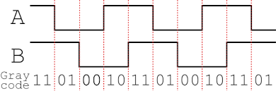

Do you want the MicroMite to send or to receive a single quadrature signal? My impression is you want the 'mite to SEND the signal, and you want the 'mite to read the joystick to determine exactly what to send.
A picture always helps: (from the web)
This shows us that the 2 pins outputting the signal have the repeating sequence of values 0,2,3,1
The PORT command is ideal to output this.
