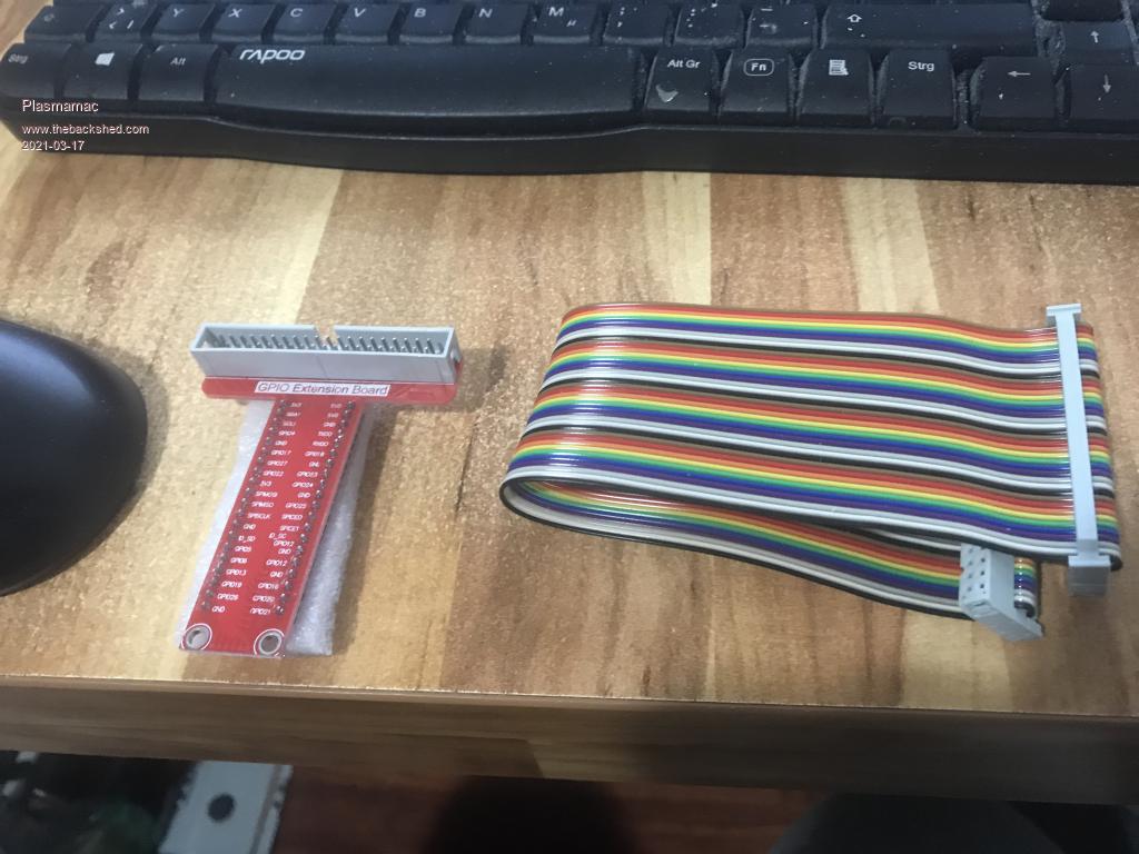

Same idea here   . I bought this
Plasma

A good thing to mention with these Raspberry PI GPIO backout is that they are exactly inverted as Keyed.  If you line up the key notches on the cables with the male headers everything is flipped as far as the labels on the adapter goes.

More important - many of the RPi breakouts have the ground and 5V etc lines tied together. If you plug it in the wrong way, the CMM2 will not be happy.
Its relatively simple to reverse one of the IDE connectors or modify your CMM2 socket to allow it to plug in the other way around.

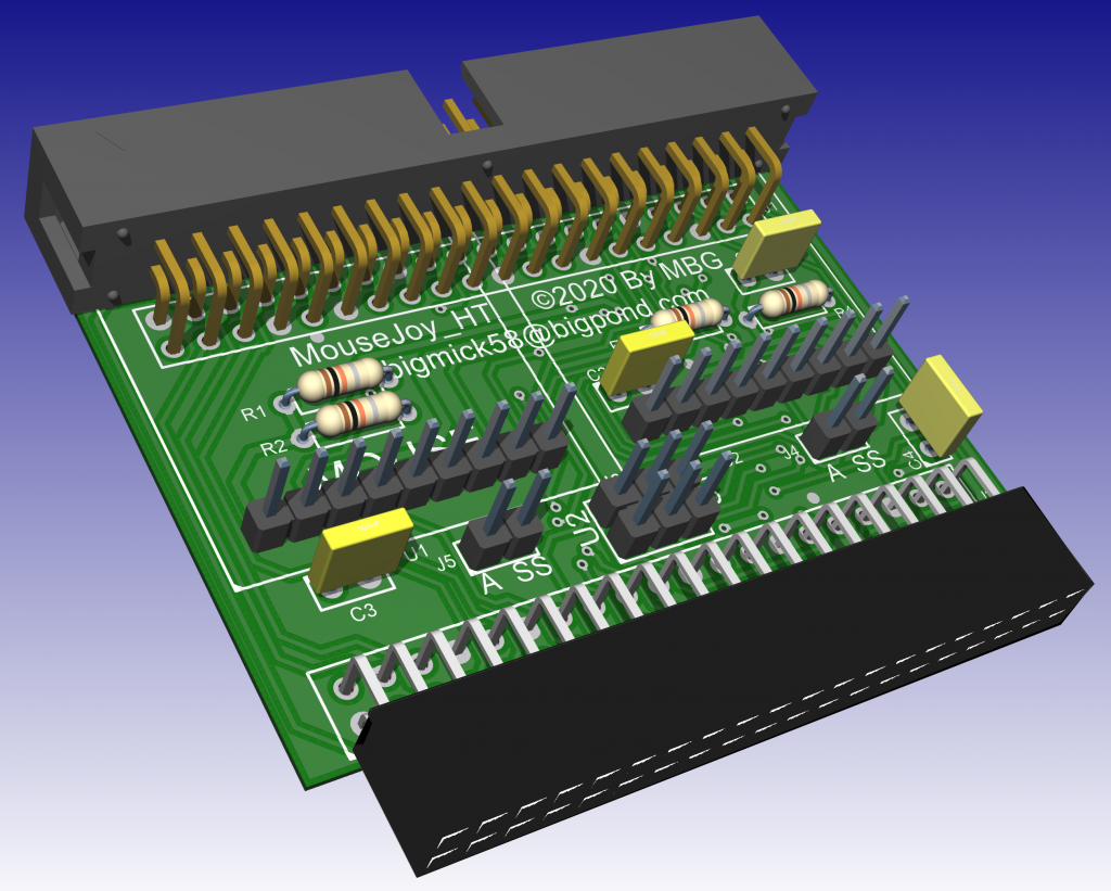

Hi Nimue,
How far do you need to extend the GPIO bus?
My PCB that accommodates 2 x HobbyTronics USB Host Modules (for USB mouse/Joystick etc) would allow approx a 50mm extension (without the HT modules)
Here is a picture without the HT modules installed.. You wont need the other components just the Male and Female R/A headers to be a plain old extender.
