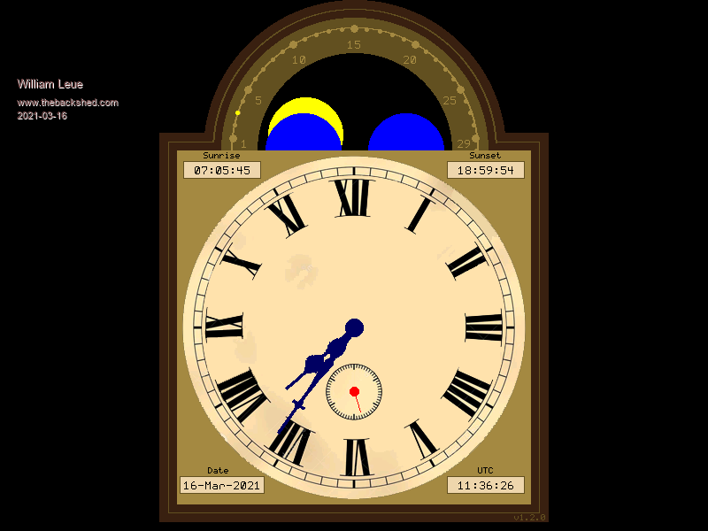

Attached is the latest version of my Grandfather Clock program.
Changes from the previous version:
1. Changed the moon dial so that full moon is better positioned.
2. Added a small dot on the moon phase dial to show the current day of the 29.5 day moon cycle.
3. Replaced the Zodiac sign in the lower left window with the current date.
4. Added an elevation correction to the sunrise and sunset times. (This will only change those times by a second or so unless you live on top of a very tall mountain!)
5. Added the program version to the bottom right of the clock frame in very small text.
I did a lot of testing entering various cities all over the world to make sure the main time was right and the sunrise and sunset times were accurate to a minute or so. The sunrise and sunset times are not compensated for atmospheric refraction, and you will probably find my times differ from what is published in newspapers, TV, and on the web by a few minutes. (Published times from different sources often disagree with each other by up to 2 minutes)
If you find your clock to be off by a full hour, it means your UTC offset time was entered incorrectly. Note that if your location uses daylight savings time, you need to change the UTC offset accordingly.
If the sunrise and sunset times are weird, check to make sure your longitude entry is correct.
Enjoy!

Oops! I accidentally published the version with the screen capture!
Here is the correct version. Sorry about that!
-Bill

And yes, I'm an American moron: the ELEVATION constant is implicitly measured in feet instead of meters and I forgot to mention it!
If you know your site's elevation in meters, just multiply that value by 3.28084.
*sigh*
