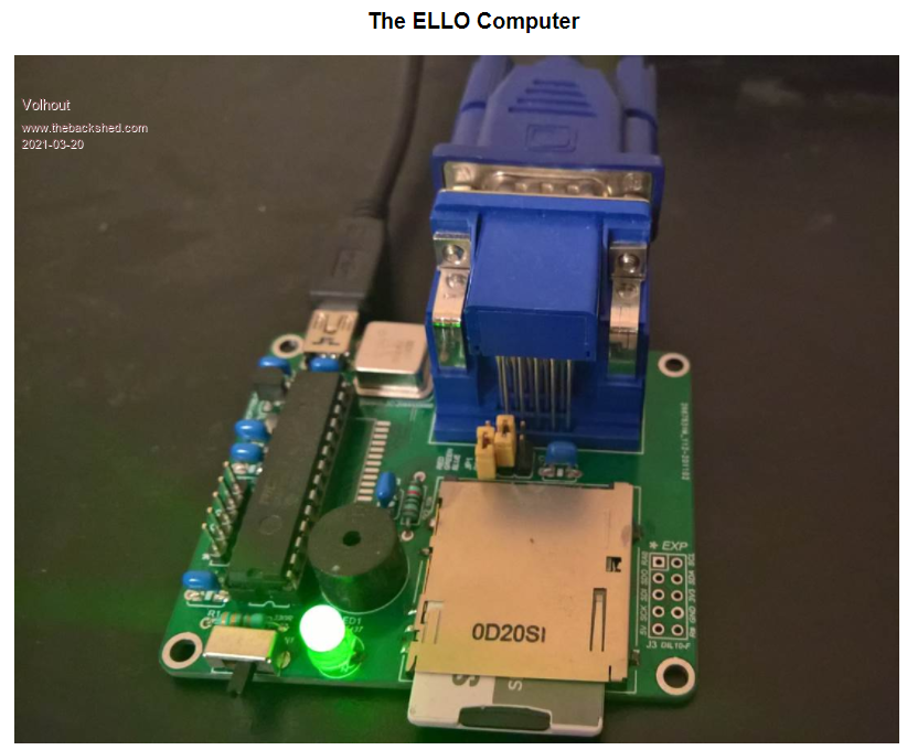

Hi knivd,
Nice project. I am impressed you achieved this with only 25 components.
But looking at the schematics I found through your link I am not sure if your hardware can deliver what the schematics promise.
The LED (+ 330ohm resistor) load on the SCKL signal may work OK, but the I2C bus (SCL signal loaded with 10uF and the buzzer) will definitely have reliability problems.
Typically 47pF (400kHz) or 200pF (100kHz) are the maximum allowable bus loads.
It may be a good idea to put a jumper there, in case you use I2C, you loose the buzzer.

The I2C bus has never been a priority. I think it will be pretty much either one or the other.
I ran a very small test on the I2C just generating clock (which is the line in question) and it went on fine at the typical I2C frequency which is way above the one of the speaker. The speaker also works just fine at its own frequencies (extensively tested).
But again, the I2C is a secondary feature which may need some further adjustments in time. I think the suggestion about a jumper is quite good.

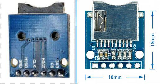

When I ordered parts, I neglected to order the SD card module. I have a number of these micro SD modules:
Would that be relatively easy to fit instead, perhaps using the J3 connector, which has MISO, MOSI, and CLK?

It's the right thread. I neglected to order the SD module, labeled 0D20SI on your photo. I'm wondering if I can expand the 2x5 header socket next to it (adding CS) to use the micro SD module I posted the photo of (which I've successfully used in several other circumstances).

You can connect an SD card to the expansion pins on J3 and use RA0 instead of RA1 (which is the default in the schematic). Then you should be able to use the SD card as SD2: device. The software won't switch to it automatically if there is a card in the slot, as it does with SD1, but at least you would be able to operate an SD card.
I don't have a module like yours with me here to test right now; if there are issues please let me know. Thanks
Posted: 06:26pm 19 Mar 2021
  knivd said  You can connect an SD card to the expansion pins on J3 and use RA0 instead of RA1 (which is the default in the schematic).
Thanks. If I get far enough to use the SD card, I'll try that.

One thing I forgot to mention earlier - when you use RA0 for SD2, you will need to add an external pullup resistor to the port.
You switch to SD2: with command ./cd sd2: (or ./chdir sd2:)

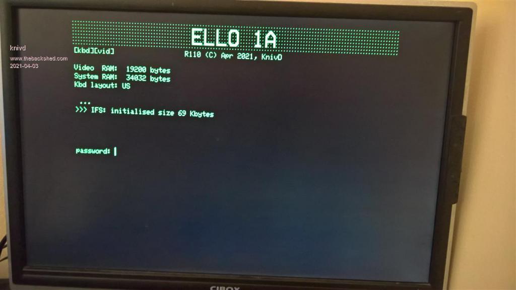

Frank N. Furter
Joined: 28/05/2012
Posts: 1186
Posted: 06:47pm 31 Mar 2021
Hi,
just finished assembling the board and it works very nicely. How can I change the keyboard layout permanently?
Are there any demo programs for this?
Thank you for the beautiful project!

Thanks for your fast response!
Your demos work very nicely! I will have to get used to the editor first...
:)Frank
