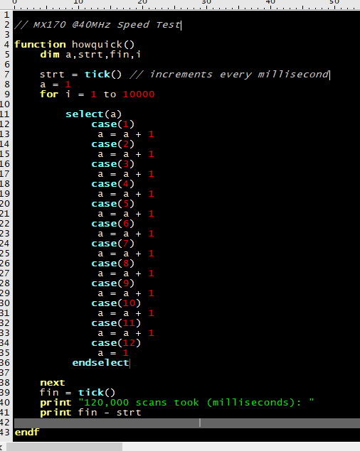

For when MMBasic won't cut it:

The code as written appears to only ever action case 12

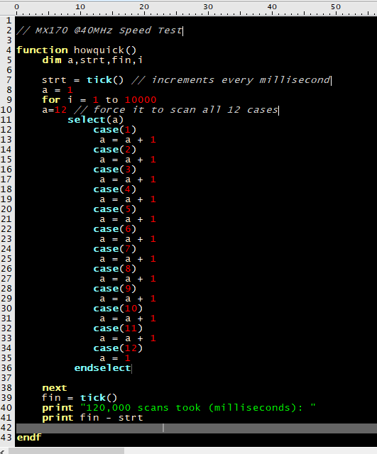

  matherp said  The code as written appears to only ever action case 12
If you see the REM, I force it to scan all 12 cases. If I let it action all cases, it's about 2ms quicker:
But now it's not 120,000 scans, obviously.
Edited 2021-03-08 01:33 by Tinine

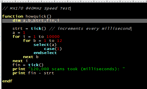

Still not convinced. Every basic normally executes just one CASE and has an implied break.
The first version does 10000 loops of one case and the second seems to do the same given that it executes at the same speed
What happens if you put a second loop?
for i=1 to 10000
for a=1 to 12
select.....
next a
next i

Posted: 04:01pm 07 Mar 2021
In the first example, it's all scanning and no variable incrementing. In the second example, it's less scanning but a variable is being incremented.

Posted: 04:13pm 07 Mar 2021
Paid a penalty for the extra for/next. The inline code is very fast but any sort of a loop incurs a time penalty.
