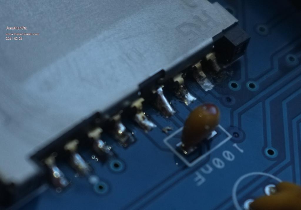

ok - on a much closer look, I wonder if I knackered a contact
if it is that can I do anything to fix it?
Contact most right on the image?
Jonathan

Posted: 03:11pm 27 Feb 2021
No connection to that pin so no issue. The pin next to it looks dry though.
Check the very small pins on the side of the socket. Make sure these aren't shorted to the case.
"Check disk" means that the firmware isn't seeing the SDcard so you need to find and fix the connections

So, I accidentally knocked the SD card off of my Retromax CMM2, uh... several times while testing my case, so I have a little experience here. Note that the Retromax uses a micro SD card, so it's a little bit different but:
Find a reference for SD card connectors. I used this as a reference for Micro SD when I was trying to figure out what I did wrong, but I believe it covers both: https://www.mouser.com/catalog/specsheets/an10911.pdf
Also, I agree with what matherp said -- looks like a dry pin there. If you're testing continuity with a multimeter, make sure you're testing from the top of the pin/solder to some end point of the trace. I actually thought I was doing this but the pins were so tiny that I was actually touching the pad under the pin instead of the solder/pin on top.
Also, for the micro SD card, the actual pads are connected to ground and these are used to determine when the card is inserted. In the micro SD connectors I have, the insertion pushes an internal pin into the side of the case which completes the connection. This means that even if you have all of the pins connected, you may still need to have the case connected to ground for the card to be detected.
I don't know if non-micro SD card connectors use the case for ground, nor do I know if all micro SD card connectors use that same mechanism since in my searches I found quite a number of micro SD card connector variations that seemed to have different latching mechanisms.
Those were the two main problems I had.

After several cycles of replacing mine I had delaminated the pads on my board. I made several attempts at replacing the pads using specialized high-temperature epoxy made for PCBs, but they would just delaminate again when I added heat, even after extensive cleaning of the pad sites and with the temperature as low as I could have it and still melt solder. Ultimately I ended up using a patch wire from the case to ground as well as hot glue to secure the card connector. In the process of all of this I also messed up one of the traces, but I fixed that with some very small wire (extracted from 22 gauge braided wire) soldered into the trace.
There are lots of great videos on YouTube showing how to do trace repair. It's not too hard as long as you have some magnification, tweezers and some patience. I'm lacking in the patience part.
