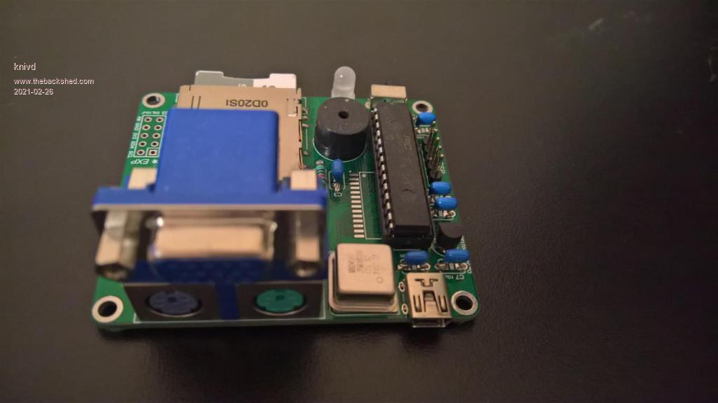

Here is a project I've been fiddling with for the past few months.
It is inspired by the early MM but runs C :)
http://ello.cc
Rado

Here is the PS/2 too
Posted: 10:27am 26 Feb 2021
Very neat
Couple of minor issues on the schematic. You are being a bit unkind on any VGA monitor by not clamping the RGB outputs to 0.7V. Also, dual mode USB/PS2 keyboards and mice seem to set their mode based on the presence or absence of pullups on the clock and data lines. Whereas PS2 only devices will work with the schematic as drawn we have found on the CMM2 that 4K7 pullups are essential for dual mode mice to work in PS2 mode and I assume the issue will be the same for dual mode keyboards

  matherp said  Very neat
Thanks!
Yes, I am aware of those things. My goal was to build the absolute barebone system, making some assumptions on the way, of course. Using the internal pullups. I have tested with a few keyboards and monitors that I have and they all worked. Surely there might be some others that won't be happy, but it is a trade off for simplicity. Support for mouse I think is a bit pointless in a 64K mono machine.
PS. I have some leftover boards from the previous revision. For free, I will only want the P&P. Always feeling bad if I need to throw away perfectly good PCBs.
The only difference between the previous version and the current release is that it uses MCP1700-3302 which is a lower current LDO than the one in the current board.
Edited 2021-02-26 22:38 by knivd

  matherp said   . . . You are being a bit unkind on any VGA monitor by not clamping the RGB outputs to 0.7V.
What additional circuitry would be required to achieve the suggested protection?
Posted: 06:17pm 26 Feb 2021
  Quote  What additional circuitry would be required to achieve the suggested protection?
Inline resistor into a diode - see the CMM1 circuit on Geoff's site
Yes, that would be the correct one. I even had it in the earliest board, but then discovered that the three monitors I have for testing all have their own internal protection and apparently that is a common thing, so the schematic became two components lighter. It is of course very easy to add them back but it would be mostly to deal with some corner cases.
