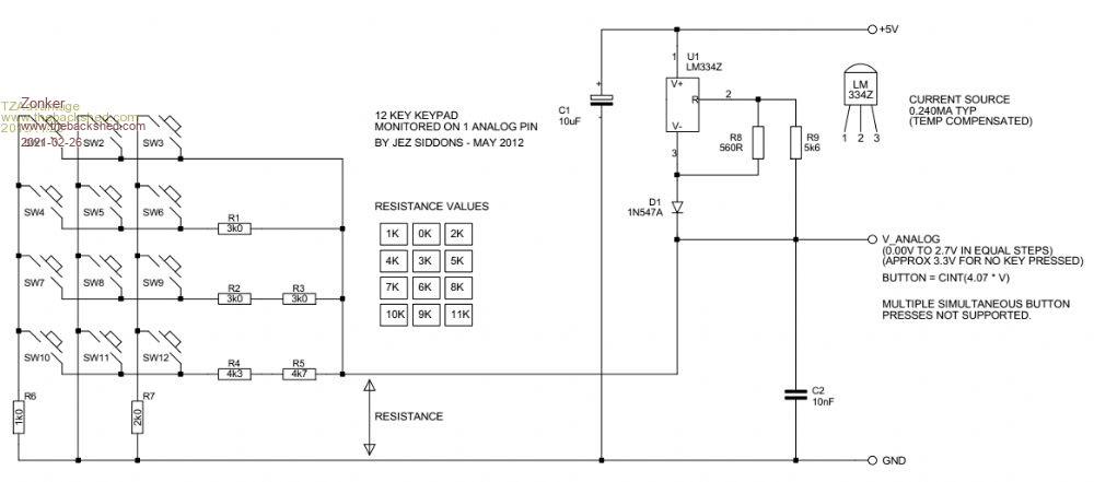

I remember seeing this from TZadvantage a while back... Nice circuit...
Posted: 02:12am 26 Feb 2021
this is a similar version:
https://www.thebackshed.com/forum/ViewTopic.php?TID=6418
rob   :-)

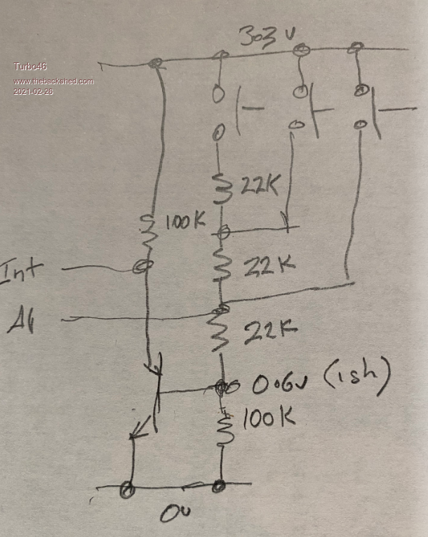

If you can use two pins then something like this could work. Please excuse the rough drawing.
