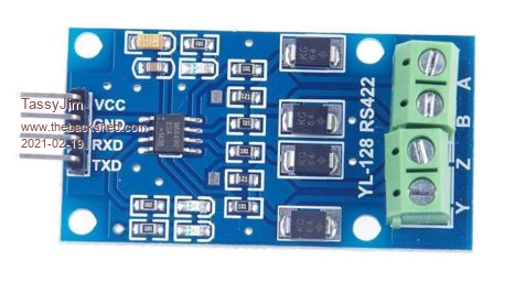

Posted: 08:13pm 18 Feb 2021
I agree with Peter.
If you only have 2 cores available for data, RS485 but I like RS422 for full duplex without any need for the extra control lines.
