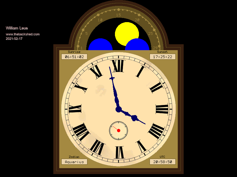

As a part of my series of different clocks, I present my new Grandfather Clock, as shown in the image below.
This clock, when configured for your location, displays the times of Sunrise, Sunset, the current Moon phase, the current Sign of the Zodiac, and the current UTC time.
To configure the clock, you only need set the values of 3 constants at the top of the program: LATITUDE, LONGITUDE, and UTC_OFFSET. When you start the program without first configuring it, a screen will appear that gives detailed instructions on how to configure it.

Here is an upgrade to version 1.1.0 of the Grandfather Clock. There was a bug in the moon phase to moon angle conversion. This one now works correctly. I have tested it for New Moon, Quarter Moon, Full Moon, and 3/4 Moon dates for several months and they all come out right.
My apologies for not adequately testing this before.
BTW, to avoid ugly display flashing and flickering, the moon phase and display is only updated at midnight; that is, once per day. This unfortunately means there is no hour increment to the moon position. So on the next full moon on February 27, you will note that the moon disk is not precisely centered between the two blue hemispheres, but inclined slightly to the right. This is in fact exactly correct, because at midnight the moon phase is 0.53, not 0.5. Unlike physical grandfather clocks, which approximate the true lunar month to about 29 days, my simulation uses the exact lunar month of 29.53 days.
