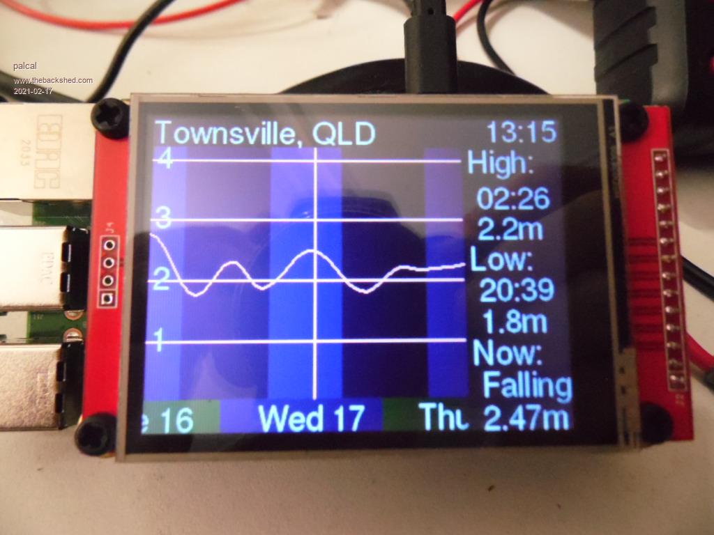

palcal
Joined: 12/10/2011
Posts: 2052
Posted: 12:40am 17 Feb 2021
Finally found out that Raspbian Stretch defaults to Python2 so I downloaded that.
I am finally getting somewhere the code runs and I have a UI on the screen.

palcal
Joined: 12/10/2011
Posts: 2052
Posted: 03:32am 17 Feb 2021
Well somehow I got it running, my only concern is that now it's headless the only way to turn it off is to cut the power, hope it doesn't corrupt the card.

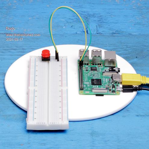

Posts: 4380
Posted: 07:56am 17 Feb 2021
You could arrange to shut it down cleanly in any of several ways, such as:
1. if it's on a (local) network, login over it and invoke shutdown
2. a small process which monitors an I/O then add a switch you flip to signal it should shut down
You could also arrange that it runs without the SD being write-enabled.
Rado
Joined: 27/11/2020
Location: Croatia
Posts: 59
Posted: 09:13am 17 Feb 2021
It's really simple:
https://www.quartoknows.com/page/raspberry-pi-shutdown-button
Edited 2021-02-17 19:14 by Rado
palcal
Joined: 12/10/2011
Posts: 2052
Posted: 08:49pm 17 Feb 2021
Thanks for the ideas. I'll try the Button and see how it goes.
