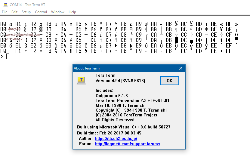

4.94

So an older version ... I've just installed that and still no such setting.
This is weird - can you post a screenshot of the dialog and the about box ?

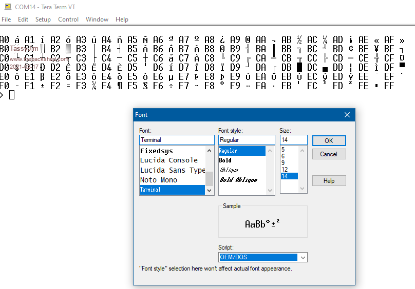

I did a few tests.
CP65001 and CP437 both display the same extended ASCII characters so no help for you there.
I use Terminal font. It can be difficult to find fonts that have the line drawing characters.
I suggest that you have some odd setting in your teraterm.ini file. Delete it and start fresh.

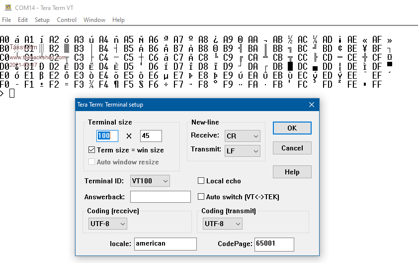

  Quote  I suggest that you have some odd setting in your teraterm.ini file. Delete it and start fresh.
That doesn't appear to be the case. To display the two "Coding" fields requires a change in Setup->General to use UTF-8 before they are displayed but I'm still to discover what setting needs flicking to show "CodePage".
I independently discovered that the key was using the "Terminal" font, but even that doesn't contain the full Cp437 set of line-drawing characters (it doesn't contain the junctions between double and single line borders).

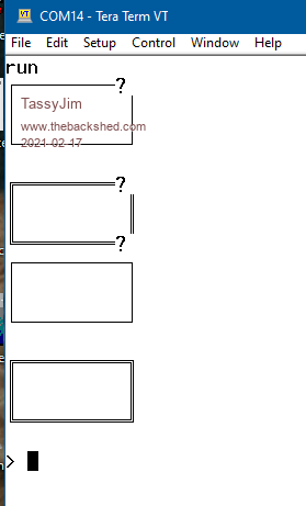

For me, with Terminal font set in Teraterm, both CP65001 and CP437 have the anomaly of not printing the upper right corner, single or double, or double lower right corner if preceded by the appropriate horizontal line character.
In MMBasic DOS, the code draws the boxes properly.

I believe it is happening because you have TeraTerm configured to receive UTF-8 and 0xC4BF just so happens to be a valid UTF-8 character so those two bytes are interpreted as a single character and it happens to be a character not present in the font you are using, so you get a ? When you insert the space you break the byte sequence and hence get the expected characters.
The same doesn't happen for all the horizontals because 0xC4C4 is not a valid UTF-8 character.
Or I might be adding 2 + 2 and getting 5.

Hummm, maybe. My ignorance is deep here. The only choice I can see for coding other then UTF-8 is something called UTF-8m. Selecting that makes no difference.
Where does 0xC4BF come from? I thought I was sending chr$(191) or 187 or 188.

  TassyJim said  I don't think that is the problem though.
In TeraTerm:
1. Go to [Setup->General...]
2. Change "Language" from "UTF-8" to "English"
3. Re run program
4. Question marks go away and boxes are displayed correctly
5. Think, "Huh, I guess Tom's theory may have been correct, what are the chances of that happening?"
Or it may just be coincidence
Have a nice day.
Edited 2021-02-17 20:02 by thwill
