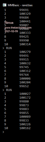

MMBasic (windows) I get:
Using this code:
Dim counts(100)
For x = 1 To 1000000
   value=Int((Rnd()*10)+1)
   Select Case value
       Case value
           counts(value)=counts(value)+1
Next
For x = 1 To 10
   Print x,counts(x)
Next
This seems as expected.....

Just realised this is overly complex:
Dim counts(100)
Next
For x = 1 To 10
   Print x,counts(x)
Next
