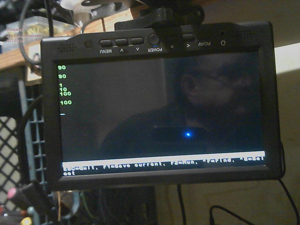

After I type in :
10 (enter)
through
100 (enter)
(step 10)
I get :
Edited 2021-02-08 10:04 by hitsware2
my site
Posts: 11891
Posted: 08:21am 08 Feb 2021
What resolution are you running? The issue is that with the very large font the status line is too long and is wrapping
UPDATE
Fixed in b12
Edited 2021-02-09 02:20 by matherp

Posted: 05:30pm 08 Feb 2021
800 x 600
The monitor adjusts itself ( if I understand it )
If I use MODE to change resolutions ( the monitor does follow )
when I do FILES or EDIT it switches back to 800 x 600 .....
my site
Posts: 11891
Posted: 05:58pm 08 Feb 2021
UPDATE
Fixed in b12
hitsware2
